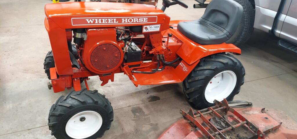

TonyBer 82 #1 Posted November 18, 2021 (edited) Just picked up a nice C160 and a few things going on prompting a seat replacement. I have a hip issue that limits my flexibility and on my other 8Hp the seat sits slightly higher (foldable with armrests) and makes a huge difference in comfort me. The C160 seat is 1 piece (no arm rests or folding) and I'm looking to get something slightly higher and a lot more comfortable with arm rests. I've seen some mention Northern Tool / Michigan Seat, and wondering what is the best upgrade option? Is anything plug and play or do I need to do some drilling. Should I add springs? Thanks!! Edited November 18, 2021 by TonyBer 4 1 Share this post Link to post Share on other sites
roadapples 6,987 #2 Posted November 18, 2021 (edited) I would definitely add the springs. Just put that same seat on my 520 and like it... That is not the original seat for a C160. Springs would add about 2 inches in height Edited November 18, 2021 by roadapples 3 Share this post Link to post Share on other sites
TonyBer 82 #3 Posted November 18, 2021 (edited) 21 minutes ago, roadapples said: I would definitely add the springs. Just put that same seat on my 520 and like it... That is not the original seat for a C160. Springs would add about 2 inches in height Thanks..I fixed the "original" part. Standard springs...like all over Ebay? Edited November 18, 2021 by TonyBer Share this post Link to post Share on other sites
roadapples 6,987 #4 Posted November 18, 2021 Yeah, I think most wheel horse springs are alike and most seats will fit. The 520 with the adjustment is different. The seat I just put on like yours I had to drill new holes in the rear and install nutserts . That seat has a metal pan so armrests wouldn't be that hard to add. Put an add in our classifieds want adds. Someone on here may have a set of springs. Although the last set I bought off of eBay, I gave $15 for... 2 Share this post Link to post Share on other sites

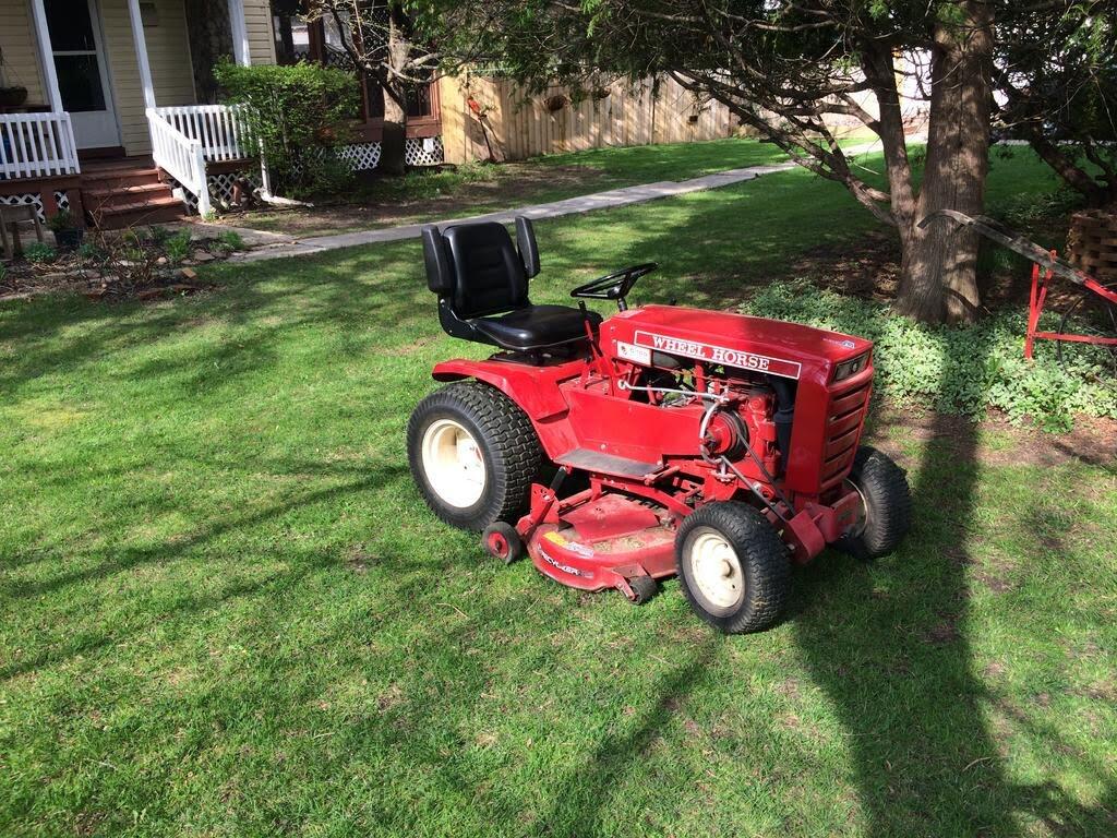

squonk 48,072 #8 Posted November 18, 2021 I've had this seat on my C-160 for over 12 years. I love it. Added springs and it's adjustable. https://www.northerntool.com/shop/tools/product_200395377_200395377 4 Share this post Link to post Share on other sites

squonk 48,072 #12 Posted November 18, 2021 1 hour ago, TonyBer said: Thank you...was looking that model previously and seeing on your tractor I think seals the deal. I'm going to add springs and this seat. BTW...did you have to do any mods to attach? I don't remember but I think it was a bolt on. The only mod I did I think was thinning the bolt heads on the seat tracks so the would clear the slider. The adjustable seat goes quite a ways back. 2 Share this post Link to post Share on other sites
