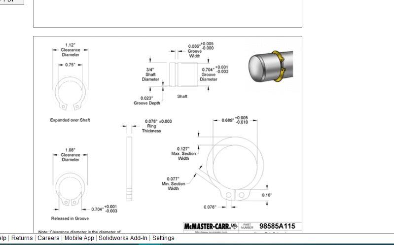

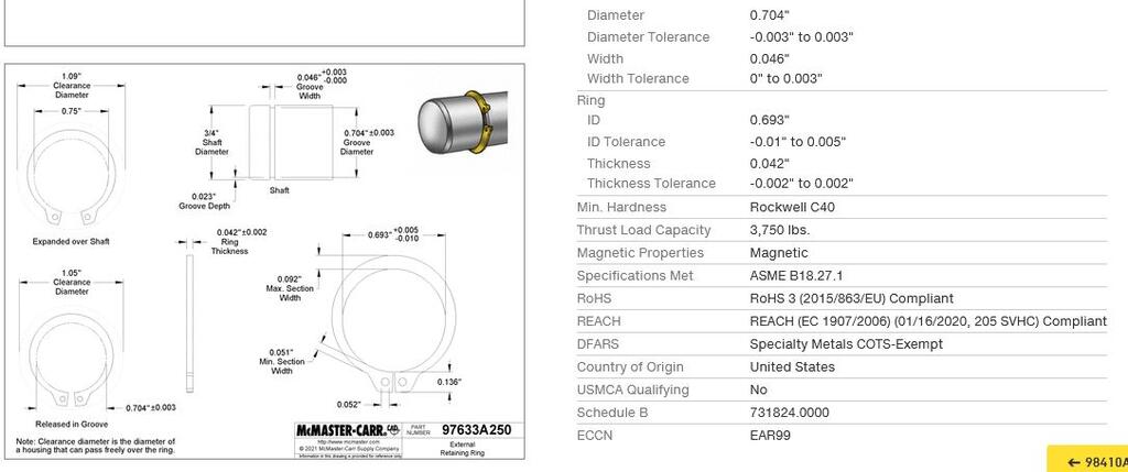

pfrederi 21,145 #4 Posted November 17, 2021 WH couldn't decide how to keep wheels on. They used Cotter pins, E-Clips. External snap rings and bolts. Snap rings are 3/4 inch...but there are regular and heavy duty different thicknesses. 4 Share this post Link to post Share on other sites
pfrederi 21,145 #5 Posted November 17, 2021 Regular vs heavy...Measure your groove 3 2 Share this post Link to post Share on other sites
Achto 32,634 #6 Posted November 17, 2021 It depends on how they size the ring. If a 3/4" snap ring has a 3/4" ID it will not hold in the groove. 3/4" shaft with a 1/16" deep groove would require a 5/8" ID snap ring. I've run into this size issue with my snap ring assortment kit. 4 Share this post Link to post Share on other sites

pfrederi 21,145 #9 Posted November 17, 2021 Looking in a couple of parts listings WH calls the external snap ring 104822 "special heavy duty snap ring" I would imagine you need the Heavy one I showed above...probably not to be found in the small bins at the big box stores... Share this post Link to post Share on other sites
Tonyp 285 #10 Posted November 17, 2021 (edited) THX..I ordered a 10 pack from Macmaster Car # 98585a115 - Found this on another RED SQUARE thread. 3/4 heavy duty - $15 with shipping, thats $1.50 each. Buying 1 or 2 from other locations is over $10. Thank you all tp Edited November 18, 2021 by Tonyp 2 Share this post Link to post Share on other sites
Tonyp 285 #11 Posted November 18, 2021 (edited) A std 3/4" snap ring does do the job, but I suspect NOT LONG TERM. Too much slop in the groove. Thats what I am using right now, but as stated above I have heavy duty rings on order. from Macmaster Carr. I wish WH would have just drilled a hole and used a Cotter Pin ! OLD SCHOOL - A Finishing Nail would have done the job ! Thx all for the replies. best tp Edited November 18, 2021 by Tonyp Share this post Link to post Share on other sites
