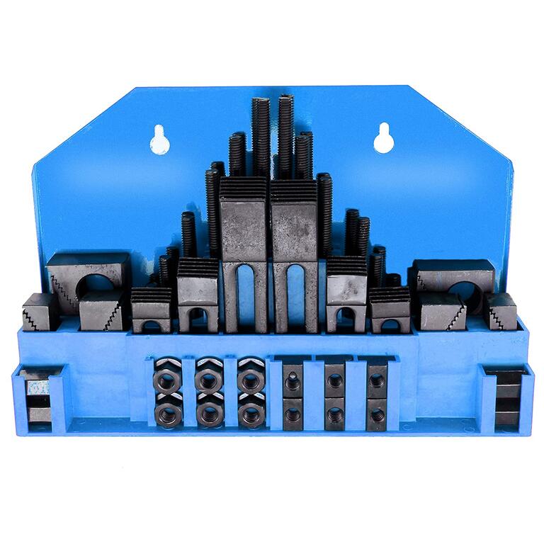

lynnmor 9,037 #10 Posted November 16, 2021 I punched out the small bearing first by using a punch on the center since it was going to be replaced anyway. The notches can then be used to punch out the roller bearing, mine was not hard to move. To install the bearings, I used a stud, washers and clamps from a milling machine set like this: I had washers and spacers to draw the bearings in to the final position. 1 Share this post Link to post Share on other sites
