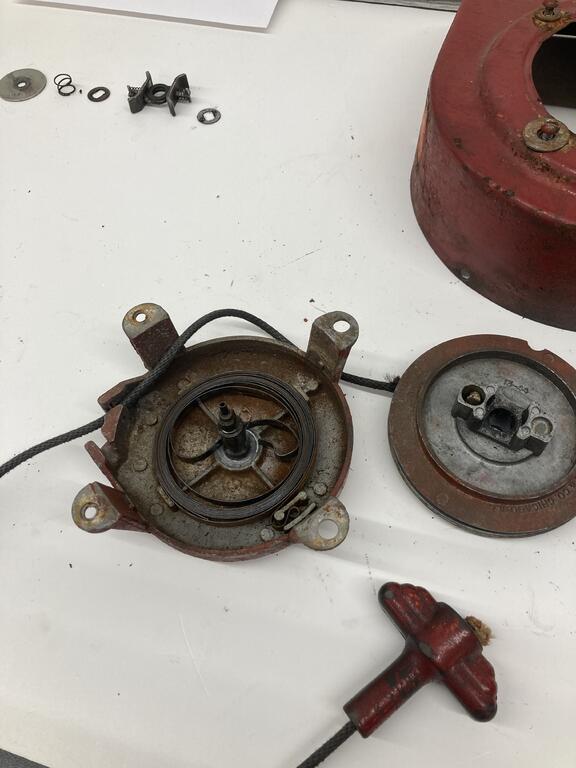

Frankenstein 58 213 #1 Posted November 15, 2021 What is everyone using for a replacement spring for the Fairbanks Morse recoil. I’m sure the part 20-61 is obsolete. I’ve searched but haven’t had to much luck. Thanks Share this post Link to post Share on other sites
Achto 32,109 #2 Posted November 16, 2021 1 hour ago, Frankenstein 58 said: What is everyone using for a replacement spring for the Fairbanks Morse recoil. If you just broke the catch loop off the end of the spring, I have re-bent a new catch loop and reused the old spring. 2 Share this post Link to post Share on other sites
Frankenstein 58 213 #3 Posted November 16, 2021 I have done that also but on a newer spring. That spring is what 60 + years old lol. If all else fails in finding a suitable replacement I will try that again. Thanks. 1 Share this post Link to post Share on other sites
