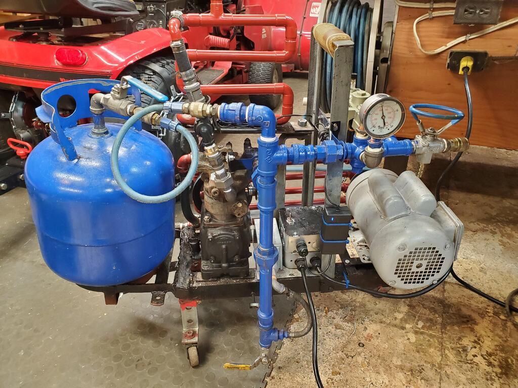

R Scheer 525 #28 Posted November 13, 2021 The chamber above the cylinder may be for the water cooling. If you look at the picture below you can see the solar pump etc connected to the top of the compressor, and the red elbow at the front of the compressor. I'm using about 15' of pipe for cooling, and as a belt guard. I went this way as I do woodworking in the shop as well and I didn't want to have a heater core getting filled with sawdust. With this the pipe will get about 40F above ambient. It ain't pretty but it works. It needs a second blow off valve on the tank, there should be one on either side of the ball valve. 1 1 Share this post Link to post Share on other sites

R Scheer 525 #31 Posted November 13, 2021 I guess my first thing would be to check the required cfm of your concrete air hammer. Then maybe look for used service truck air compressors. If the compressor you have works, could you plumb in a 12vdc oil gear pump? Something that provides 40 psi, uses a drain from the oil sump and send to the inlet if you can open the connections. I saw one on ebay for app $100. Maybe ghere's one available used on the internet. Just thoughts. 2 Share this post Link to post Share on other sites

R Scheer 525 #41 Posted November 17, 2021 Just wondering if you have tried the air compressor, maybe by just temporarily running a belt from your tractor to the compressor. Only concern I'd have is that if it's supposed to have pressurized lubrication, and its been run as a splash lube, did the crankshaft bearings etc get lubricated properly? Might be worth a quick test before putting money/time into it. I do like my air brake compressor, it's very quiet when running, and it's only 100 years old so it'll probably outlast me. Family history is that it's off a 1920 White truck. 1 4 Share this post Link to post Share on other sites

Maxwell-8 4,371 #49 Posted November 18, 2021 On 11/17/2021 at 2:43 AM, Lee1977 said: need a tank unless you are using more air then the pump can produce I think the pump will be more then capable, would be nice if we are doing some work when not much compressed air is needed to be able to shut off the tractor and work in silence for a while. But thanks for your input! 11 hours ago, R Scheer said: Just wondering if you have tried the air compressor, maybe by just temporarily running a belt from your tractor to the compressor. Only concern I'd have is that if it's supposed to have pressurized lubrication, and its been run as a splash lube, did the crankshaft bearings etc get lubricated properly? Might be worth a quick test before putting money/time into it. I do like my air brake compressor, it's very quiet when running, and it's only 100 years old so it'll probably outlast me. Family history is that it's off a 1920 White truck. Good point, You suggest taking of the bearingcaps, to inspect the bearings? Oil was up there, so everything is still running smooth. It was mounted for a while on a regular compressor being ran by an electric engine at 2350 rpm, with the engine pulley being 2 inches. SO that was seriously underdriving the compressor @ 400rpm still making suficient amounts of air The compressor itself is made to run diesel-engine rpm (+3000) The compressor will be turning 980 rpm on the tractor with the way things are planned now. 2 Share this post Link to post Share on other sites
R Scheer 525 #50 Posted November 19, 2021 I was thinking of just checking functionality, does it pump, any odd noises, does the unloader work etc. It sounds like you've already done this. I wouldn't take things apart without a reason, I hate fixing things until they break. 2 Share this post Link to post Share on other sites
