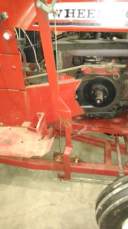

rmaynard 16,910 #1 Posted November 12, 2021 I have a 416-H with a 48" snow blade. I also have a "Matt's" foot pedal conversion. The problem is that the angle adjustment arm has always conflicted with the foot pedal. Has anyone ever converted their angle adjustment to a linear actuator or hydraulic cylinder? Share this post Link to post Share on other sites

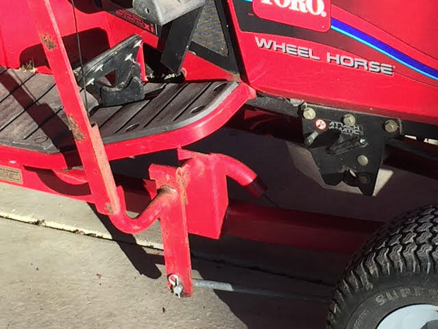

rmaynard 16,910 #14 Posted November 13, 2021 @wallfish I'm going to have to look at that possibility. Once I have it installed again, I will try to envision that kind of mod. I like the design of the lever for the XI series as pictured below. 1 Share this post Link to post Share on other sites

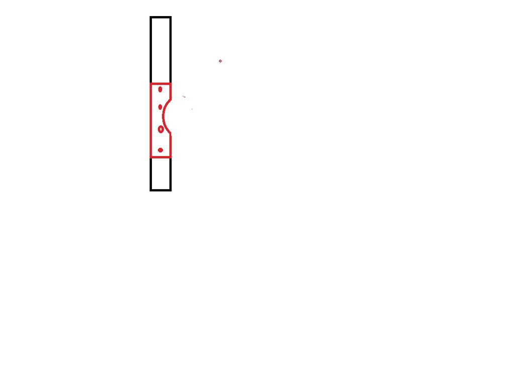

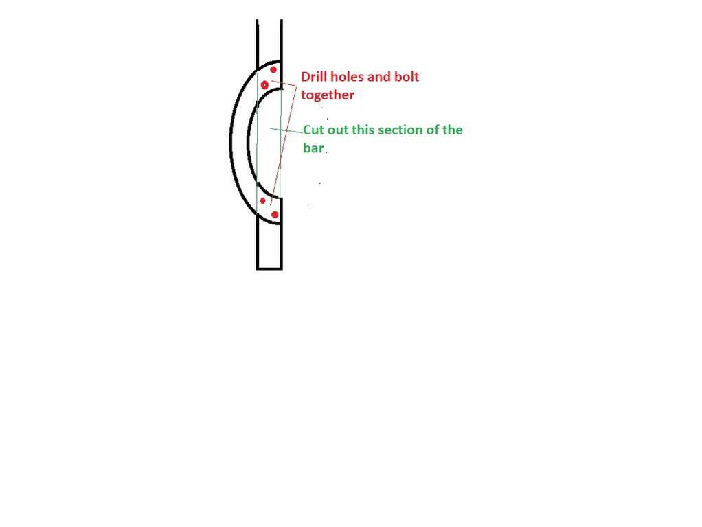

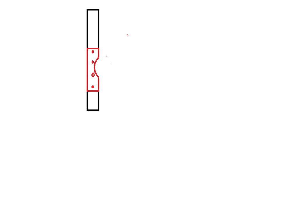

wallfish 19,400 #15 Posted November 13, 2021 That crude drawing is probably a bit dramatic size wise for the amount the handle needs to avoid the pedal but I could wrong. Or, if it's only a 1/2" - 3/4" or so of space needed, maybe just double up that section of the handle with another flat bar bolted to it and cut or grind out the needed space. The added piece of steel will support it. Just think'n out loud 2 Share this post Link to post Share on other sites
edgro 680 #16 Posted November 13, 2021 Here is what i did to solve the problem 1 1 Share this post Link to post Share on other sites
rmaynard 16,910 #17 Posted November 14, 2021 The other thing is that the bar hits the muffler when pushed forward. The modification above would solve that problem as well. 1 Share this post Link to post Share on other sites
ebinmaine 77,553 #18 Posted November 14, 2021 12 hours ago, edgro said: Here is what i did to solve the problem Nice work. I've had a plow on a B80, 1267-ish, and C160. Both of the B & C tractors of course have the separate brake pedal that the earlier model does not. The boots I wear to move snow are HUGE. I solved the above by moving the whole plow frame forward about 2" by reconfiguring the axle bracket. I could then leave my trailer hitch on year round as well. Share this post Link to post Share on other sites
