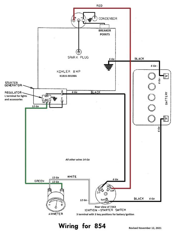

gwest_ca-(File Mod) 12,321 #52 Posted November 12, 2021 Moved the battery so the black wires don't cross each other. 2 1 Share this post Link to post Share on other sites

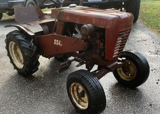

Crmaverick 91 #68 Posted November 14, 2021 Also here are some pictures of the 854. 2 1 Share this post Link to post Share on other sites

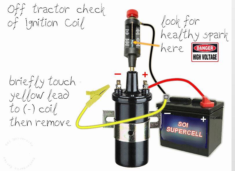

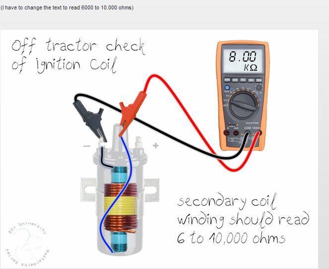

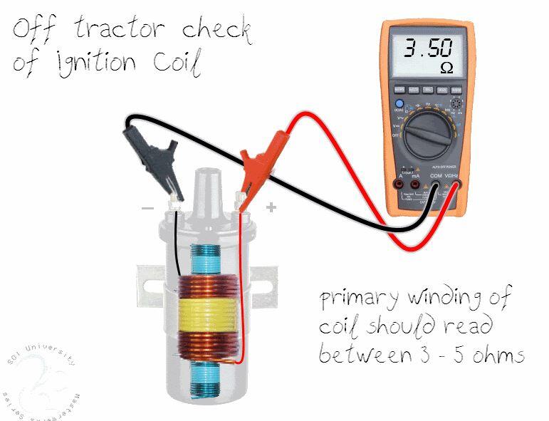

ebinmaine 79,504 #74 Posted November 14, 2021 44 minutes ago, Crmaverick said: That’s good to know where else can I look for a fault? I have verified my engine block ground is good to. Disconnect and then Check the coil as pictured above with your ohmmeter. Try filing the points with much finer paper. Share this post Link to post Share on other sites
