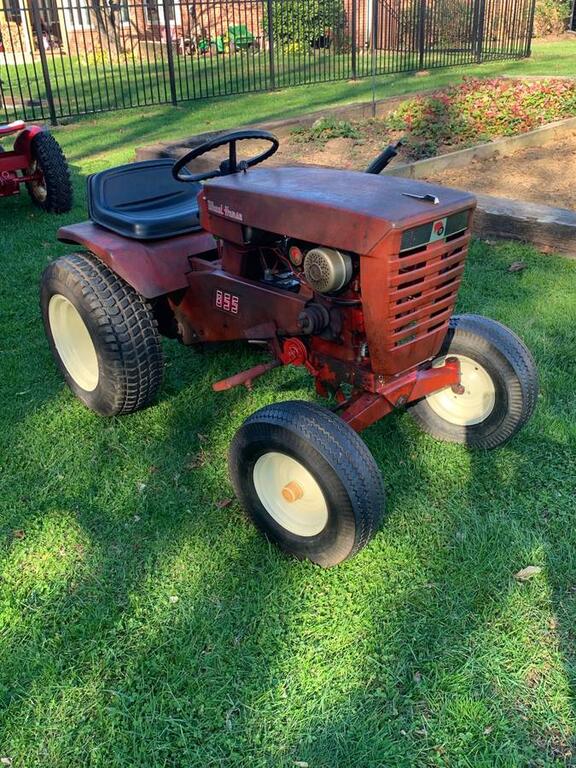

mikef18 44 #1 Posted November 9, 2021 Hi everyone, this is my first post here. I just got an 855 and was wondering if anyone has pictures of the inside of the belt guard and all the mounting points on the tractor? I'm missing some parts and see that some mounts are broke from the frame. Trying to figure out what I need to make and repair. Thanks 1 Share this post Link to post Share on other sites

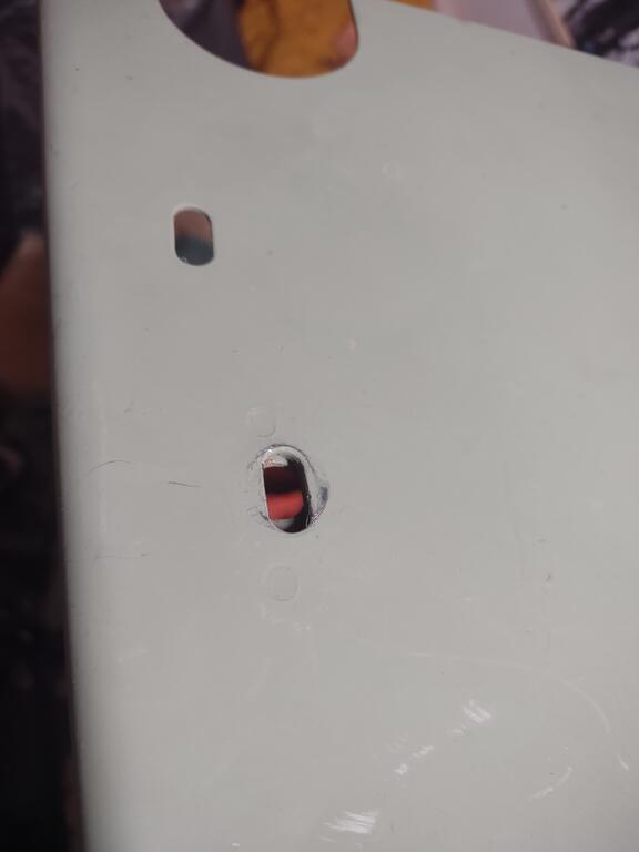

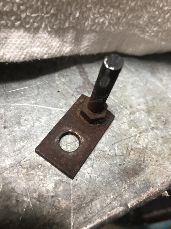

mikef18 44 #6 Posted November 10, 2021 Thanks for the replies, I'm missing the "s" bracket and the tab for the rear top bolt. So that leaves 2 oval holes at the lower rear of the guard, do they have a purpose? I found this bracket laying in the guard when I took it off, any idea what it's from. I did do a search to try and find all this info but difficult finding pics of the backside of the guard to see if anything was missing. Share this post Link to post Share on other sites

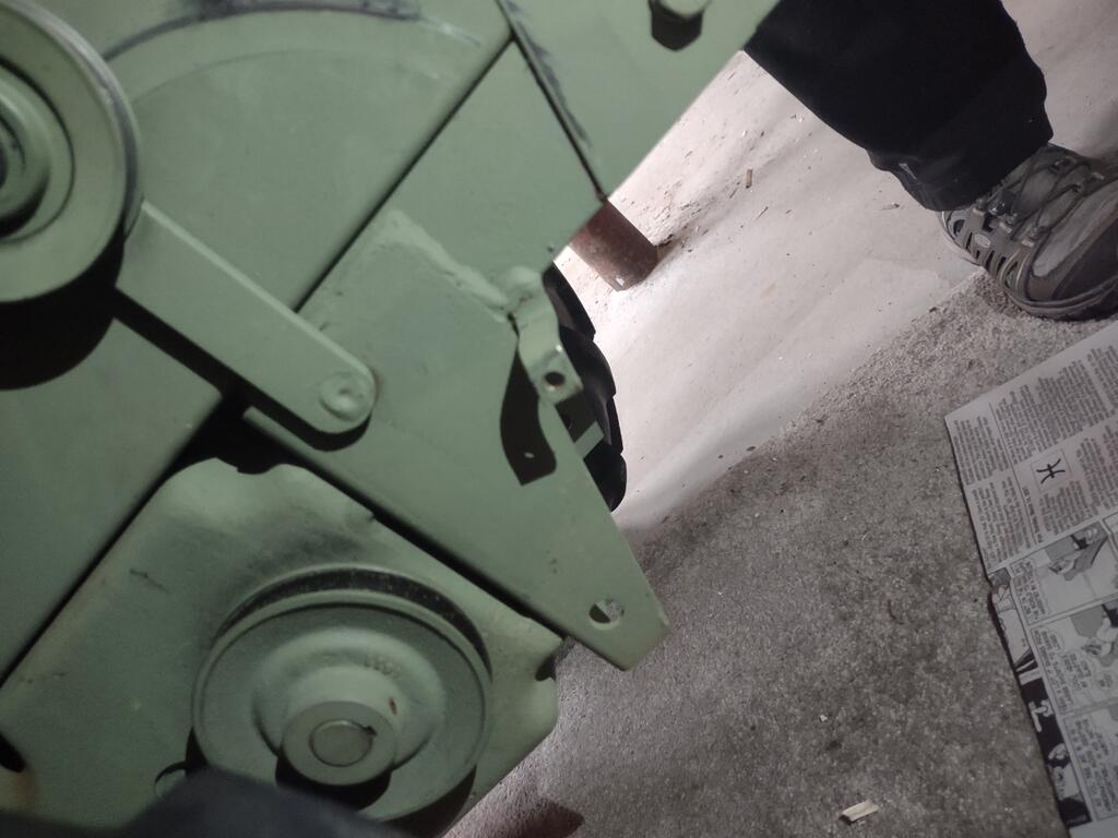

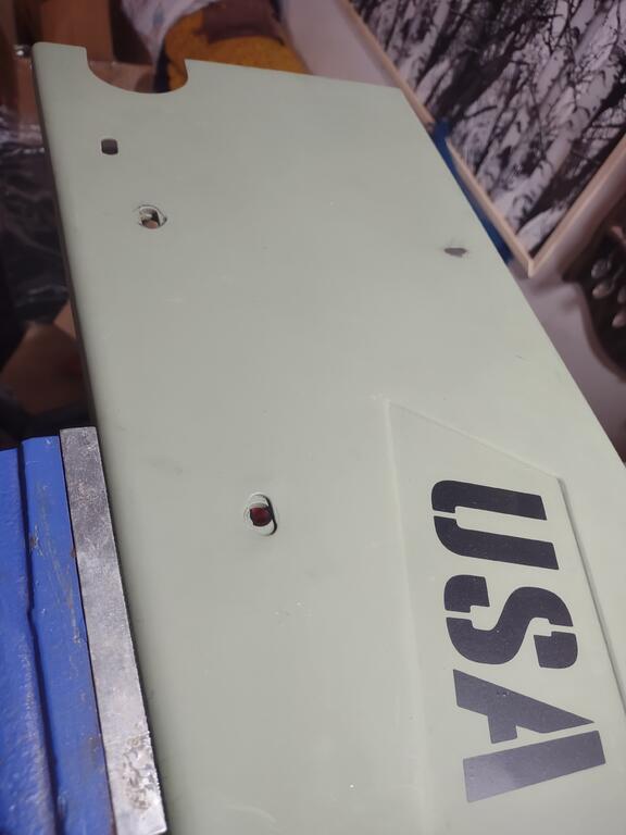

ebinmaine 80,641 #7 Posted November 10, 2021 8 minutes ago, mikef18 said: that leaves 2 oval holes at the lower rear of the guard, do they have a purpose? Here are some pics of Trina's Military Tractor belt guard. In the top pic note that the two rear oval holes can be seen. In the next pic note that only one of those two holes has usage. In the lower pic you can see the s-shaped bracket that is at the bottom of the frame. 1 1 Share this post Link to post Share on other sites
Achto 32,633 #8 Posted November 10, 2021 9 minutes ago, mikef18 said: So that leaves 2 oval holes at the lower rear of the guard, do they have a purpose? used the same guard on a few different models thus the extra holes. Use the one that lines up with your frame. The piece that you found looks similar to a part used for some mower decks. Similar but it would not work for said application. My guess is that it is a home made part for some thing, not sure what though. 1 Share this post Link to post Share on other sites
