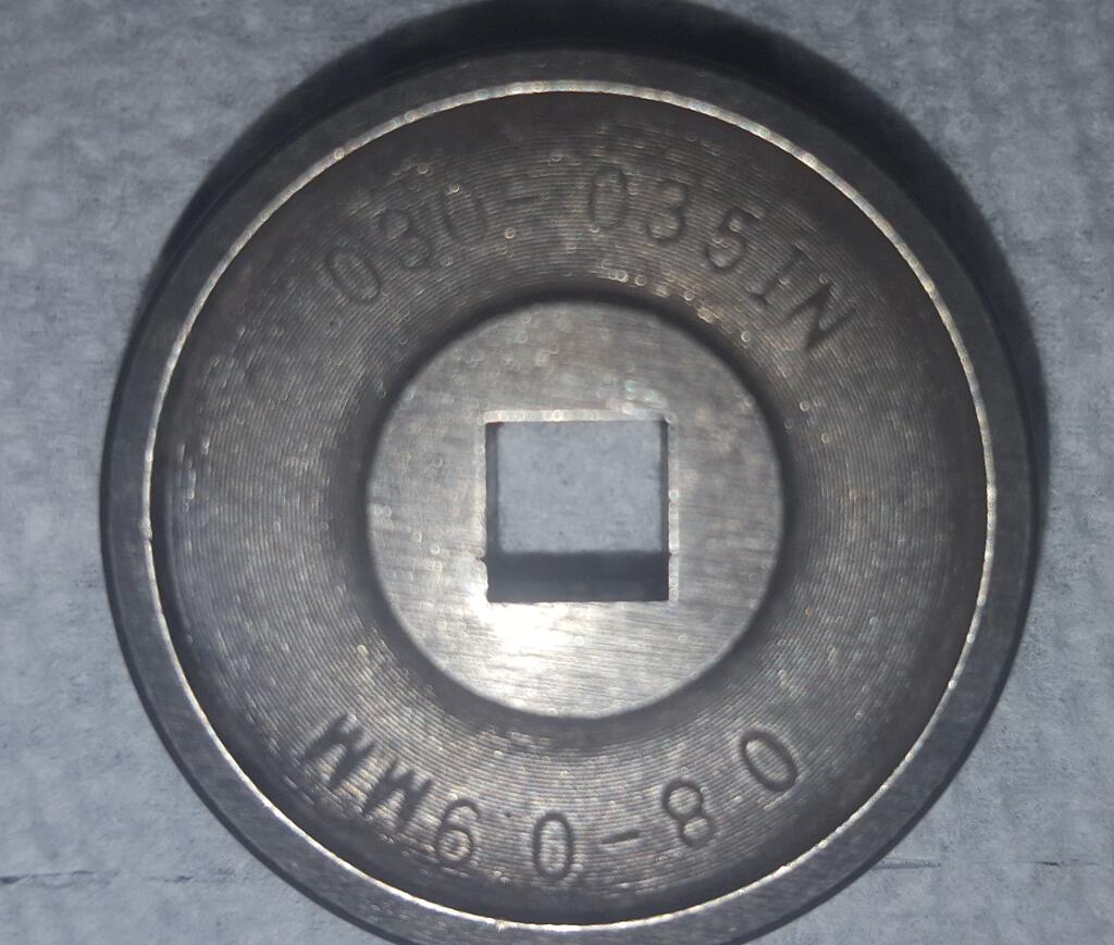

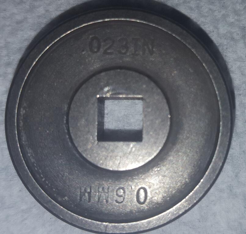

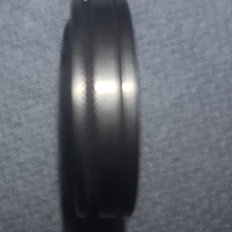

Gregor 4,848 #1 Posted November 9, 2021 I didn't, until this morning. I have been cleaning and repairing parts for my build. I had a little welding to do. I have a small cheap HF wire feed welder. It is 220V and can be set up for either flux core or solid wire using gas. I had always used flux core wire, but a while back I bought a small bottle of gas and started going that route. I left the flux core wire in it. I then read a thread that said, solid core wire would burn cleaner, without so much splatter. I also read that many seemed to have better luck with .023" wire than .035". Armed with that info I bought a roll of solid core, .023" wire. I had a little welding to do to close up a hole, so I decided to swap over to the new wire. I have also read in many welding threads about guys having trouble getting their wire to feed properly. I have never had that problem, until now. The wire didn't want to feed well at all. Long story short, after looking at things a while, I noticed the wire feed wheel had 2 groves in it. Hmmm Could it be? Yes it could. The wheel is reversible. Use one side for .030" - 035" wire, the other side for .023" wire. I'm sure most of you already knew this. I didn't. If I didn't, it's just possible, someone else doesn't either. 7 Share this post Link to post Share on other sites
953 nut 66,860 #2 Posted November 9, 2021 You should also change the tip for .023 wire. 8 Share this post Link to post Share on other sites

RandyLittrell 3,944 #14 Posted December 3, 2021 The smooth groove is for solid wire and the one with notches in for flux core. The flux core you just want light pressure so as not to crush the wire. The make a different wire to also use gas, its called dual shield and works great for repairing equipment since it has great penetration. Lots of youtube videos watch on it. Randy Share this post Link to post Share on other sites
