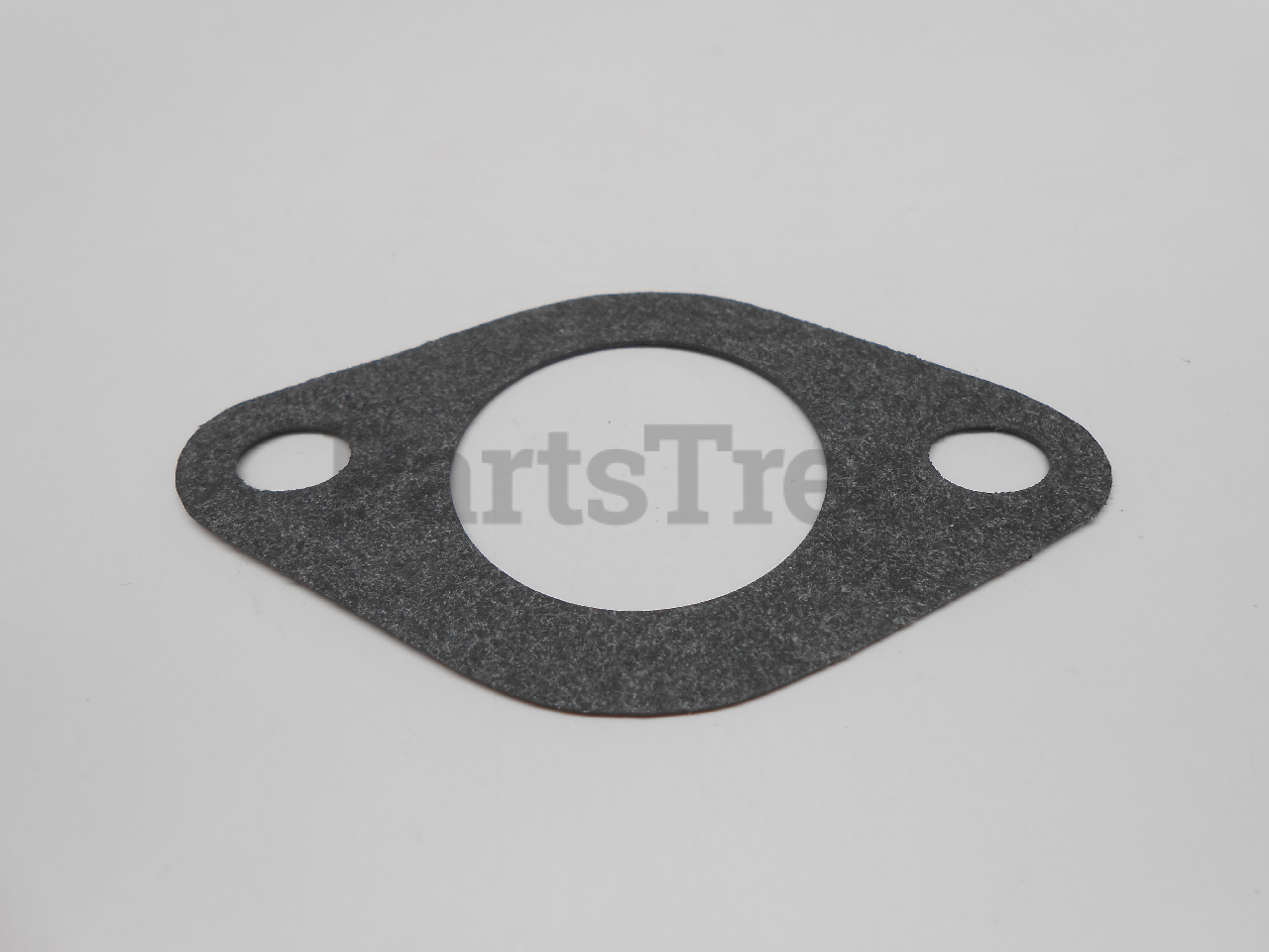

ebinmaine 80,766 #1 Posted November 8, 2021 Is there a Napa or aftermarket part number available? Share this post Link to post Share on other sites
squonk 48,157 #2 Posted November 8, 2021 Parts tree KH271030 https://www.partstree.com/parts/kohler-271030-s/ 1 Share this post Link to post Share on other sites

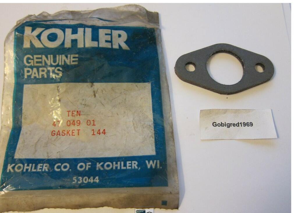

sparkie333 265 #3 Posted November 8, 2021 I think my gaskets on my Kohler 16 for that job is thicker than this one shown-----If I was going to use this one I would use at least 2--IMHO 2 Share this post Link to post Share on other sites
pfrederi 21,181 #4 Posted November 8, 2021 Interesting. Seems Kohler may have used different carb to block gaskets over time. Some i have are almost 1/4" thick obviously to reduce heat transfer.. 4 Share this post Link to post Share on other sites
pfrederi 21,181 #5 Posted November 8, 2021 More like this one. What spec number is you engine 4 Share this post Link to post Share on other sites
Achto 32,795 #6 Posted November 8, 2021 I just cut mine out of gasket material. Always have a roll or 5 laying around. 3 Share this post Link to post Share on other sites
squonk 48,157 #7 Posted November 8, 2021 Thicker gasket is to prevent vapor lock if it has been an issue. Either one will work. 5 Share this post Link to post Share on other sites

squonk 48,157 #9 Posted November 8, 2021 Same gasket on all the big blocks. You can use either. No need for spec no's. Kohler shows only the 2 gaskets used. No need to overthink this. The thicker gasket is just a heat insulator 3 Share this post Link to post Share on other sites
pfrederi 21,181 #10 Posted November 8, 2021 5 minutes ago, squonk said: Same gasket on all the big blocks. You can use either. No need for spec no's. Kohler shows only the 2 gaskets used. No need to overthink this. The thicker gasket is just a heat insulator interesting that there are a whole string of variation numbers for each of the 2 part numbers...Wonder why Kohler decided to have two different ones... 1 Share this post Link to post Share on other sites

Xearl 132 #21 Posted November 9, 2021 I put on a new carb and the thinner gasket and the result was the throttle would not move . I installed the thicker one and the throttle shaft had enough clearance . 3 Share this post Link to post Share on other sites
