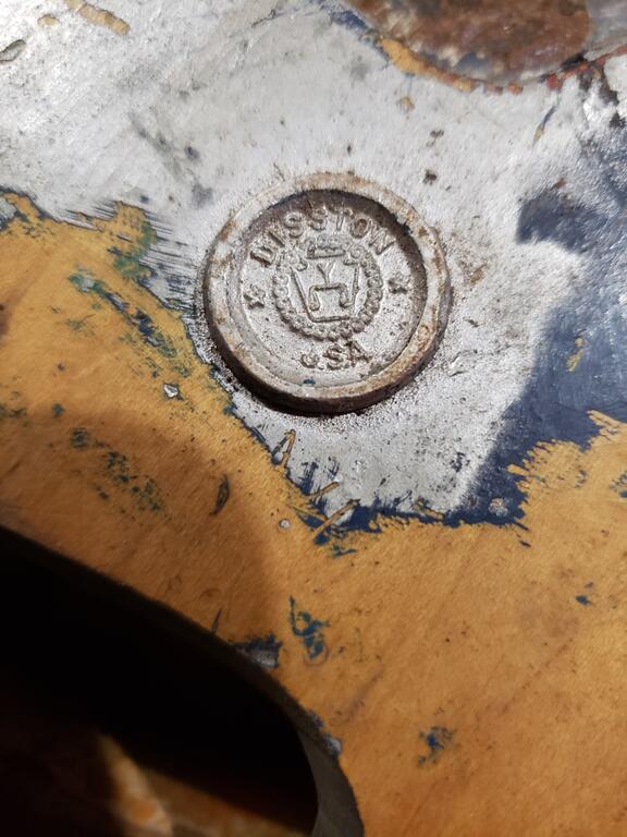

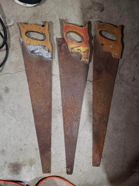

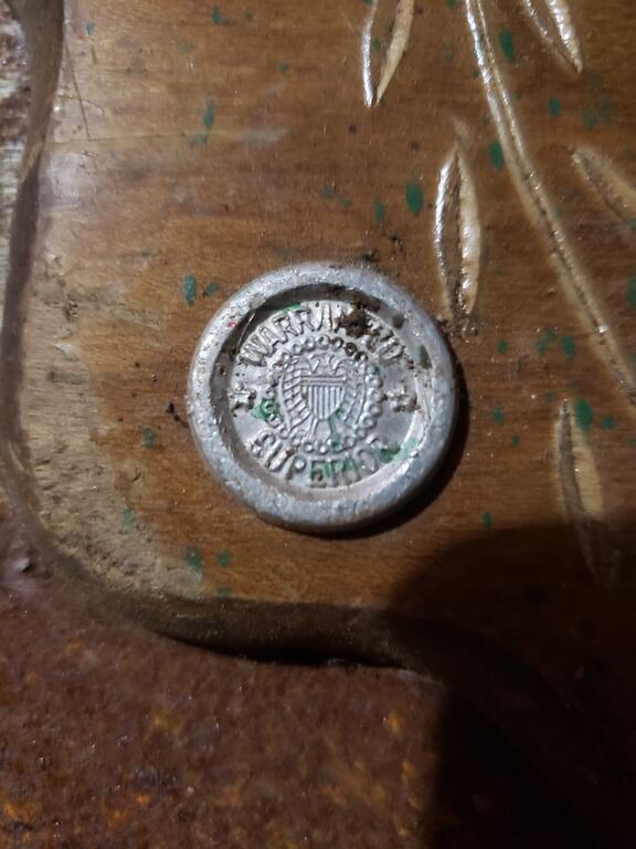

71_Bronco 1,072 #1 Posted November 1, 2021 Picked these up at the local redemption center (town dump). There is an area where people can put stuff that is not trash, but they don't want anymore. I've picked up some decent stuff there before, so I always take a quick look. Snagged these this past weekend. I dont need any saws, but figured they looked cool, and they were free lol. My wife rolled her eyes when I told her I got them lol. Not sure if I scored or if I just got some worthless old saws lol. Some of them seem to have some kind of fancy designs on them, and some are plain. 3 Share this post Link to post Share on other sites
EB-80/8inPA 1,939 #2 Posted November 1, 2021 There’s a site somewhere that covers old Disston saws and their relative rareness/value. Those are pretty rough, but If the blades are flat they can prolly be cleaned up, sharpened and made serviceable (If you have the time/inclination). Now, you might need that special vise… I would guess they’re worth $5 each at the flea as is even if they’re nothing special. Or you can spend hours painting some hokey bumpkin scene on them and double the price! 🤪 2 2 Share this post Link to post Share on other sites
ri702bill 10,571 #3 Posted November 1, 2021 Nick: Disston is a good name in the business-save them all if you can. Bill Share this post Link to post Share on other sites
71_Bronco 1,072 #4 Posted November 1, 2021 The blades are pretty rough, but the steel is pretty solid under the rust. Ill probably clean them up as best I can and see how they look. Any advice on how to clean the old paint off? Just use thinner? Or will that hurt the wood handles? Thanks! Share this post Link to post Share on other sites
DennisThornton 4,772 #5 Posted November 1, 2021 I buy any old Disston that I find if it's price by how it looks. 😉 Good investment or not. I just like them. But I buy cheap! Share this post Link to post Share on other sites
Racinbob 12,424 #6 Posted November 2, 2021 Disstonian Institute.com -- Online Reference of Disston Saws Disston saws have quite a history. You can date them by their handle shape and more specifically the medallion. I've got one that was my grandfathers that's been packed away since we moved back up here from Florida. I dated it by the medallion and If I remember correctly it was pre WW2. I'm going to unpack it today. 1 1 Share this post Link to post Share on other sites
peter lena 9,556 #7 Posted November 2, 2021 @71-bronco, if nothing else, good opportunity for an aerosol lubricant spray down , recovers metal and saves patina, pete Share this post Link to post Share on other sites
953 nut 63,003 #8 Posted November 2, 2021 15 hours ago, 71_Bronco said: I dont need any saws, but figured they looked cool, and they were free lol. My wife rolled her eyes when I told her I got them Since you don't NEED any saws they probably will make great wall hangers. A plasma cutter and a bit of skill can do wonders! If your wife if rolling her eyes over three imagine how she would react to this! 4 2 Share this post Link to post Share on other sites
formariz 12,352 #9 Posted November 2, 2021 (edited) Hand saws are used here just about every day. Your saws are a good find. They are not any of the "collectible" ones if that is your question. They will however have good steel and can be made to work like the best ones out there. To clean them use an electrolysis tank and oil them right after. Remove handles prior to that. You then need to get them sharpened. That may be the hard part for you. See if there is anyone in your area that will do it. Not many places or people out there that can do it. It is a skill that was not common even amongst woodworkers. It takes a deep understanding of cutting action mechanics, tooth geometry, and the correct file for it. Depending on the teeth per inch, different files may be required for each saw. You can learn how to do it. If interested in it, I can help you with that. It does however take besides the knowledge needed, great patience and eyesight. The feeling one gets while using a finely tuned handsaw is one of the most satisfying in woodworking. Edited November 2, 2021 by formariz 3 Share this post Link to post Share on other sites

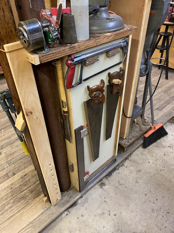

Racinbob 12,424 #13 Posted November 2, 2021 (edited) Here are the two we have. The top one is either my wifes dads or grandfathers. She's not sure. The larger one is my grandfathers. I am the youngest in our family and was born at a later age for my parents. My dad said that my grandfather did meet me as an infant but passed soon after. The only grandparent I remember in my grandmother on my moms side and she passed when I was 7 or 8. On the backside are the saw are his initials Benjamin Franklin Parks. My dad said the backwards and upside down F was something he always did. At one time I made a comment to my dad that it would be cool to do a painting on it. He said quite emphatically NO!. It would no longer be a tool if that was done. Untitled Document (vintagesaws.com) Hopefully that link works. I found it interesting Edited November 2, 2021 by Racinbob 1 2 Share this post Link to post Share on other sites

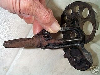

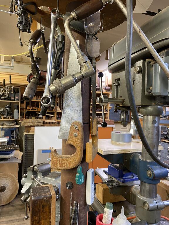

formariz 12,352 #16 Posted November 2, 2021 (edited) I am happy to say that here it is not how it was but how it still is. Handsaws here gather no rust. They are used all the time and sharpened and tuned frequently. I have quite a few sharpened differently for use in different woods. A properly tuned hand saw is a very satisfying tool to use. Wether ripping or cross cutting in most instances they are the go to tool. Now that I don’t have to do my craft for a living they are used almost exclusively for those tasks. Edited November 2, 2021 by formariz 2 Share this post Link to post Share on other sites
Handy Don 15,181 #17 Posted November 3, 2021 2 hours ago, formariz said: Well it sure surprised me to see that we have at least two tools in common! I have a brace that looks just like that one and also the red-handled hack saw with the blade storage in the top tube. I recently had to own up and give my brother the chair rung making bit that my Dad had left him. Brother left it in my hands a few years ago for some reason and after I got it properly adjusted and learned how to use it reminding him that I still had it was a bit sad for me. I was able to give him a short tutorial and I know he'll put it to good use, though. My son put me onto pull saws a couple years ago and I have two now. I really like the control, precision, narrow kerf, and especially the ease of starting a cut. They've won me over. Share this post Link to post Share on other sites
DennisThornton 4,772 #18 Posted November 3, 2021 (edited) 12 hours ago, formariz said: I have no memory of ever seeing one. And I have a couple of the shorter ones. And while I have a chainsaw file guide with similar function to the guide on your bench, I can't remember ever seeing one for a handsaw. Edited November 3, 2021 by DennisThornton Share this post Link to post Share on other sites
formariz 12,352 #19 Posted November 3, 2021 (edited) 2 hours ago, DennisThornton said: I have no memory of ever seeing one The file guide is not common but it does show up on occasion. The vise however is a once in a lifetime opportunity. This one is only the second one I ever came across and the only one that was for sale. 13 hours ago, Handy Don said: red-handled hack saw with the blade storage in the top tube. It is a Craftsman. Bought it in my 20s and it was the one in my journeyman's tool box until it was retired. 13 hours ago, Handy Don said: chair rung making bit Are you referring to a "tenon cutter" like the one below? Edited November 3, 2021 by formariz Share this post Link to post Share on other sites
