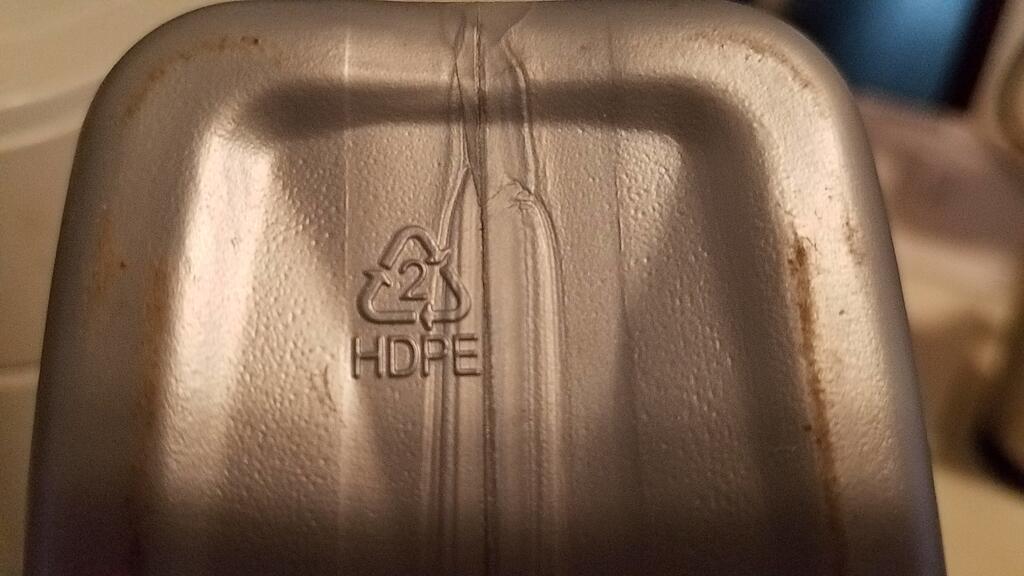

RandyL 53 #1 Posted November 1, 2021 I have a leaking fuel tank. Folks here state that it is polypropylene. ( from here on known as PP ). I was curious where I could aquire more PP to test and weld with. I thought about oil bottles and did a research about such. Oil bottles seem to be made with either PP or HDPE ( high density polypropylene ). The oil producers site got onto recycling.. PP is code 5, HDPE is code 2. I checked 4 oil containers in my shop, sure enough, they were all marked. I had never noticed. All of mine are marked HDPE 2. Outside of that HDPE has a lower melting point than PP. That may be good for trying to repair weld? No idea if this is useful, but did find it interesting. You can get HDPE oil bottles in any color as well. Share this post Link to post Share on other sites

threepiece 6 #17 Posted November 3, 2021 On 11/1/2021 at 4:57 PM, RandyL said: I have a leaking fuel tank. Folks here state that it is polypropylene. ( from here on known as PP ). I was curious where I could aquire more PP to test and weld with. I thought about oil bottles and did a research about such. Oil bottles seem to be made with either PP or HDPE ( high density polypropylene ). The oil producers site got onto recycling.. PP is code 5, HDPE is code 2. I checked 4 oil containers in my shop, sure enough, they were all marked. I had never noticed. All of mine are marked HDPE 2. Outside of that HDPE has a lower melting point than PP. That may be good for trying to repair weld? No idea if this is useful, but did find it interesting. You can get HDPE oil bottles in any color as well. Gosh I thought fuel tanks are made from polyethylene not polypropylene. Isn’t HDPE high density Polyethylene? 1 Share this post Link to post Share on other sites
RandyL 53 #18 Posted November 3, 2021 7 hours ago, threepiece said: Gosh I thought fuel tanks are made from polyethylene not polypropylene. Isn’t HDPE high density Polyethylene? Yes it is. I'm happy you caught that. Not my intent to spread incorrect info. Got my words turned around after reading a few web sites. Thanks! 1 Share this post Link to post Share on other sites
