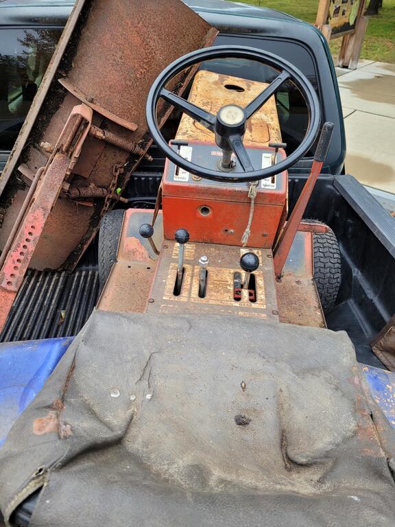

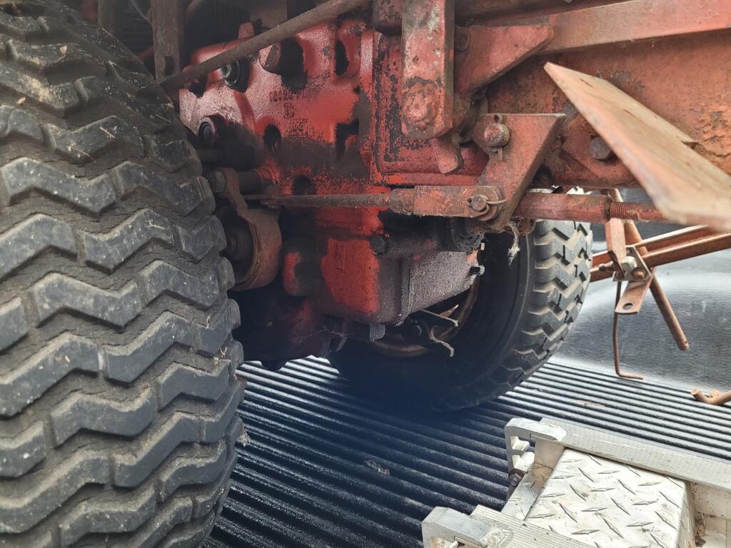

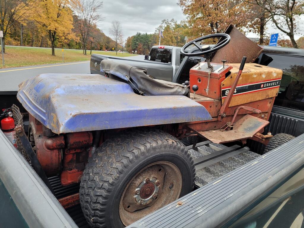

DennisThornton 4,773 #1 Posted November 1, 2021 Another long haul! Too bad because it's obvious from the houses that it had been a very nice neighborhood. Owners daughter grew up there and said it was wonderful then and that she hated it now. Nice folks selling and helping load the tractor, though. No way I could have pushed this 900lb beast up the ramps! Took four of us! I've never owned any Gravely but always wanted to. Even the walk behinds. I've never seen a GT for sale around here and only seen one at a local show. Interesting unit and everything I see is HEAVY DUTY! No belts in the drive train and I think other than the deck no belts any other attachment. All I got was the blade and based in the last 3 decades of living here I doubt I'll find any other attachments. Sure would like a front mounted broom! The only serious downside I see is the lack of a hitch capable of lifting attachments. Seen homemade including a 3-point and while it doesn't matter to me since I have others I would have thought they would have offered at least a clevis. Maybe they did but none have shown up in my searches. I've not even unloaded it yet much less tried to start it. Many other projects including get ready for winter tasks but I will toss in a battery and spend a few minutes on it. Comes with a 3sp with reverse with Hi/Lo but ALSO a shuttle shift, F-N-R, and they call it an 8sp. And take a look at the attachment mounts. Rugged! And the drive shaft through the front axle. Blade is beefy as well. Cast iron grille surround too. And the wonderful blue paint job! Guess that's all he had... 5 4 Share this post Link to post Share on other sites

Pullstart 71,175 #4 Posted November 1, 2021 I’m not familiar with the brand.. but see a VW resemblance. What’s under the hood of the engine is hanging out of the trunk? 2 Share this post Link to post Share on other sites
Snoopy11 5,731 #5 Posted November 1, 2021 I have never seen a horse quite like that before... would like to know more... Don Share this post Link to post Share on other sites
DennisThornton 4,773 #6 Posted November 1, 2021 My original post presented a second path for this thread, but yes, I'd like to focus on the Gravely. No auto manufacture influence that I know of but Studebaker eventually bought them and produced them even after they quit making cars! Gas tank and battery under the hood. Rear engine/transaxle, and I was told, is the SAME as the two wheel tractors. Never heard that before or read it but the fellow was a long time tractor mechanic. 1 1 Share this post Link to post Share on other sites

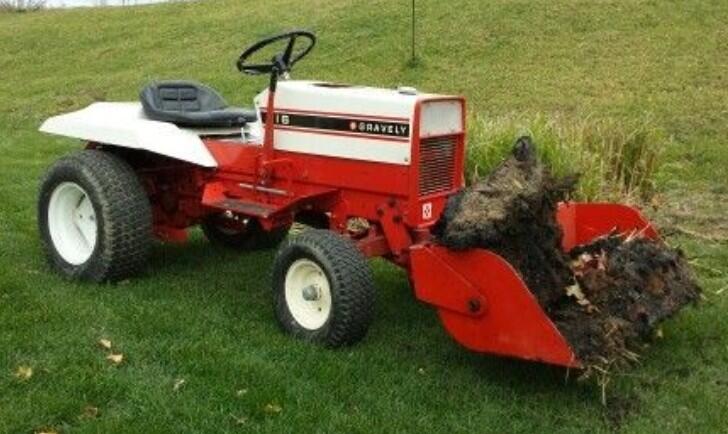

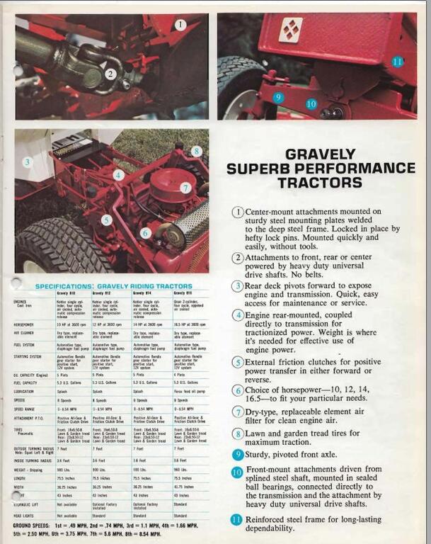

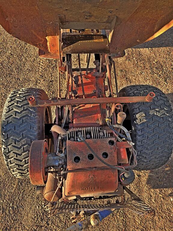

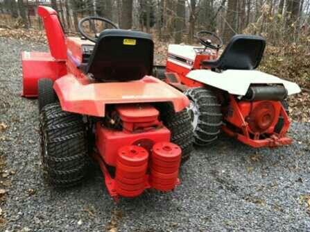

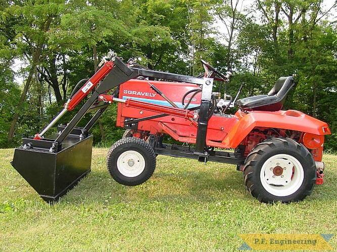

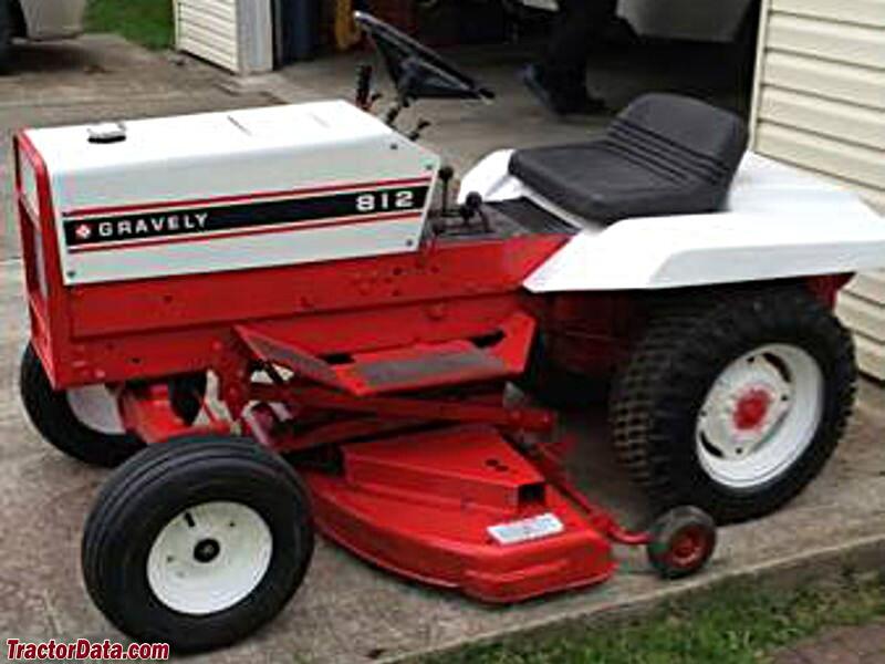

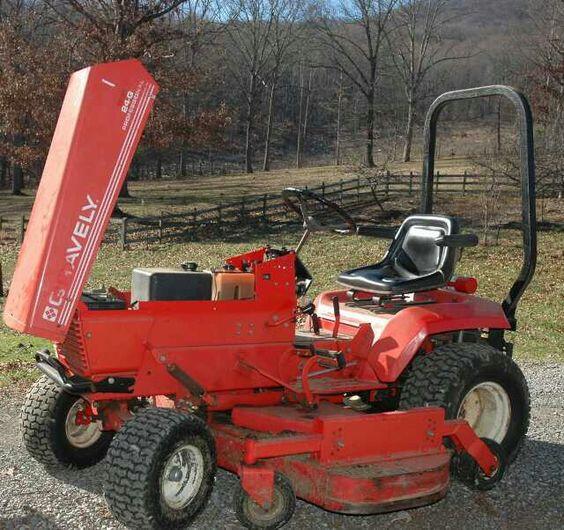

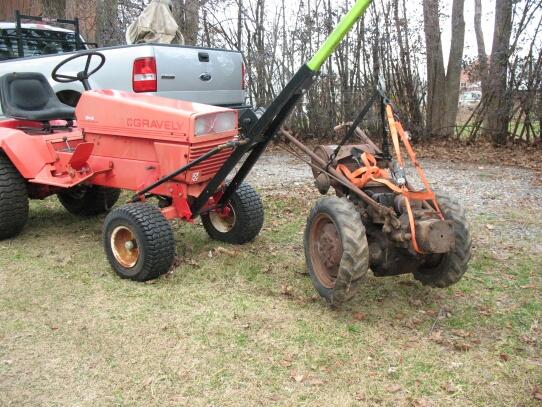

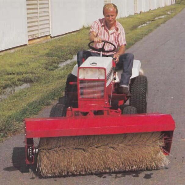

DennisThornton 4,773 #13 Posted November 1, 2021 Some pics I've found online. I want the rotary brush! 1 Share this post Link to post Share on other sites

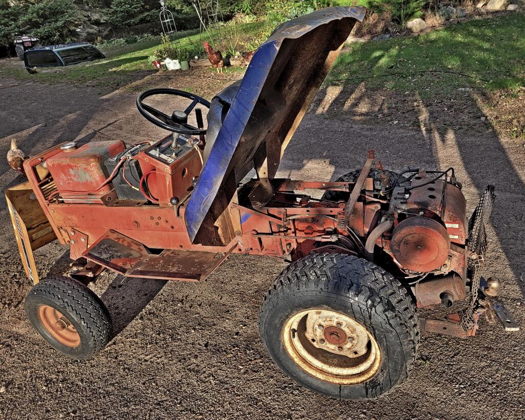

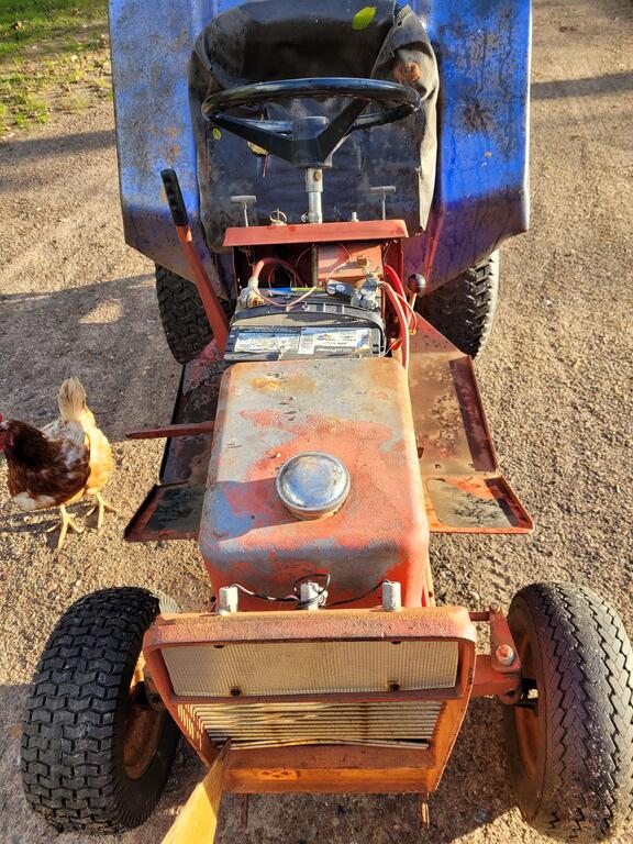

DennisThornton 4,773 #14 Posted November 1, 2021 Jumper battery (my new and most impressive Lithium!), some starter fluid and the old K321 fired right up! Runs as long as I spray! No blue smoke! Obviously didn't take it for a spin but I just might tomorrow. Fuel really stunk so I expect a good purging and new gas will revive the fuel system and her. Pop the hood and lift the seat deck and pretty much all is right there! Never seen anything so easy to get to everything! And the more I look the more beefy this thing seems. Even the hood! Seat deck is about the only thing I'd call ordinary sheet metal. 900 lbs and it's not in the sheet metal! Here's some more pics of it. Would love to here from other Gravely owners! 1 Share this post Link to post Share on other sites

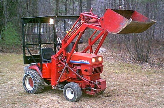

Handy Don 17,399 #18 Posted November 1, 2021 2 hours ago, DennisThornton said: Have never been impressed to see that an FEL can lift the front end of a tractor. It's the lift in the other direction I care about. 2 Share this post Link to post Share on other sites

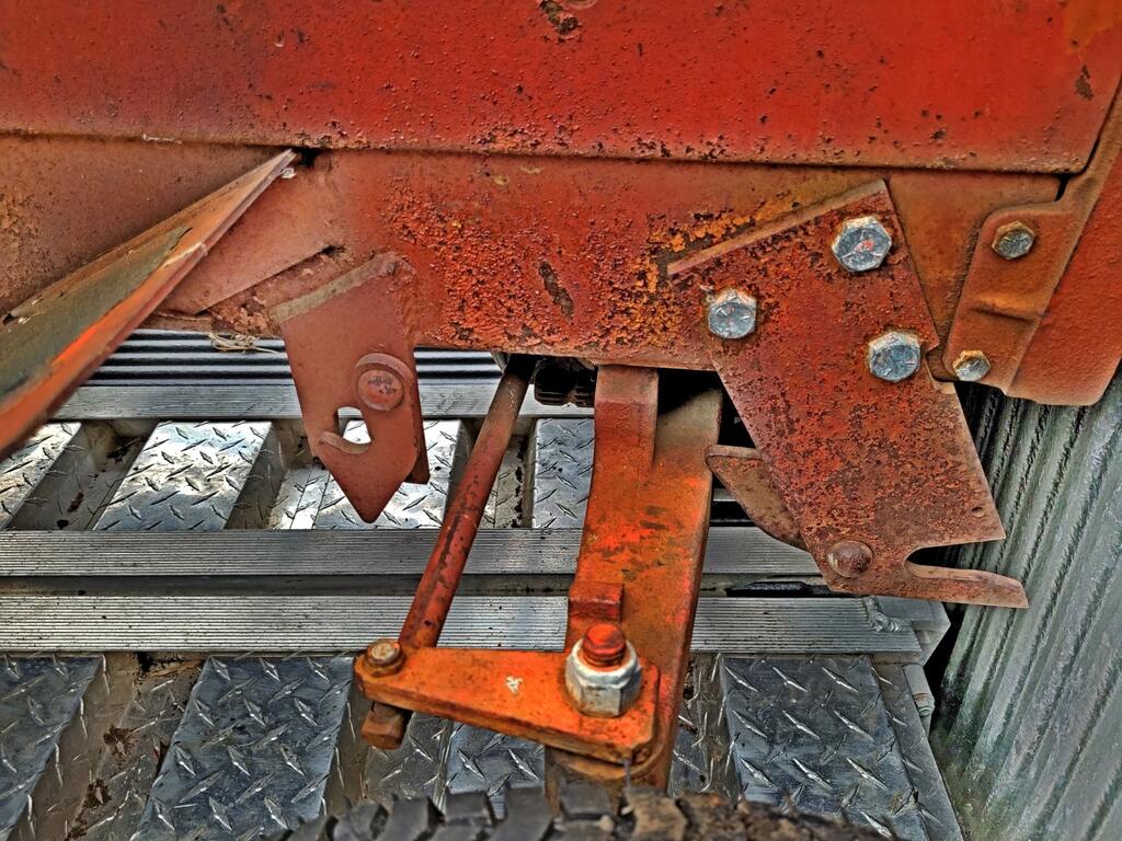

DennisThornton 4,773 #19 Posted November 1, 2021 (edited) 11 minutes ago, Handy Don said: Have never been impressed to see that an FEL can lift the front end of a tractor. It's the lift in the other direction I care about. Yeah, marketing. Looks great but... What impressed me was this thing's frame and heavy attachment mounts. Other than my Economy/Power King this is the most robust GT I have. Edited November 1, 2021 by DennisThornton grammer Share this post Link to post Share on other sites
Pullstart 71,175 #20 Posted November 2, 2021 2 hours ago, Handy Don said: Have never been impressed to see that an FEL can lift the front end of a tractor. It's the lift in the other direction I care about. 2 hours ago, DennisThornton said: Yeah, marketing. Looks great but... What impressed me was this thing's frame and heavy attachment mounts. Other than my Economy/Power King this is the most robust GT I have. I thought about the FEL on this machine when I saw that. Would they have had a counter balance or relied on that cast iron Kohler? Share this post Link to post Share on other sites
Handy Don 17,399 #21 Posted November 2, 2021 (edited) 2 hours ago, Pullstart said: I thought about the FEL on this machine when I saw that. Would they have had a counter balance or relied on that cast iron Kohler? It would be interesting to see a picture of an FEL with the bucket under something really heavy and the REAR wheels lifted but really, the key stat is what weight can it safely get off the ground and at different lift heights. The big boys all specify that stuff in their manuals. Edited November 2, 2021 by Handy Don 2 Share this post Link to post Share on other sites
oliver2-44 11,718 #22 Posted November 2, 2021 (edited) 12 hours ago, DennisThornton said: ALSO a shuttle shift, F-N-R, Edited November 2, 2021 by oliver2-44 1 Share this post Link to post Share on other sites
oliver2-44 11,718 #23 Posted November 2, 2021 (edited) @DennisThornton is the F-N-R Shuttle Shift in a separate case or in the 8 speed transmission case? Edited November 2, 2021 by oliver2-44 Share this post Link to post Share on other sites
Tractorhead 9,217 #24 Posted November 2, 2021 (edited) 9 hours ago, DennisThornton said: Some pics I've found online. I want the rotary brush! Nice saving Dennis, and cool Engeneering in the first. simple but reliable. oh yeah - Such a brush is also on my wishlist. but they be dang expensive here and extremly hard to find. Edited November 2, 2021 by Tractorhead 1 Share this post Link to post Share on other sites
DennisThornton 4,773 #25 Posted November 2, 2021 7 hours ago, Pullstart said: I thought about the FEL on this machine when I saw that. Would they have had a counter balance or relied on that cast iron Kohler? Obviously the Kohler helps but I think I uploaded a pic with lots of rear weights too so I guess it depends. I know my NH TC35 is a very different machine when the backhoe is there compared to nothing on the back! Share this post Link to post Share on other sites
