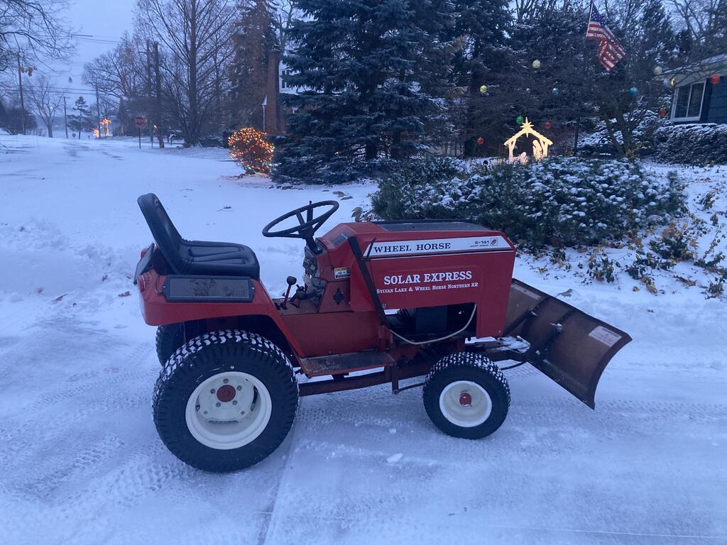

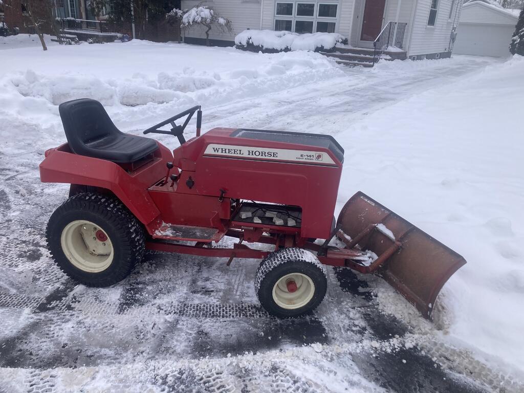

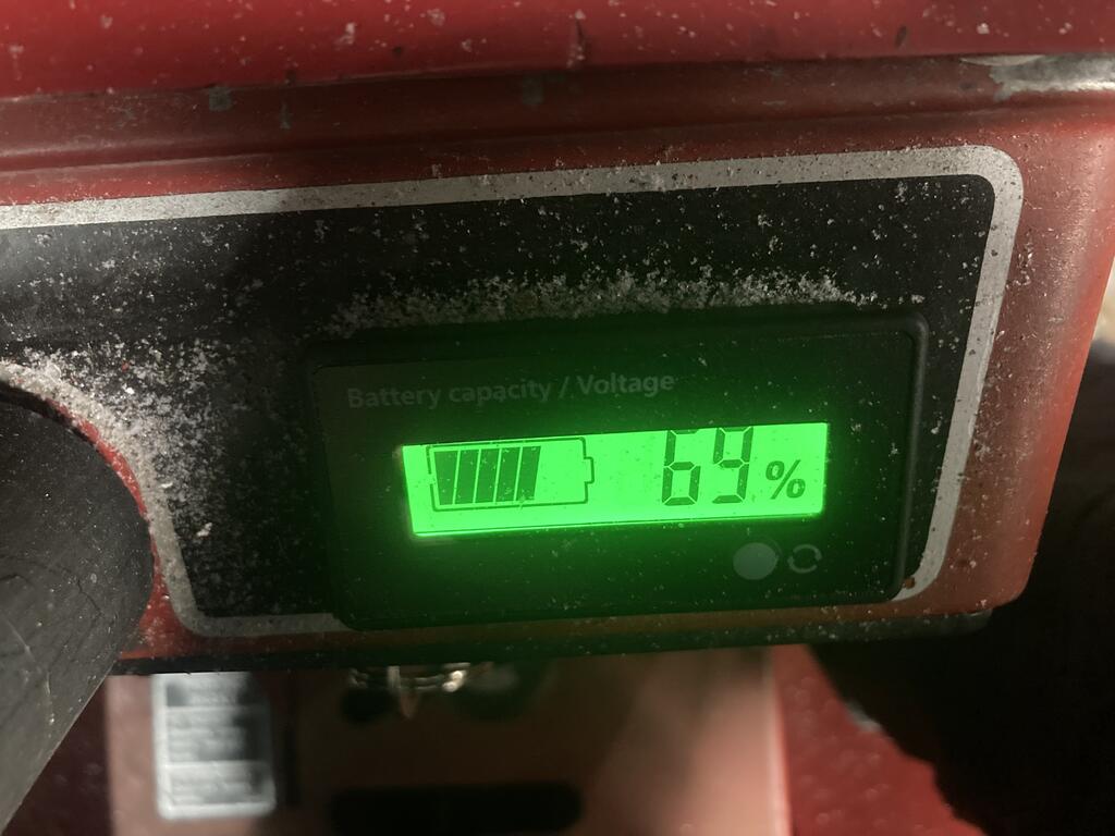

SylvanLakeWH 32,619 #153 Posted December 23, 2022 Winter report on battery usage: Just finished first plowing with the E-141. Two driveways. About 3" total snow on frozen slop with hard pack drifts 12-24". 5 degrees with -17 degree windchill. No chains no added weight. 69% remaining on batteries after 45 minutes plowing. Two driveways... flat concrete. 8 Share this post Link to post Share on other sites
c-series don 12,487 #154 Posted December 24, 2022 Absolutely love the fact that you are using that tractor for a use that probably very few E-series owners ever used them for. Also just wanted to add one thing. At 14 years old I got a 42” blade for Christmas for my Work Horse GT-1800. I used it to plow snow for years in the position you have yours in, I think it’s the third hole from the top with the springs? I mainly had it like this because I thought it looked cool, however years later I restored a 48” blade and rolled it back to the second hole from the top. I was surprised how much better it pushed and rolled snow. I’ve actually tried the top hole for pushing dirt so it would cut better and used the bottom hole for spreading gravel. Pretty amazing that the engineers at Wheel Horse actually gave thought to this. Keep rocking the E-141 I love it!! 4 1 1 Share this post Link to post Share on other sites
SylvanLakeWH 32,619 #155 Posted December 24, 2022 7 minutes ago, c-series don said: Absolutely love the fact that you are using that tractor for a use that probably very few E-series owners ever used them for. Also just wanted to add one thing. At 14 years old I got a 42” blade for Christmas for my Work Horse GT-1800. I used it to plow snow for years in the position you have yours in, I think it’s the third hole from the top with the springs? I mainly had it like this because I thought it looked cool, however years later I restored a 48” blade and rolled it back to the second hole from the top. I was surprised how much better it pushed and rolled snow. I’ve actually tried the top hole for pushing dirt so it would cut better and used the bottom hole for spreading gravel. Pretty amazing that the engineers at Wheel Horse actually gave thought to this. Keep rocking the E-141 I love it!! Thanks for the comments!!! I have a brand new concrete driveway and plow another brand new one next door. Blade is purposely in that spot to reduce bite for first couple of years... I agree that your suggested tilt would scrape better but for now i'm purposely keeping it lightly scraping... I'm babying the new drive... I'll keep posting as I go with the E-141... it really is a great tractor... so much more than a tug for the train (but don't tell the little guys... they think all the 's are for them)... 3 2 Share this post Link to post Share on other sites

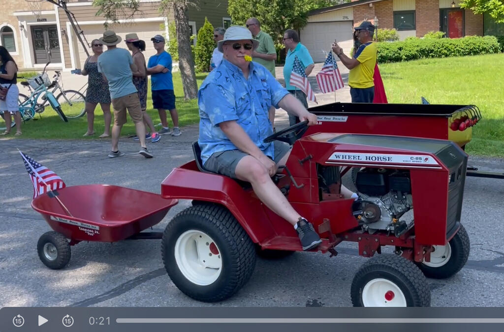

SylvanLakeWH 32,619 #157 Posted January 22, 2023 I'm cheap... Here's a bit of the horn in action... IMG_1588.MOV 2 Share this post Link to post Share on other sites
Pullstart 71,333 #158 Posted January 24, 2023 I kinda halfway almost recognize this one! As for train horns, have any room for a compressor? 1 Share this post Link to post Share on other sites
SylvanLakeWH 32,619 #159 Posted January 24, 2023 That's one of my older brothers... identical twins. They were my gas engine pit crew in case my electric failed me... I had tow straps ready to go... Horn - I went simple... never know. May upgrade as I expand the train... Several more nieces / nephews have little ones in the pipeline, so i'm looking to either add cars to the train or go with another whole train... decisions decisions... Problem going longer is turning around in the street... 2 1 Share this post Link to post Share on other sites
Pullstart 71,333 #160 Posted January 24, 2023 3 hours ago, SylvanLakeWH said: That's one of my... identical twins. I see different engines and different fender pans… 1 1 1 Share this post Link to post Share on other sites
SylvanLakeWH 32,619 #161 Posted January 24, 2023 Good Eye!!! Share this post Link to post Share on other sites
Evguy 567 #162 Posted January 28, 2023 On 12/23/2022 at 6:14 PM, SylvanLakeWH said: Winter report on battery usage: Just finished first plowing with the E-141. Two driveways. About 3" total snow on frozen slop with hard pack drifts 12-24". 5 degrees with -17 degree windchill. No chains no added weight. 69% remaining on batteries after 45 minutes plowing. Two driveways... flat concrete. I’m thinking my lithium battery powered 1800 wouldn’t fare as well, gave some thought to putting snowblower on it and see how it works 1 Share this post Link to post Share on other sites

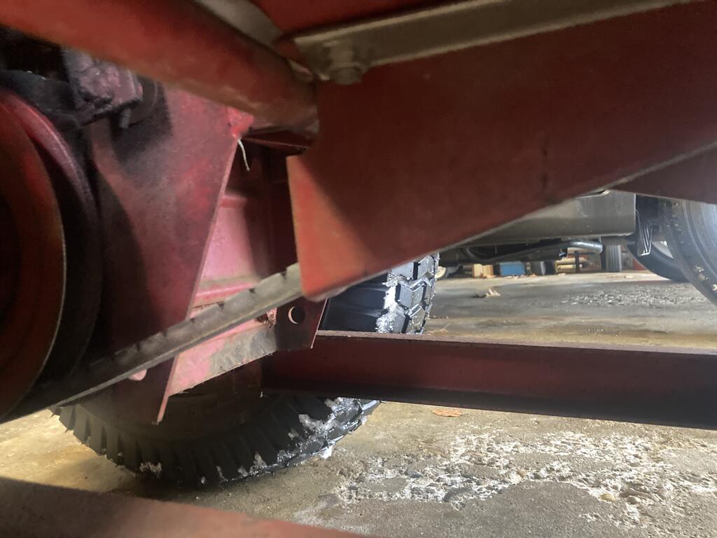

SylvanLakeWH 32,619 #163 Posted January 29, 2023 Plowing with the E-141 and all of a sudden it starts screaming a blood curdling high screech from belt / pulley area... way loud... Pop off the belt guard and find the belt had somehow jumped UNDER the belt guide!!! Now mind you this is physically shall we say not likely. I had to really pull to get it back on top the guide where it belongs... First photo as I found it. Second photo correct routing... Plowed 4 drives today no issues... 1 2 Share this post Link to post Share on other sites
Rick3478 469 #164 Posted January 30, 2023 I've had that happen before. In your case you noticed it right away. I think I may have run a 314 that way for a couple years. All it takes is for the belt to grab a twig or chunk of ice and drag it through the guard. 1 1 Share this post Link to post Share on other sites
Pullstart 71,333 #165 Posted February 1, 2023 Does that have a Kevlar belt or rubber belt? Share this post Link to post Share on other sites
SylvanLakeWH 32,619 #166 Posted February 1, 2023 I think rubber...? It seems to be original... Share this post Link to post Share on other sites

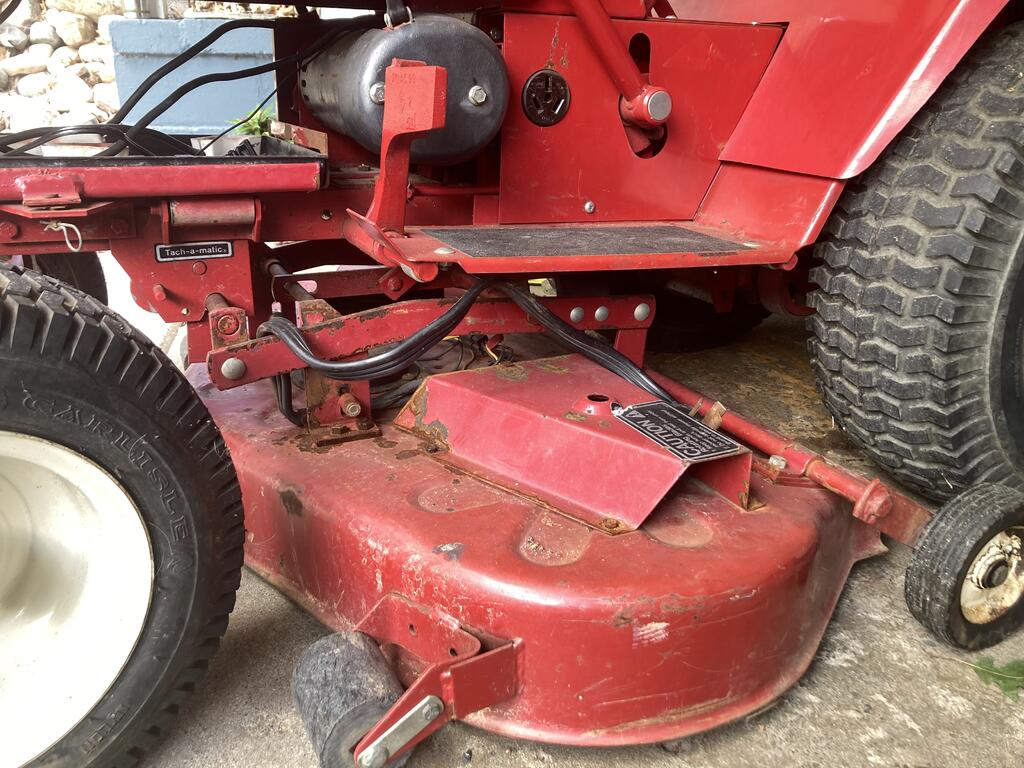

sgtsampay 166 #167 Posted January 22, 2024 I know this is an older thread, but what attachments can the E-141 uses? I don't see how it can use a tiller or snowblower do to a lack of side PTO. How does the mower deck route by chance? Thank you for your time. Share this post Link to post Share on other sites
SylvanLakeWH 32,619 #168 Posted January 22, 2024 (edited) Hi! It's basically a C series Black Hood frame and transmission with an electric 36 v motor and space for six 12 volt batteries. I run with three. No pto from motor. There is an electric pto plug that can run mower deck (3 separate motors one for each blade) and deck hooks up same as any with mid tach o matic. Also others like a chain saw, but i have never seen any other attachments for it for sale... Same front plow blade as my C105 hooks right up. Plows very well. Edited January 22, 2024 by SylvanLakeWH 2 1 Share this post Link to post Share on other sites
sgtsampay 166 #169 Posted January 26, 2024 Oh, ok. I understand now. I didn't realize that the mower deck had electric motors on it. That's why I didn't see a PTO anywhere/. Thanks for the explanation. 1 Share this post Link to post Share on other sites

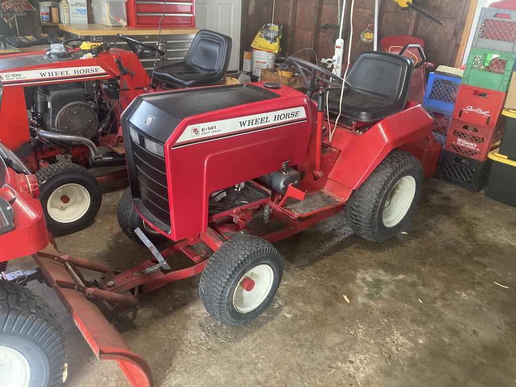

Pullstart 71,333 #170 Posted February 13, 2024 Is this the machine you want to plow with? Is anything hooked to the lift arm? Share this post Link to post Share on other sites
SylvanLakeWH 32,619 #171 Posted February 13, 2024 21 minutes ago, Pullstart said: Is this the machine you want to plow with? Is anything hooked to the lift arm? No nothing is hooked. It was used for deck and now the front blade but that will be removed in March... Probably use this one: 3 2 Share this post Link to post Share on other sites
