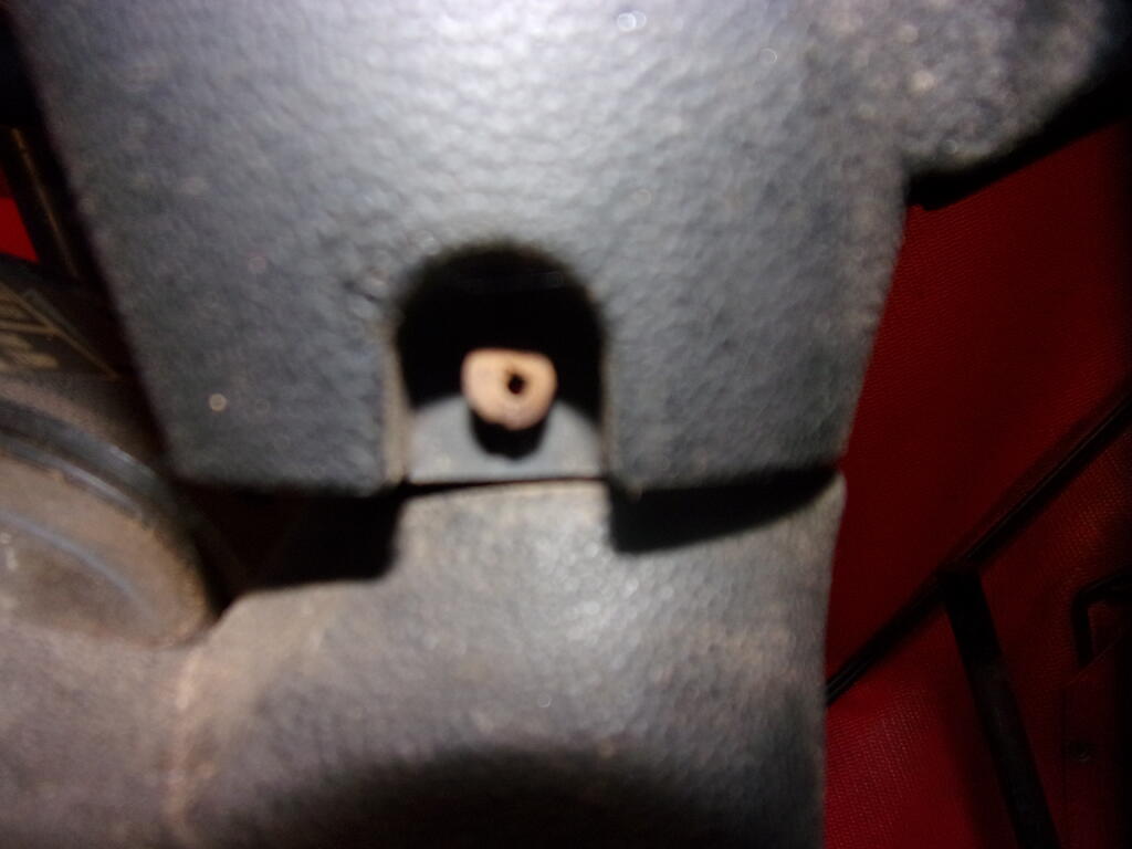

xstang77 2 #1 Posted October 30, 2021 Would someone be able to show a picture or offer insight how the steering wheel is retained on the shaft on an 88' 520h? I'm intending to put a 90's 314 steering wheel on which looks like it uses a simple straight through roll pin,however the 88 shaft instead of a through hole has grooves notched in instead. Share this post Link to post Share on other sites

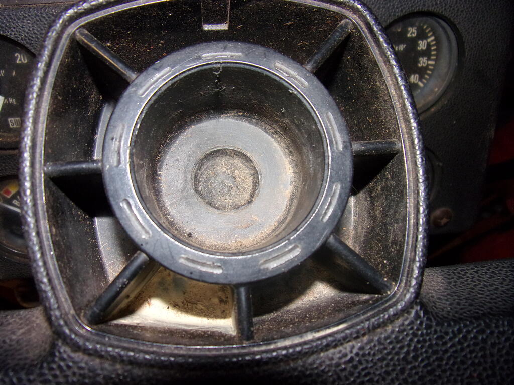

Ed Kennell 44,857 #4 Posted October 30, 2021 I never had the wheel off my '88 520H so I do not know if the shaft is splined. It does have the typical roll pin. The wheel hub is notched on both sides to install/remove the roll pin. The center hole you see is plastic hub, not the shaft. 3 Share this post Link to post Share on other sites
Lee1977 7,551 #5 Posted October 30, 2021 21 minutes ago, Ed Kennell said: I never had the wheel off my '88 520H so I do not know if the shaft is splined. It does have the typical roll pin. The wheel hub is notched on both sides to install/remove the roll pin. The center hole you see is plastic hub, not the shaft. That's plastic the shaft doesn't cone through on those steering wheels they ate pinned with a roll pin just like the other Wheel Horses. Share this post Link to post Share on other sites

Handy Don 15,933 #7 Posted October 30, 2021 1 hour ago, xstang77 said: I'll post a pic of the shaft on the 520 this evening,the 314 seems to have a through hole,worst comes to worst I imagine I could just drill a straight hole through the 520 shaft. Thanks for all the insight for so far! Had two 500 steering shafts--regular and gear-reduced versions. Both identical to @Ed Kennell, roll pin only and smooth bore. Don't think you'll need to do any drilling, but having a roll pin punch and very solid lateral support on the steering shaft helps a lot (I notched a 2x4 bolted to a garage beam to fit snugly against the steering shaft). 1 Share this post Link to post Share on other sites
ri702bill 11,254 #8 Posted October 31, 2021 (edited) Take Don's advise - backing up the steel portion of the shaft solid to the building is the way to go - been there, done that. Use a real roll pin punch, not a flat one. Secure it with a pair of locking pliers (aka Vise grips) and have at it with a 3 pound hammer. Bill Edited October 31, 2021 by ri702bill 1 Share this post Link to post Share on other sites

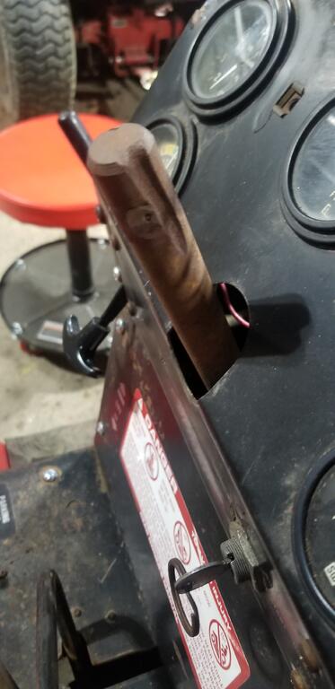

xstang77 2 #9 Posted October 31, 2021 Here's the odd 520 shaft Share this post Link to post Share on other sites
xstang77 2 #10 Posted October 31, 2021 No roll pin hole,just those vertical grooves, one on each side. Share this post Link to post Share on other sites
Ed Kennell 44,857 #11 Posted October 31, 2021 Looks like someone tryed to stake the wheel by drilling axial holes. Is that the remains of a sheared off roll pin to the left of the groove? 4 Share this post Link to post Share on other sites
lynnmor 8,623 #13 Posted October 31, 2021 Someone trashed the steering shaft a long time ago. Share this post Link to post Share on other sites
xstang77 2 #14 Posted October 31, 2021 Looks like my only option is to re drill it then,thanks Share this post Link to post Share on other sites
Lee1977 7,551 #15 Posted October 31, 2021 They were trying to tighten It up the pot metal sleeve in those steering wheels tend to wallow out. Mine was so loose that it hit the top of the dash. The hole in the shaft is there may be filled with something. That gash in the column look like it was done with a side grinder. Share this post Link to post Share on other sites
