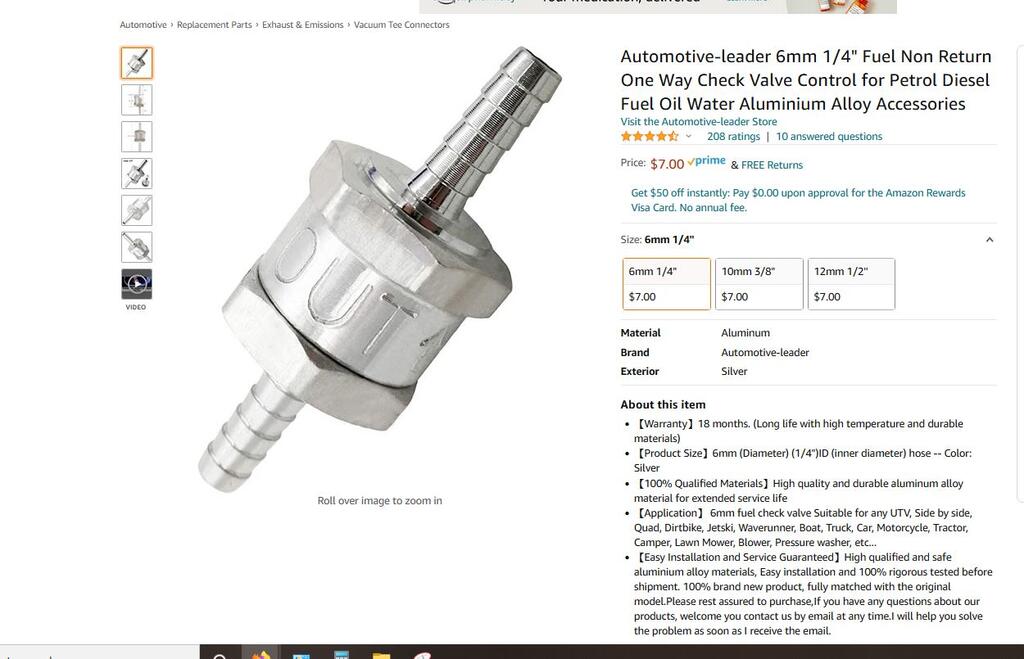

pfrederi 21,301 #9 Posted October 30, 2021 Might try one of these cheaper than a new fuel pump 1 Share this post Link to post Share on other sites
Handy Don 17,671 #10 Posted October 30, 2021 10 hours ago, DarylJ said: Don, I was going to ask you when you posted the first time….did you have the same problem on your tractor as I am having with mine? If so, did replacing the fuel pump fix the problem? Thanks. I thought so, and yes starting after longer "sits" was easier. In retrospect, though, having read some others' experience, I think a bulb primer would have been sufficient since the pump (and its internal check valves) worked fine once the engine was running. Share this post Link to post Share on other sites
DarylJ 49 #11 Posted October 30, 2021 3 hours ago, pfrederi said: Might try one of these cheaper than a new fuel pump Share this post Link to post Share on other sites
DarylJ 49 #12 Posted October 30, 2021 Thanks for the link. Ordered one! Definitely a big savings over replacing the fuel pump when all that’s necessary is keeping the fuel in the line from flowing back into the tank. Share this post Link to post Share on other sites
DarylJ 49 #13 Posted October 30, 2021 3 hours ago, Handy Don said: I thought so, and yes starting after longer "sits" was easier. In retrospect, though, having read some others' experience, I think a bulb primer would have been sufficient since the pump (and its internal check valves) worked fine once the engine was running. These pumps seem to have a “failing” mode for an undetermined period of time before they quit functioning altogether, when they become “failed”. Mine has been failing for the past 3 or 4 years, but I’ve put up with it as it would eventually start the tractor and keep it running as if no problems existed. If the check valve and primer bulbs overcome the long cranking times, they are definitely an inexpensive solution, at least for awhile. 1 Share this post Link to post Share on other sites
