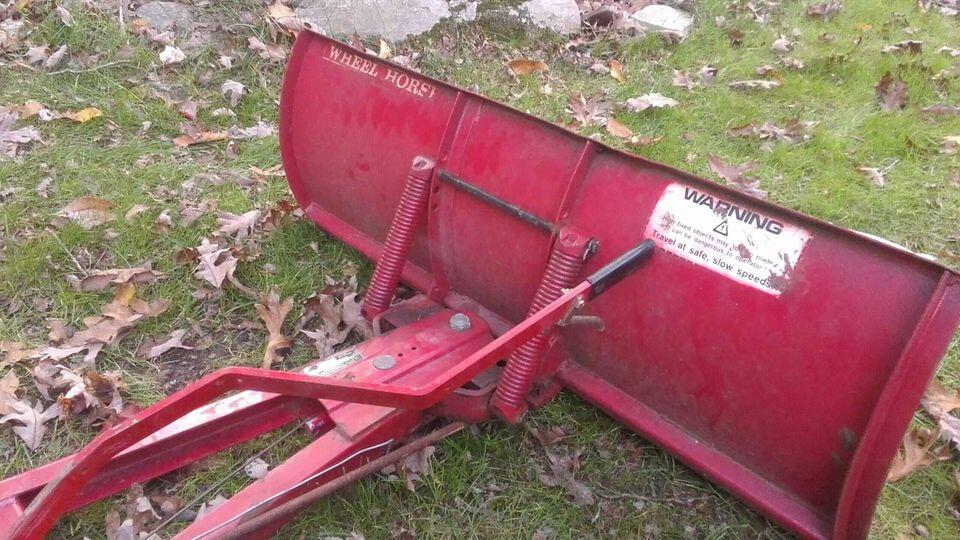

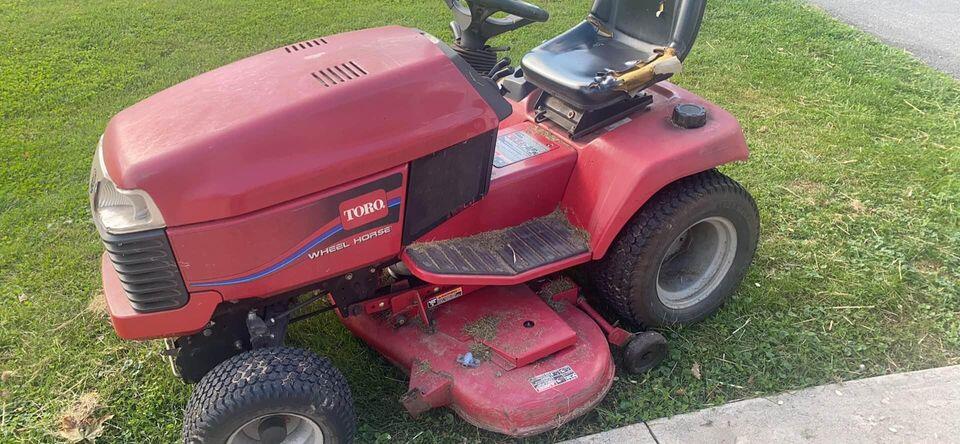

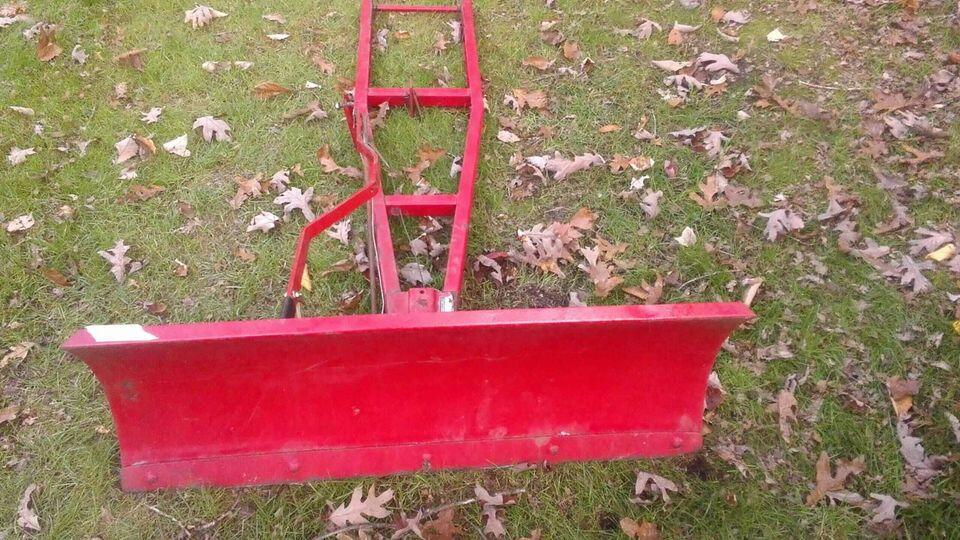

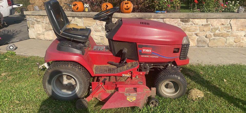

Inspectorjoe 473 #1 Posted October 28, 2021 I promised my wife I won't be buying any more tractors, but after spotting a Marketplace ad, I may soon be putting myself in the doghouse. This 520 LXI looks like it hasn't led a pampered life, but the asking price is only $500. The only problem mentioned in the ad is a damaged deck wheel mount. The year isn't given, so I don't know if the engine has the plastic cam gear, but even if it did, given the asking price, that wouldn't be a deal killer. As a bonus, it's only about two miles from my house, so I could drive it home. My only tractor transportation is a minivan. I've had a Lawn Ranger, a Charger 10, a 1973 14 Automatic and a C-120 in it, but I I can't see getting the 520 LXI in. My main issue is snow blade availability. I don't if I'd be able to find one without driving 300 or more miles. I'm not even sure what they look like. I saw a blade online (pictured) that isn't too far from me, but the ad doesn't specify what it fits and I haven't heard back from the seller. It has an unusual bend in the handle, but it doesn't match one I saw online that was attached to a 520 LXI. Thinking of another possibility, would it be possible to (easily) modify an older long frame plow to fit? Share this post Link to post Share on other sites
gwest_ca-(File Mod) 12,259 #2 Posted October 28, 2021 They came out as 1989 models but this one may be 1999 or newer because it looks like the NMIR (No mow in reverse) switch can be seen under the seat. The proper dozer is model 79355 Click on the large blank space near the top of this link. The rear attachamatic hitch still mounts under the rear axle but attachments connect front and rear of the hitch so that will affect dozer A-frame length. I think the assembly may also be wider. I don't think this will help. 79350 blade or an earlier version is what you are wanting to use. If I remember correctly this kit is very expensive but maybe you can make it up. Share this post Link to post Share on other sites
