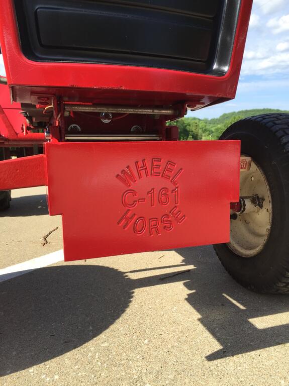

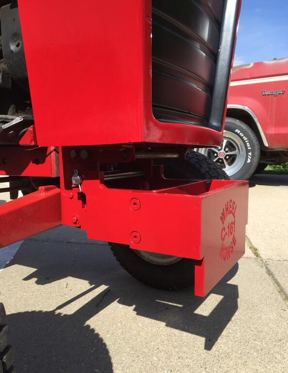

Pullstart 71,098 #3 Posted October 28, 2021 Fluid filling is a great option as well. @ri702bill made a cool set of front weights, possibly manufacturing your own is the way to go Share this post Link to post Share on other sites

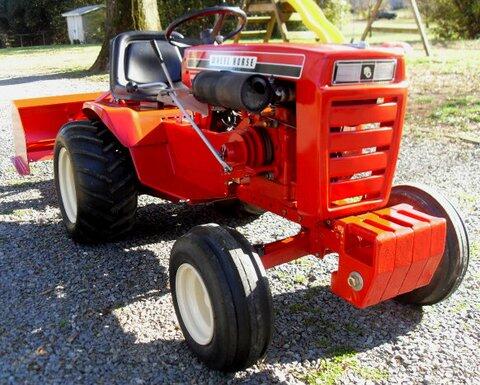

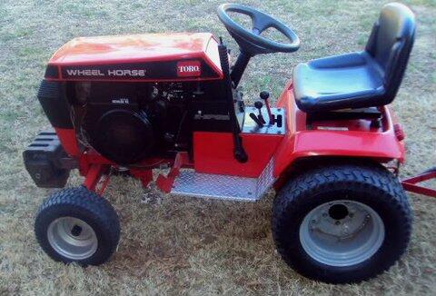

ri702bill 12,810 #5 Posted October 29, 2021 As Kevin (@Pullstart) mentioned above, I made 25 pound front weights for both the C81 and the 854 8 speed. The C81 front wheels have such a deep offset that there is actually enough room to add a 7-1/2 pound extra weight inside behind the 25 pounder, which I did for last winter. These are 25 Lb. cast iron barbell weights with threaded rod. The cast iron they use for weights has a very coarse grain and is a challenge to drill & tap - even with a brand new tap! A local guy buys and sells used gym equipment - last time I checked with him, he was getting a buck a pound for single weights. Also both sets of front wheels have tubes filled with winter grade windshield washer fluid - no Rimguard beet juice dealers within decent driving distance around here. Bill Share this post Link to post Share on other sites

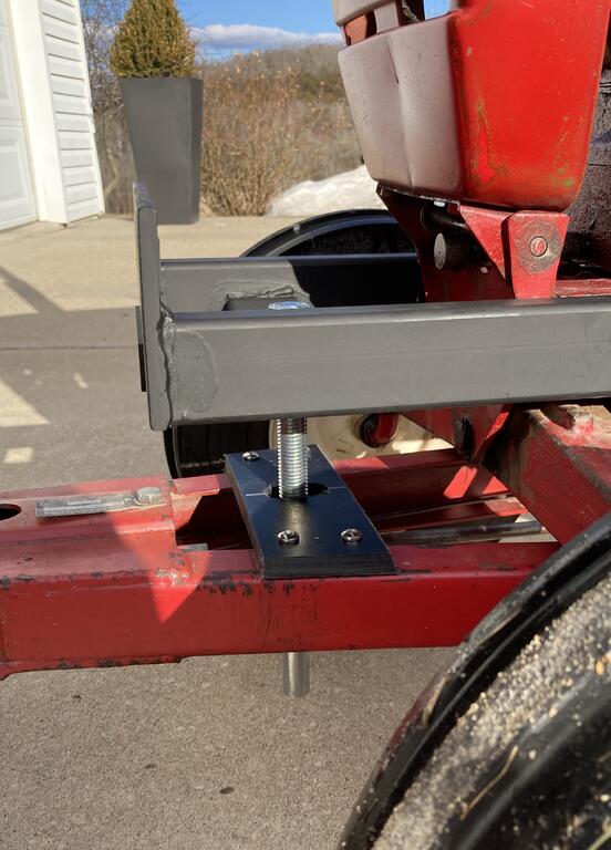

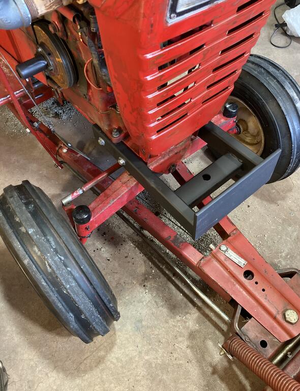

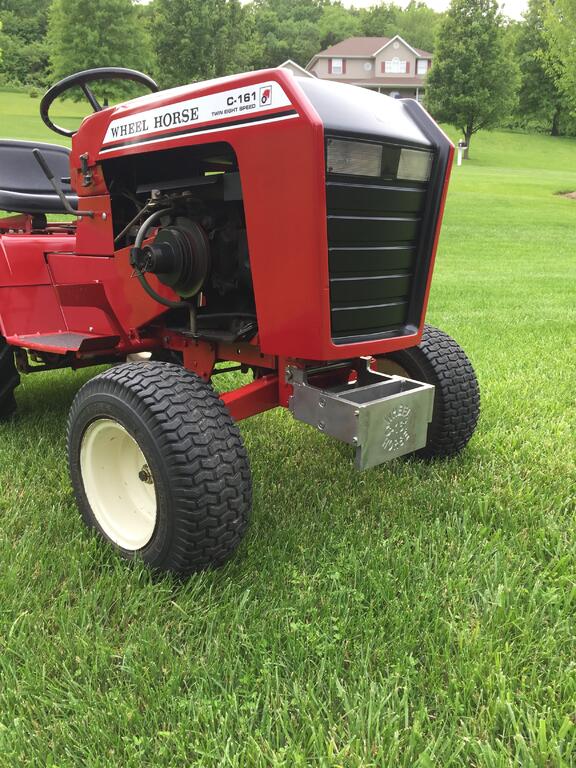

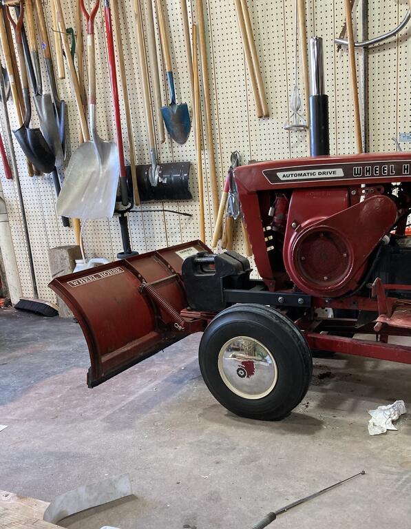

cschannuth 3,821 #7 Posted October 29, 2021 I just built a homemade weight bracket so that suitcase weights can be installed or removed. I set it up so that I could still leave them in place even when I was using my snowplow and it works well and gives me a lot of flexibility. 2 Share this post Link to post Share on other sites
Ed729 57 #8 Posted October 29, 2021 That weight bracket would be handy, might be nice to add a hitch to it as well. Does it work with a front mule drive? Share this post Link to post Share on other sites

cschannuth 3,821 #10 Posted October 30, 2021 (edited) 13 hours ago, Ed729 said: That weight bracket would be handy, might be nice to add a hitch to it as well. Does it work with a front mule drive? No, I didn’t use that tractor for anything but snow plowing or pushing dirt or gravel. If you have a newer model tractor that has a mule drive you can build a weight bracket that mounts to your mule drive location. Or I’ve also seen people take old mule drives and modify them to accept weights. That makes it very easy to take it on and off quickly. There are lots of options out there. Edited October 30, 2021 by cschannuth Share this post Link to post Share on other sites
kpinnc 18,884 #11 Posted November 4, 2021 (edited) On 10/29/2021 at 6:57 PM, Ed729 said: That weight bracket would be handy, might be nice to add a hitch to it as well. Does it work with a front mule drive Mine does. Just welded the bracket to an old busted mule drive. 100+ pounds with 4 weights. Just pay attention to how high you mount the weights. Mine allows the hood to open, but even 1/2 higher would restrict how much the hood can open. Also works on newer models. Edited November 4, 2021 by kpinnc 1 Share this post Link to post Share on other sites
Ed729 57 #12 Posted November 4, 2021 Looks good! I think my hood might be missing a limiting strap or something. It hinges almost until the hood is touching the ground, so anything I put there is going to hit for me. Need to figure that one out I guess. Share this post Link to post Share on other sites
