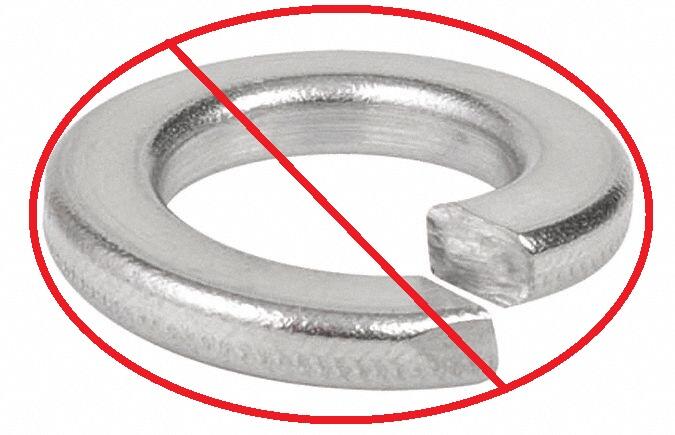

Achto 32,110 #11 Posted October 28, 2021 (edited) As long as we are on the subject of hardware, I'd like to bring up the subject of split lock washers. The useless fantasy used by many manufacturers and mechanics for years. They are generally more harm than good. https://engineerdog.com/2015/01/11/10-tricks-engineers-need-to-know-about-fasteners/ Edited October 28, 2021 by Achto 3 1 Share this post Link to post Share on other sites
squonk 47,422 #12 Posted October 28, 2021 The 2 K181's i just did had copper sealing washers under the bolts. The big blocks I just scrapped has lock washers. Share this post Link to post Share on other sites
Gregor 4,848 #13 Posted October 28, 2021 (edited) I read the entire article referred to by the link posted by @Achto. Do I believe everything that is said? ???? It's hard to give up on an idea, when it's been taught to you your entire life, but then again, science is science, and science is EXACT. There is no "close enough", or "just about right". Per the article, (and many other articles and videos available) split lock washers are useless, as far as doing the job they are intended to do. That also goes for internal, and external tooth lock washer. That being said, I will probably continue to use them anyway. In the article there is a product called "Saper Lock". I watched a video on that product, and it does seem do do the job that a "lock washer/nut" is suppose to do. So far, I have not found them for sale in the US. There is another product mentioned called, "Nord-Lock". The theory behind them seems good, and they are readily available through McMaster Carr, so I added some to my next order. They are NOT cheap. $0.60 ea. is a lot for a lock washer, when you are use to buying them by the pound. Then I watched This Video. The Nord-Lock lock washer does not seem to be as effective when used with grade 8 bolts. I believe head bolts, and rod bolts/nuts are grade 8, or at least extremely hard. If you are familiar with my MV16 tear down, you may remember that the rod cap had let go. The threads on the studs and the flange nuts were fine. I could screw them back together, no problem. Leading me to believe they simply unscrewed. This is why I will continue to use red thread locker on my rod caps and nuts, especially when there is no locking device on the bolts. No tabs to bend up in order to hold the bolt in place. I know the idea of using thread locker is frowned upon, but it makes me feel better. In the video, I was surprised to see the amount of torque required to loosen a bolt that has been torqued to 100 ft. lb. IF (and that's a big IF) I am interpreting the video correctly, it takes considerably less than 100 ft lb to loosen a bolt that has been tightened to 100 ft lb. The idea of this intrigued me. When disassembling an engine, I never take notice of the torque required to tear it down. I simply get my wrenches and rattle gun out, and start tearing it down. My completed MV16 is sitting here so I did a little experiment. The 5/16" intake manifold bolts are torqued to 150 in lb as per manual. It takes a torque wrench setting of less than 20 in lb to remove the bolt. Then I thought, maybe these new fangled ratcheting type torque wrenches don't really work in reverse. I have never tried to torque a left hand bolt or nut. Luckily, I am old, so I have an old needle pointer type torque wrench. Using it, I torqued the bolts to 15 ft lb. (about 180 in lb.) According to my needle torque wrench, it took the same torque value to loosen the bolt, as it did to tighten it. As far as I could tell with this old torque wrench any way. Maybe this was all a waste of time, and actually determines nothing. I don't know. My MV16 is all back together, running fine (mostly), and my other parts are still at the media blaster, so I really don't have anything to do. At least this gave me something to do for a few hours. EDIT I have 3 clicking type torque wrenches. The paper work with each of them states, "Torque can only be measured in 1 (CW) direction". Also, "DO NOT USE TORQUE WRENCH TO LOOSEN FASTENERS" So why do they make them reversible? Edited October 29, 2021 by Gregor 4 1 Share this post Link to post Share on other sites

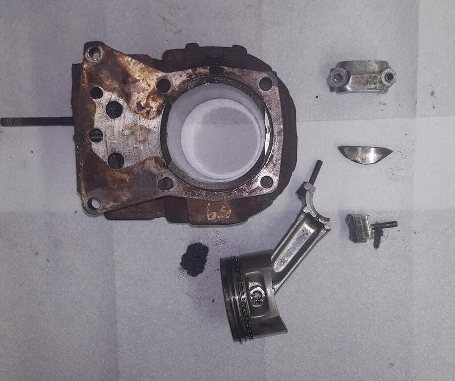

squonk 47,422 #15 Posted October 28, 2021 2 minutes ago, Gregor said: You scrapped? Multiple cracks, parts of cylinders gone, torn up cranks ect. 3 Share this post Link to post Share on other sites
