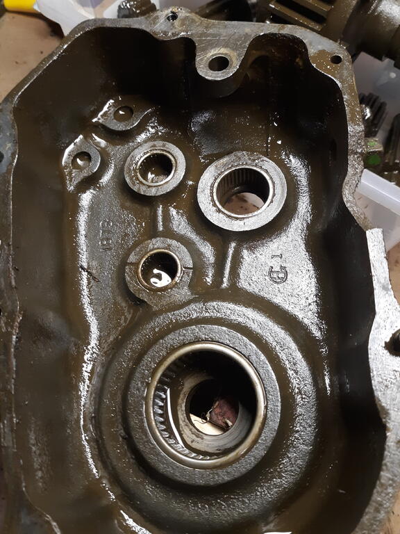

RetroMower 333 #17 Posted November 1, 2021 Well I split the tranny and it's not the absolute disaster I was wholly expecting. Besides the chocolatey goodness from mixing oil and water, I think being a gear oil box the bearings were somewhat protected. They are all intact and free. One of the large mains is a little stiff, but no missing gear teeth or any that are sharp. They will all be replaced regardless but I'm more hopeful its salvageable. The only real damage is one of the case ears is broken off but I think I can braze it. I just need to figure out which peerless tranny this is and get some gaskets and bearings. 1 Share this post Link to post Share on other sites
Handy Don 10,595 #18 Posted November 2, 2021 1 hour ago, RetroMower said: Can't see inside the differential yet, but so far these look remarkably clean! 1 Share this post Link to post Share on other sites
RetroMower 333 #19 Posted November 2, 2021 1 hour ago, Handy Don said: Can't see inside the differential yet, but so far these look remarkably clean! Yea this is after I wiped out a pound of sludge but I'll take it over serious damage. The differential feels smooth but I'll open it tomorrow and have more pics. Was wondering if these peerless transmissions were ever used by WH and if anyone here knows anything about them. 1 Share this post Link to post Share on other sites
Handy Don 10,595 #20 Posted November 2, 2021 4 minutes ago, RetroMower said: Yea this is after I wiped out a pound of sludge but I'll take it over serious damage. The differential feels smooth but I'll open it tomorrow and have more pics. Was wondering if these peerless transmissions were ever used by WH and if anyone here knows anything about them. I know they've been mentioned in posts. Do a search! 1 Share this post Link to post Share on other sites
