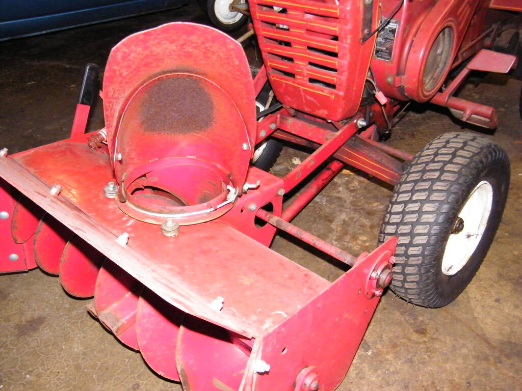

Jacob S 67 #1 Posted October 24, 2021 (edited) I got this new snowblower from Ed from the Wheel horse meet and greet and I was wondering where you attach the lift mechanism. I know it does not go to the lift arm that the mower deck goes to ,but the other one.I am confused how to get it there if anyone can help me that would be great. Edited October 24, 2021 by Jacob S Share this post Link to post Share on other sites

stevasaurus 23,857 #4 Posted October 24, 2021 Something is not right with the length of that bar coming off the blower. The lift bar. Usually is a 2 piece tube with one piece inside the other attached to your lift bar. Pulling back on your lift pushes the tube lifting the blower. Share this post Link to post Share on other sites
Jacob S 67 #5 Posted October 24, 2021 Thanks do you now any won who I could buy it off of Share this post Link to post Share on other sites

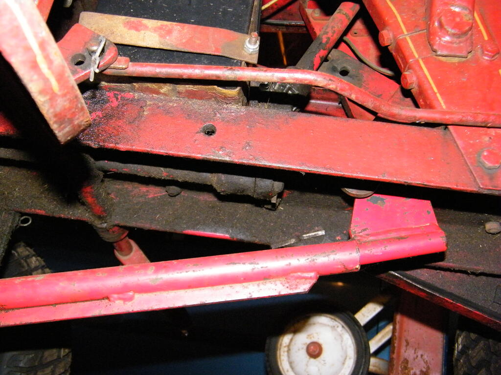

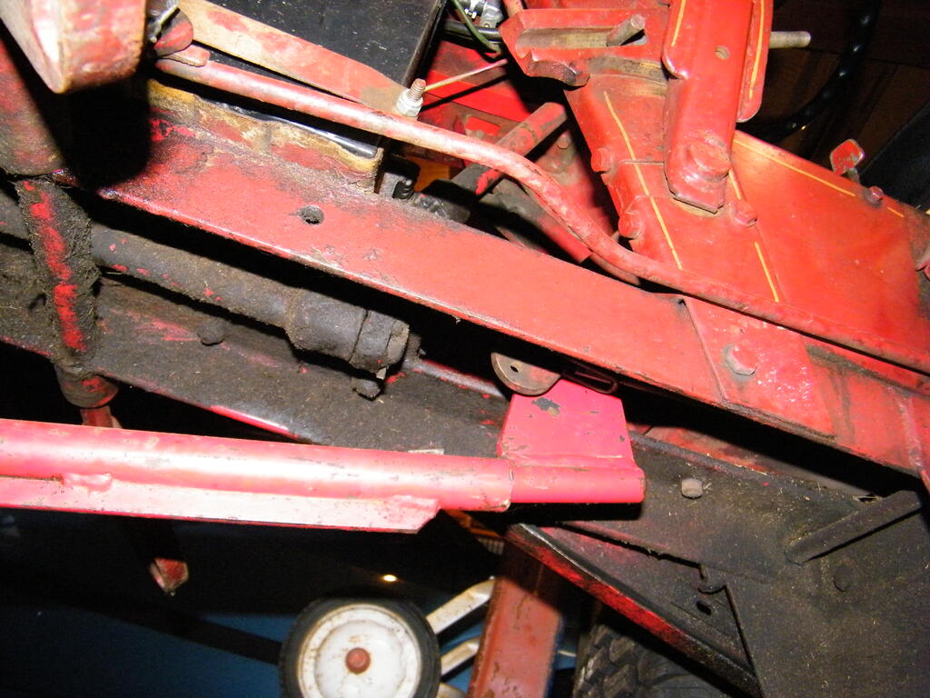

stevasaurus 23,857 #6 Posted October 24, 2021 My pictures are of a short frame tractor set up. I believe you can make that blower work with possibly some fabrication or the right lift tubing. Is there a model number on that blower?? What is the model number of your tractor?? Share this post Link to post Share on other sites

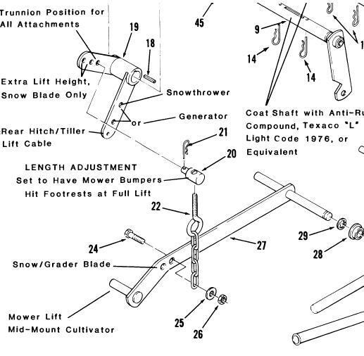

Ed Kennell 47,597 #8 Posted October 24, 2021 That blower appears to have the frame mounting kit, not the attach-a-matic. It should be bolted to the tractor frame rails using the long 3/8" bolt thru the existing holes at the front of the frame. The stepped bushings should be turned around with the small end fitting in the holes of the blower frame. As noted above, the push/lift bar shown is not factory. It may work with some altewration of it's length. It has to be attached to the correct hole as indicated in the above drawing. BTW, the side plate wings are installed backwards. The small front edge should be parralel to the sides of the blower so they slice into the snow. 1 Share this post Link to post Share on other sites
Jacob S 67 #9 Posted October 24, 2021 Thanks guys, it was free so I did not have high expectations for it but I will do everything to it like you guys said thank you again Share this post Link to post Share on other sites
Jacob S 67 #10 Posted October 24, 2021 So the snowblower goes through the frame but will we have to change the belt because I had it on the attached your Mattick and the belt had tension? Share this post Link to post Share on other sites
gwest_ca-(File Mod) 12,510 #11 Posted October 24, 2021 The GT-14 uses a 5/8" x 83" belt. I think you need a 5/8" x 69" belt. 1 Share this post Link to post Share on other sites
Ed Kennell 47,597 #12 Posted October 24, 2021 3 hours ago, Jacob S said: So the snowblower goes through the frame but will we have to change the belt because I had it on the attached your Mattick and the belt had tension? The belt in your picture is not routed correctly. After you move the blower rearward to the frame mounting holes, the belt will be loose. Then it will have to be routed around the two spring loaded tensioning pulleys. 1 Share this post Link to post Share on other sites
