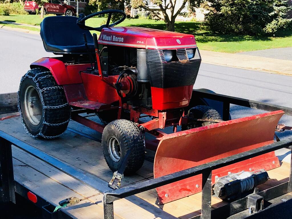

t_furl43 78 #1 Posted October 22, 2021 Hi, I’m a newer wheelhorse owner, I have an ‘85 314-A and I was wondering how difficult and if at all possible it was to swap the Eaton 700 that came with my 314-A for the bigger better Eaton 1100. TIA👍🏻 2 Share this post Link to post Share on other sites
Handy Don 16,918 #2 Posted October 22, 2021 (edited) Welcome to the Forum. This topic has been airing recently. One thread (which started as a 700 diagnostic and moved toward replacement with an 1100) is here but there are others (search for "Eaton 1100 700" in Topics) . Also, at the top of the page, under "Browse" is the Manuals section -- lots of good stuff there. Search with terms like "tractor" "312-A" and the year of your tractor. Likely the OM and IPL (Owner manual and illustrated parts list) are there. Another useful search is on the "Eaton Hydro" to see the various Eaton manuals so you can see what's relevant to you. The loaded pallet in the background of you picture is sure to get some comments, so be ready! Edited October 22, 2021 by Handy Don 2 1 Share this post Link to post Share on other sites

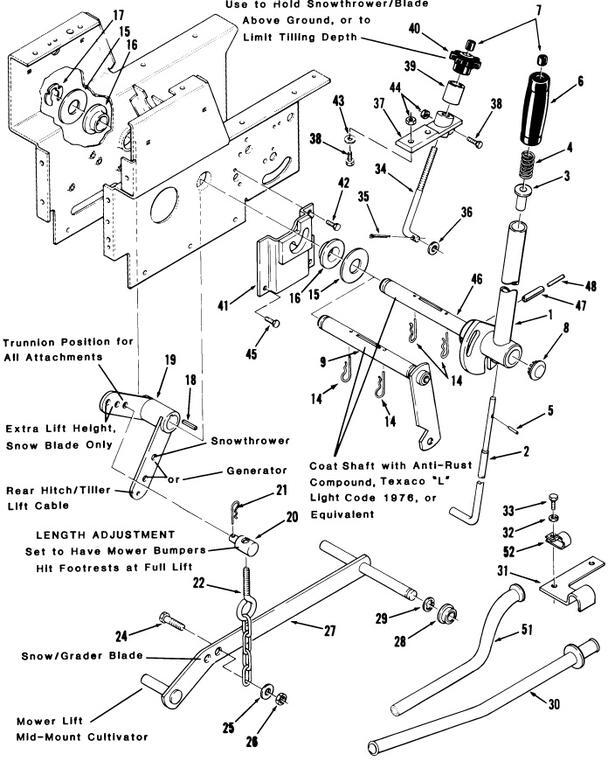

953 nut 67,290 #5 Posted October 22, 2021 Though the Eaton 1100 is stronger the 700 will get the job done for mowing and other normal chores. If you do decide to change over to the 1100 and want to use the hydraulic lift your biggest challenge will be changing rock shaft. Part #46 would be replaced by part #9 and pressed into part #19. However parts #19 and #46 tent to be "Brown Welded" (rusted) together. 3 Share this post Link to post Share on other sites
