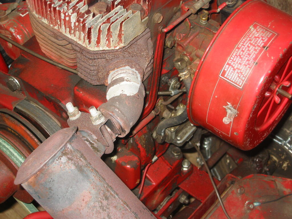

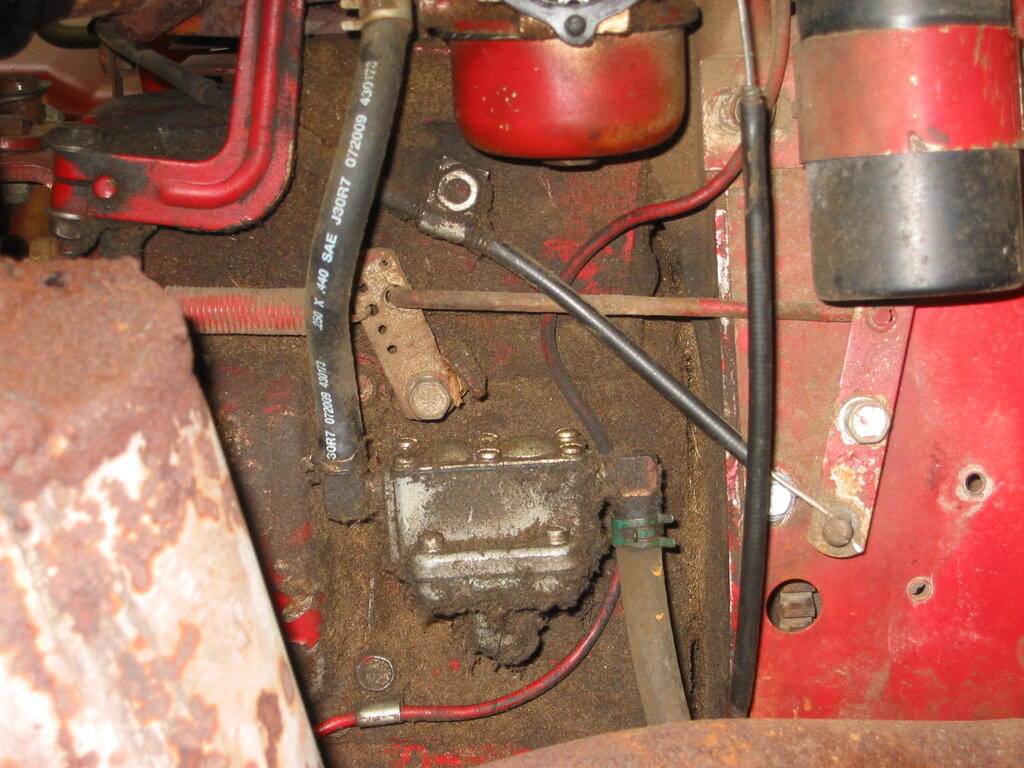

Achto 31,882 #3 Posted October 18, 2021 Here is the engine hook up. 2 Share this post Link to post Share on other sites

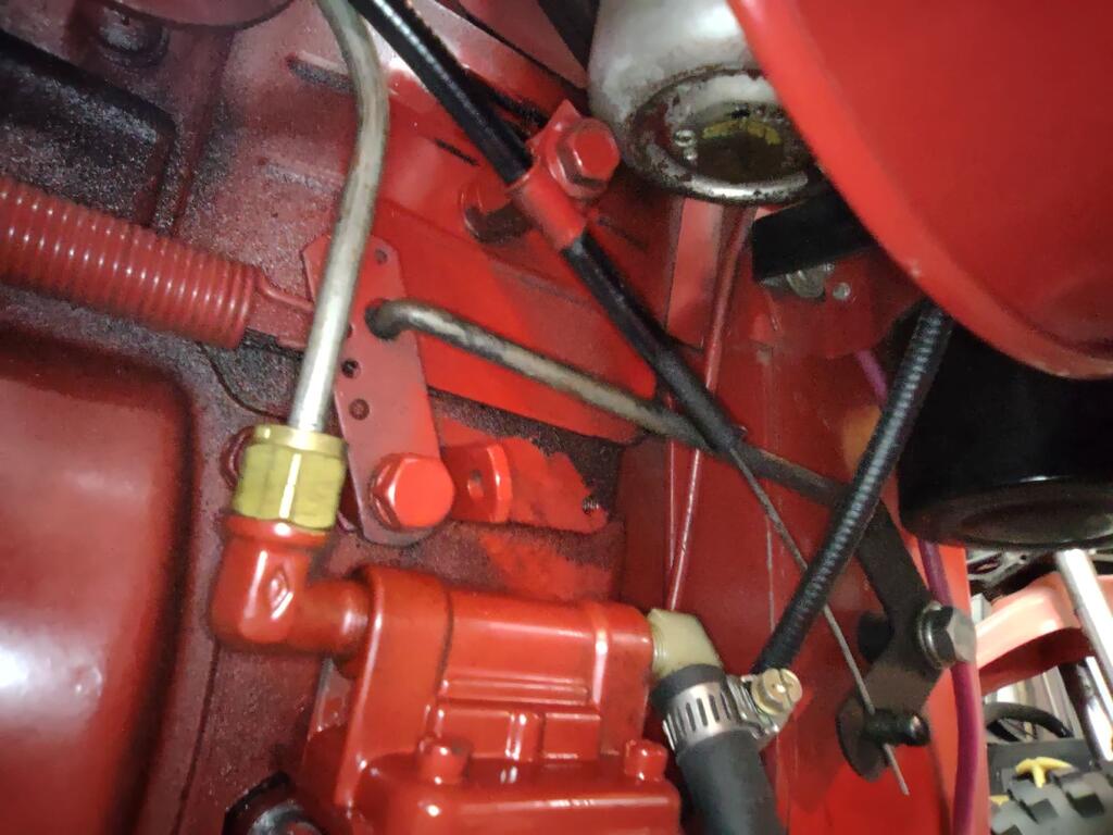

pfrederi 20,622 #4 Posted October 18, 2021 Welcome to Red Square. Choke cable stays on left side of engine goes down under blower shroud then up to the bracket then the carb. Throttle goes under exhaust pipe across front of engine (note the clamp holding it to the valve cover) 3 Share this post Link to post Share on other sites
Achto 31,882 #5 Posted October 18, 2021 24 minutes ago, Floyd Pink said: correct routing for choke The choke cable will go between the block and the bearing plate below the crank. Then up to the carb. 1 Share this post Link to post Share on other sites
Floyd Pink 44 #6 Posted October 19, 2021 9 hours ago, Achto said: The choke cable will go between the block and the bearing plate below the crank. Then up to the carb. Thank you so much. Rebuilding this. My Dad bought it new. Passed away before he could do it. 2 Share this post Link to post Share on other sites
