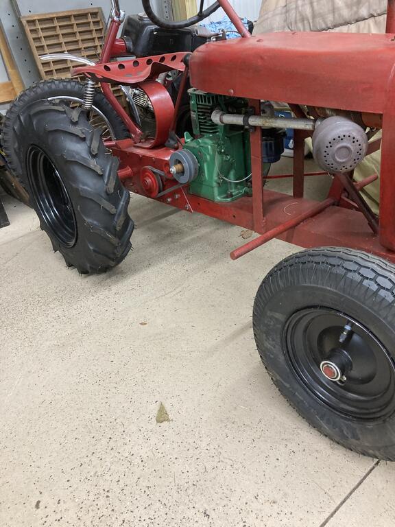

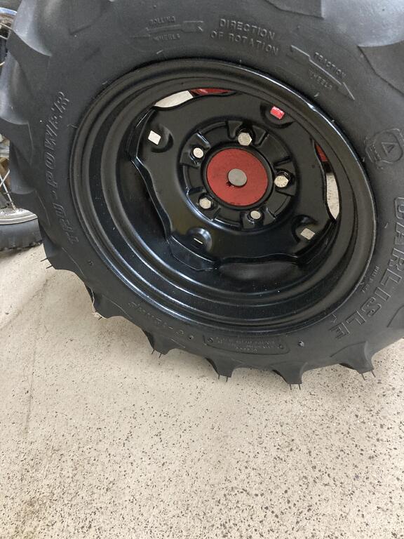

Frankenstein 58 213 #1 Posted October 17, 2021 Was just wondering if front and rear wheels had the valve stems facing in. I put mine back together how i received it as shown in pics. Thanks Share this post Link to post Share on other sites
stevasaurus 23,848 #2 Posted October 17, 2021 Valves are usually in on Wheel Horses. 1 Share this post Link to post Share on other sites
SylvanLakeWH 32,459 #3 Posted October 17, 2021 (edited) But… Easier to service on outside… Edited October 18, 2021 by SylvanLakeWH Share this post Link to post Share on other sites
Frankenstein 58 213 #4 Posted October 17, 2021 Original or practical hmm. Share this post Link to post Share on other sites
formariz 12,381 #5 Posted October 18, 2021 Offsets on wheels would be incorrect with valves facing out. Tractor will have a different footprint. From the back it will actually look silly since it will be skinny. Share this post Link to post Share on other sites
Lee1977 7,764 #6 Posted October 18, 2021 The both wheel are right .back inside for valve stem and wheel weights on the out side. The front doesn't have holes for wheel weights and the hub on the back side is longer then the one on the front. Share this post Link to post Share on other sites
Racinbob 13,135 #7 Posted October 18, 2021 I'd say it's a crap shoot. Likely dependent on which supplier they got that batch of wheels from. Take a look at the older brochures and you'll see that the fronts out are more common. The rears in win that one. Share this post Link to post Share on other sites
rj35hunter 309 #8 Posted October 19, 2021 Rear valve stems face inward and fronts face outward originally on all your round hoods…. Share this post Link to post Share on other sites
TJ5208 1,841 #9 Posted October 19, 2021 I dont like the stems on the outside to easy to break or step on Share this post Link to post Share on other sites
