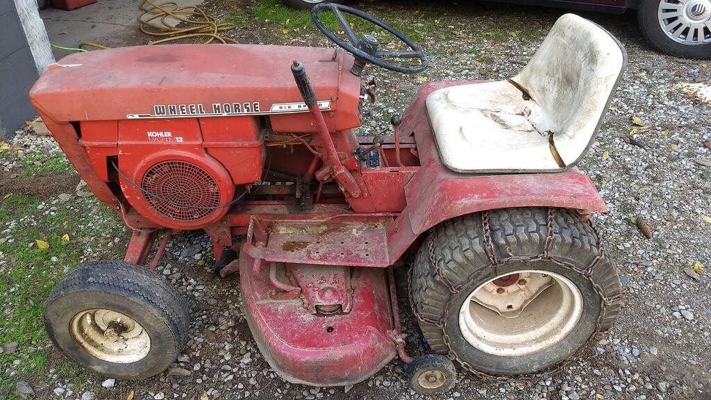

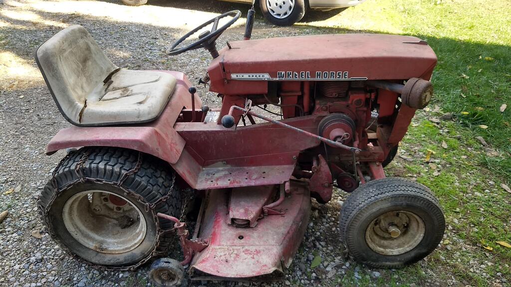

Don E 3 #1 Posted October 16, 2021 (edited) I know its a Wheel Horse. I know the engine is not the original. I'm new to red tractors. I've had and restored several of the older Sears Suburbans. This one found it's way to me and all the stickers have been painted over. The tires are dry and cracked but the engine and mower deck turn so I'm just wondering... Any Ideas about what this thing is? and what engine was on it originally? the starter spins if I jump it but doesn't engage the flywheel. ( probably why they quit using it) any thoughts or help would be appreciated. I don't really want to just get it running to use it as is. I'd rather restore it or pass it on to someone else that will... Don Edited October 16, 2021 by Don E more pics 3 Share this post Link to post Share on other sites
Maxwell-8 4,370 #2 Posted October 16, 2021 (edited) It has a M12 know, had a K-series originally or a tecumsh It is a short-frame, a 6speed, headlights. for sure a higher-end model 50 minutes ago, Don E said: the starter spins if I jump it but doesn't engage the flywheel. ( probably why they quit using it) any thoughts or help would be appreciated. typical problem here on Kohlers, the gear on the starter is stuck. take the front cover (engine shroud) off and see if the gear moves free on the shaft.(It should move in or out when you turn it) Got away with just some lube on that shaft. Edited October 16, 2021 by Maxwell-8 1 Share this post Link to post Share on other sites
echris 1,426 #3 Posted October 16, 2021 Agreed, when I bought my '89 310, the starter worked but was really noisy. A quick cleaning and a drop or two of light machine oil on the shaft and she's been fine since. Interesting retrofit of a Magnum to an older Charger? 1 Share this post Link to post Share on other sites

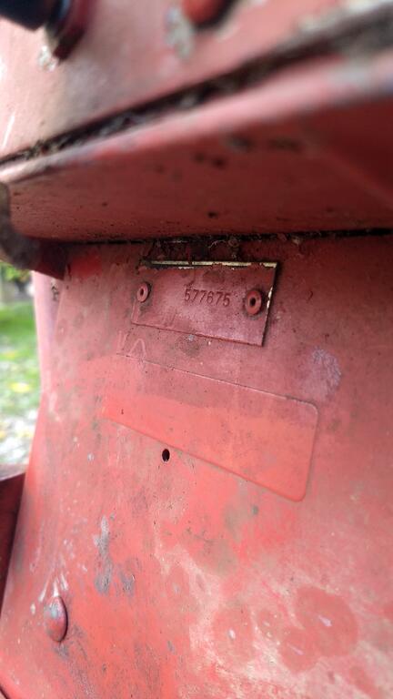

squonk 45,491 #4 Posted October 16, 2021 (edited) Look for an I'D' plate on the panel under the steering wheel. I'm going to say a Raider with a Magnum transplant Edited October 16, 2021 by squonk Share this post Link to post Share on other sites

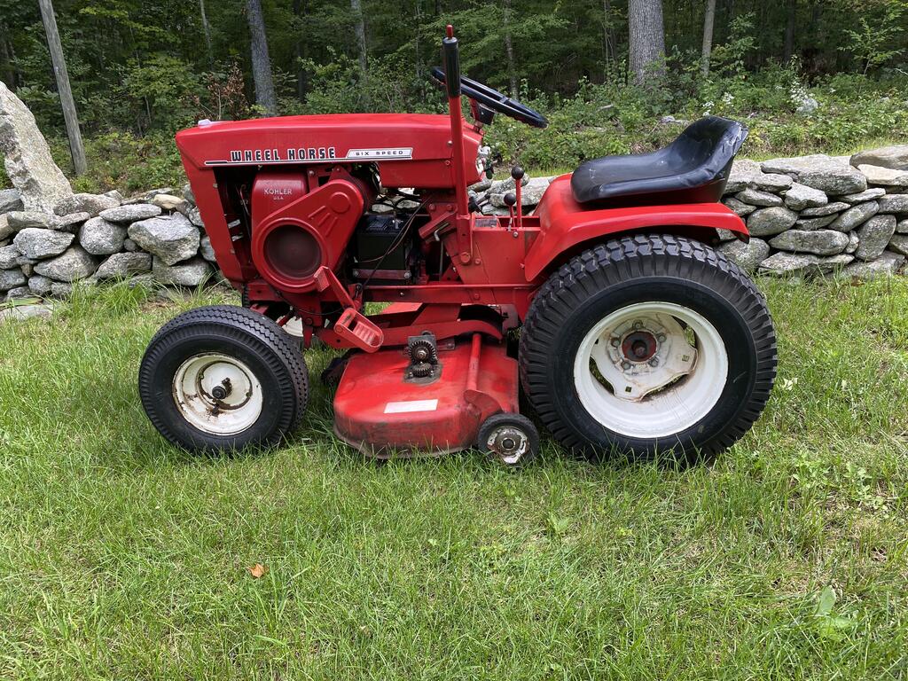

Sparky-(Admin) 24,621 #5 Posted October 16, 2021 It might be a 1967 model 867. This is mine, has the same decals. Share this post Link to post Share on other sites
Don E 3 #6 Posted October 16, 2021 8 minutes ago, squonk said: Look for an I'D' plate on the panel under the steering wheel. I'm going to say a Raider with a Magnum transplant I've got this. i thought it might be a serial number. is there more information under the paint if i could get it off without damaging what's underneath? Share this post Link to post Share on other sites
Don E 3 #7 Posted October 16, 2021 10 minutes ago, Sparky said: It might be a 1967 model 867. This is mine, has the same decals. thats a good looking machine! for sure. mine has different foot boards. but the lift, shifter and dash look the same. Share this post Link to post Share on other sites

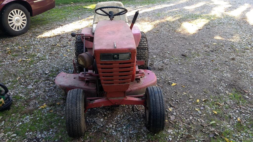

squonk 45,491 #8 Posted October 16, 2021 Tractor looks like a long frame. Look at the distance comparison to the front wheels to the front of the decks 2 Share this post Link to post Share on other sites
Don E 3 #9 Posted October 16, 2021 54 minutes ago, Maxwell-8 said: It has a M12 know, had a K-series originally or a tecumsh It is a short-frame, a 6speed, headlights. for sure a higher-end model typical problem here on Kohlers, the gear on the starter is stuck. take the front cover (engine shroud) off and see if the gear moves free on the shaft.(It should move in or out when you turn it) Got away with just some lube on that shaft. ive got an hh120 for it if that's an option. I'd kind of like it to be a little more like it was originally... Share this post Link to post Share on other sites

Herder 2,355 #11 Posted October 16, 2021 I love that style... Nothing wrong with having a Franken Horse and Magnums are good running engines. 2 1 Share this post Link to post Share on other sites
Howie 900 #12 Posted October 17, 2021 I was going to say it looks almost like my 69 Raider 12. Share this post Link to post Share on other sites
oliver2-44 11,212 #13 Posted October 17, 2021 4 hours ago, Don E said: I've got this. i thought it might be a serial number. is there more information under the paint if i could get it off without damaging what's underneath? Wet a cloth with lacquer thinner and you can gently wipe that medal plate and decal off 1 Share this post Link to post Share on other sites
oliver2-44 11,212 #14 Posted October 17, 2021 6 hours ago, Don E said: I know its a Wheel Horse. I know the engine is not the original. I'm new to red tractors. I've had and restored several of the older Sears Suburbans. This one found it's way to me and all the stickers have been painted over. The tires are dry and cracked but the engine and mower deck turn so I'm just wondering... Any Ideas about what this thing is? and what engine was on it originally? the starter spins if I jump it but doesn't engage the flywheel. ( probably why they quit using it) any thoughts or help would be appreciated. I don't really want to just get it running to use it as is. I'd rather restore it or pass it on to someone else that will... Don There should be a "Name" decal on the metal part under the "six speed" decal, if its still there Share this post Link to post Share on other sites
Maxwell-8 4,370 #15 Posted October 17, 2021 10 hours ago, squonk said: Tractor looks like a long frame. Look at the distance comparison to the front wheels to the front of the decks I said it because in my raider, the kohler M12 looks a lot less cramped in there. But haven't seen a short frame in person. very rare over here. Share this post Link to post Share on other sites
953 nut 64,086 #16 Posted October 17, 2021 The serial number on your indicates it is a 1969 Raider Model 1-6041. As usual, @gwest_ca was spot on. 1 Share this post Link to post Share on other sites
squonk 45,491 #17 Posted October 17, 2021 (edited) 14 hours ago, squonk said: Look for an I'D' plate on the panel under the steering wheel. I'm going to say a Raider with a Magnum transplant 23 minutes ago, 953 nut said: The serial number on your indicates it is a 1969 Raider Model 1-6041. As usual, @gwest_ca was spot on. Me too! Well I didn't have the year. Days seem like weeks now. Edited October 17, 2021 by squonk Share this post Link to post Share on other sites

Don E 3 #19 Posted October 17, 2021 2 hours ago, 953 nut said: The serial number on your indicates it is a 1969 Raider Model 1-6041. As usual, @gwest_ca was spot on. so apparently this is an early Raider 10. ( thanks everyone for your resourcefulness) That means it probably had a Techumseh on it right? I have one of those😎 Share this post Link to post Share on other sites

Don E 3 #22 Posted October 17, 2021 16 hours ago, oliver2-44 said: Wet a cloth with lacquer thinner and you can gently wipe that medal plate and decal off I did just that and confirmed the 1-6041 underneath the red paint. Share this post Link to post Share on other sites
