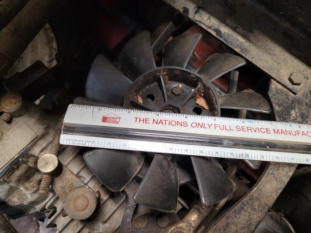

DennisThornton 4,773 #1 Posted October 16, 2021 Got a really nice 264 in too good a shape to not fix. Starts and runs great but won't move by itself. However, the brake drum rotates! Doesn't make much noise in either direction. Got a pretty nice 265 with a solid 52" recycler that I'd really like to fix too. Wouldn't start but after dumping out some black crap and completely going through the fuel system she starts and runs good, but it wouldn't move forward or backward either! Belt was off! Whoopi!! Put that back on and she moved! Until the fan and pulley popped off! C-clip was gone and the splines were so wobbled off the pulley it wouldn't even stay centered. Pulled the pulley off the 264, belt back on and drove it out of the shop. Had some issues with the deck but got those fixed and I was ready to mow! Well, she moves but not very fast and not up hill... It's hard for me to believe that someone used this until the pulley popped off if the trans would barely move itself. I don't see any leaks. Fluid level is ok. Pretty sure the belt is properly routed. I'd consider buying another tractor to get a good K61 or perhaps rebuilding these. There's an eBayer that refurbs the worn parts for under $200. Both of these tractors are worth spending some time and money on. I'd just hate to be overlooking something simple, but I'm mostly lost when it comes to hydros. Watched several vids and it seems these can be rebuilt by mere mortals though without special tools. Share this post Link to post Share on other sites

JoeM 9,937 #3 Posted October 16, 2021 Den I had a K58 in a JD and the axle seals leaked. They call them none serviceable but they really are serviceable. I cant find the disassembly procedure from the website link I used, they changed it. I hear tell the oil usually is the issue needing changed. The oil in mine was coal black at 300 hours and the intake screen needed washed. They have a vent, a black rubber cap on top of the rear of the transmission. Fill with oil until it is one inch from the top of the case, measured at the vent hole. Link to their troubleshooting guide and I did find my oil type chart. Post or send me a pic of that pulley with measurements, I have one off of a toro hydro not sure it is the same. https://tufftorq.ordertree.com/media/promo/TuffTorq/Troubleshooting.pdf Fluids and Lubricants Transmission John Deere.pdf 300 hour Tuff Torq Dirty OIL Share this post Link to post Share on other sites

DennisThornton 4,773 #6 Posted October 17, 2021 12 hours ago, JoeM said: Nope nothing. Like I used to tell my guys "it ain't no good the way it is now!" Keep us in the loop. Take some pics of the magnets Magnets? Pulley is 5" OD. Share this post Link to post Share on other sites

JoeM 9,937 #11 Posted October 19, 2021 Pulley, same size wrong shaft configuration. This one is keyed and has a retaining bolt. Share this post Link to post Share on other sites
DennisThornton 4,773 #12 Posted October 19, 2021 4 hours ago, JoeM said: Pulley, same size wrong shaft configuration. This one is keyed and has a retaining bolt. Maybe a newer improved model! But alas, no fittee... Thanks for checking! Also tips me off if I search for a new or old one. Probably going to move this 265 out for now. More pressing repairs WITH PARTS await. Thanks again! Share this post Link to post Share on other sites
