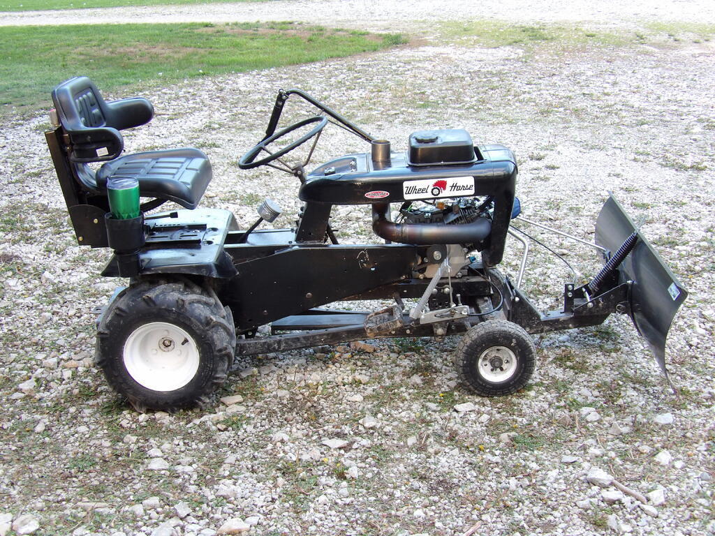

Lee1977 7,764 #74 Posted October 16, 2021 On 10/14/2021 at 8:03 PM, Snoopy11 said: Here is an old picture, just in case you guys need to verify the three bolt triangle... Don Check the bolts on that wheel they look to be equally space. The round hoods use the standard 12" wheel 5 holes on 4.5" circle. Share this post Link to post Share on other sites
Lee1977 7,764 #75 Posted October 16, 2021 On 10/14/2021 at 8:03 PM, Snoopy11 said: Here is an old picture, just in case you guys need to verify the three bolt triangle... Don Check the bolts on that wheel they look to be equally space. The round hoods use the standard 12" wheel 5 holes on 4.5" circle. 1 Share this post Link to post Share on other sites
