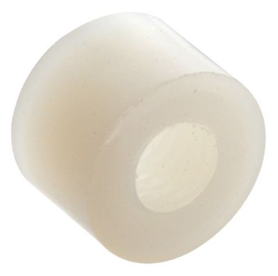

Snoopy11 5,731 #26 Posted October 15, 2021 At first, I was thinking about something like this... which I have in the shop now... dunno what you guys think? Don Share this post Link to post Share on other sites
ebinmaine 78,114 #27 Posted October 15, 2021 2 minutes ago, Snoopy11 said: I did buy some longer 3/8 -24 bolts yesterday as well! So... I am prepared to do... something... Don Just remember whatever you put in there for extra length is going to add extra leverage. Just now, Snoopy11 said: When you say: What exactly are you talking about... like steal... nylon spacers...etc.? Don I suppose there's multiple materials that would work just fine but I would lean towards steel just because of the ruggedididity. The others might be able to chime in. I want to call em machine bushings or something. Basically like a really thick fat washer that's all one solid piece of material. Share this post Link to post Share on other sites
ebinmaine 78,114 #28 Posted October 15, 2021 Just now, Snoopy11 said: At first, I was thinking about something like this... which I have in the shop now... dunno what you guys think? Don That's what I was thinking of but made out of steel Share this post Link to post Share on other sites

Snoopy11 5,731 #39 Posted October 15, 2021 Eb, I am thinking something like this... Don 1 Share this post Link to post Share on other sites
roadapples 6,987 #40 Posted October 15, 2021 (edited) 4 minutes ago, Snoopy11 said: Whatchya mean? Don You said that about having spacers made Edited October 15, 2021 by roadapples 1 Share this post Link to post Share on other sites
ebinmaine 78,114 #41 Posted October 15, 2021 Just now, Snoopy11 said: Eb, I am thinking something like this... Don Yeah that's what I had in mind. Largest outside diameter you could use without interference and smallest possible inside diameter to prevent movement as much as you can. Share this post Link to post Share on other sites
