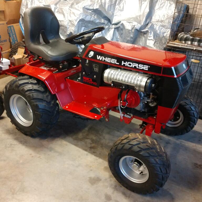

WheelhorseBob 1,550 #4 Posted October 14, 2021 (edited) Never heard of that paint. Interesting. That being said I’ve settled on IH red. I believe the Ponds did as well. My C161 project in IH Red. Edited October 14, 2021 by WheelhorseBob 2 Share this post Link to post Share on other sites

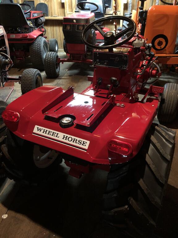

kpinnc 17,149 #5 Posted October 14, 2021 (edited) If you look closely at this tractor, you'll see some changes in red from one part to the other. The front axle is the most obvious, and I'm OK with that. Best I can tell, there are 6 different reds here. This tractor has been in several different stages of work over nearly 10 years due to life being what it is sometimes. I had to set it aside for a long time and get back when I finally could. Point being, don't let anyone tell you what Wheel Horse red is. The simple fact is that none of us know, and anyone who says so is speculating or repeating what someone else speculated. The official colors changed multiple times over the years, and Wheel Horse was notorious for using whatever parts they had on hand at the time. No reason to think paint was any different. Now in my opinion, and that is all it is- for rattle cans, Rust-Oleum Farm and Implement IH Red. It sprays decent, covers well, and has excellent gloss content. And contrary to the masses, regular Rust-Oleum Sunrise Red is decent, even if slightly more orange. When I have no other options, Regal Red is fine too. Side by side on different parts, it's hard to see much difference. These are tractors, not Lamborghinis. Edited October 14, 2021 by kpinnc 2 Share this post Link to post Share on other sites
