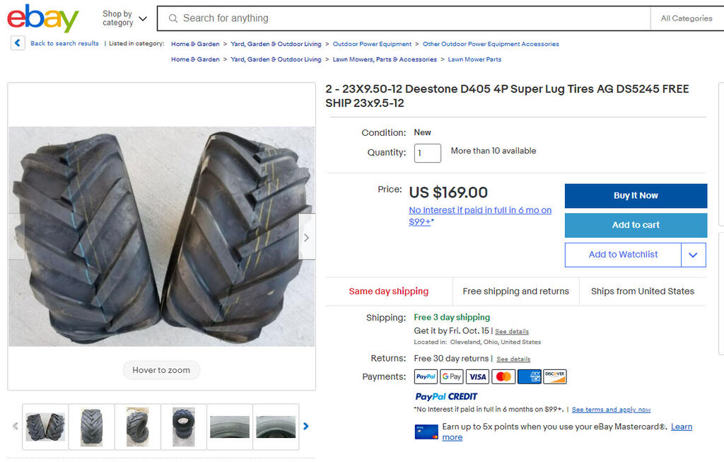

JoeM 10,093 #8 Posted October 13, 2021 5 hours ago, Pullhosen’s Pony Express said: I’d suggest for the 10.5 wide tire, it’ll be closer to 8.5” wide overall and a good price Used them on a FEL, worked them hard no issues. If you have a nail issue, go tubeless so you can plug them on the machine. 2 - 23X10.50-12 Deestone D405 4P Super Lug Tires AG DS5245 23x10.5-12 US $129.00 Shipping: $21.85 Standard Shipping | See details Located in: Cleveland, Ohio, United States 2 Share this post Link to post Share on other sites

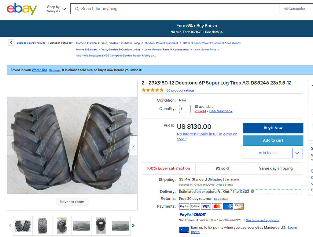

Snoopy11 5,731 #11 Posted October 19, 2021 Yeah, I know that you probably already ordered tires, that is perfectly fine. But for guys who want a different option... Greater Cleveland Tire offers these VERY good tires... Don Share this post Link to post Share on other sites
Snoopy11 5,731 #12 Posted October 19, 2021 Just for anyone else who comes along and reads this thread... 'cause you know they will! Don Share this post Link to post Share on other sites
