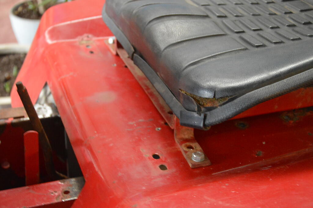

Handy Don 17,634 #133 Posted February 22, 2022 (edited) 3 hours ago, Maxwell-8 said: Since the steering wheel moved back due to the dash lift, I moved the seat back. moved the seat support under the frame back an drilled new holes in the fender. I will have to gap weld the original holes in the seat pan. It is much more comfortable with my long legs, since the pedals are now further from me. We have users who are 1.5 - 1.9 m tall (60-75"). I installed a set of seat sliding rails similar to these and made everyone happy and safer operators! Edited February 22, 2022 by Handy Don 2 1 Share this post Link to post Share on other sites

Maxwell-8 4,371 #137 Posted February 23, 2022 12 hours ago, Handy Don said: We have users who are 1.5 - 1.9 m tall (60-75"). I installed a set of seat sliding rails similar to these and made everyone happy and safer operators! I am 73" but have legs similar to someone how is 78" Helps out with those karate moves But in cars, I often have to choose between, comfortable legs or being able to reaching the steering wheel and bang my knees into the dash. 1 Share this post Link to post Share on other sites

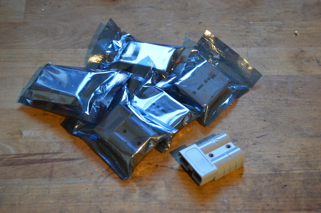

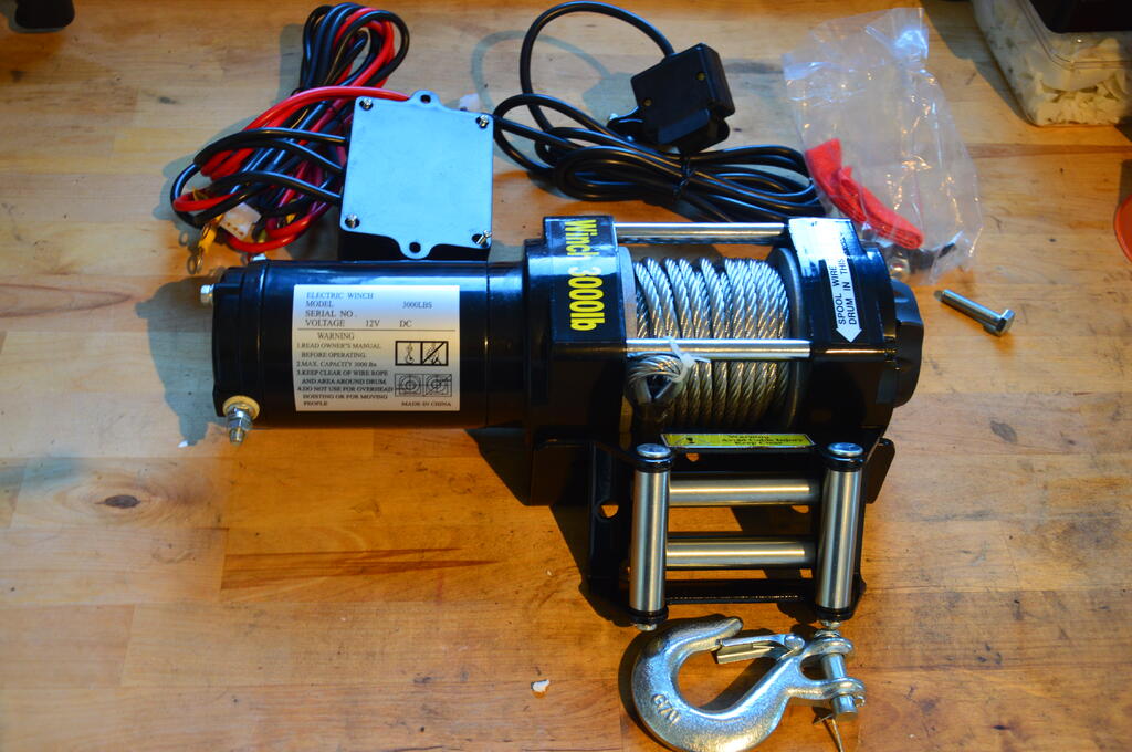

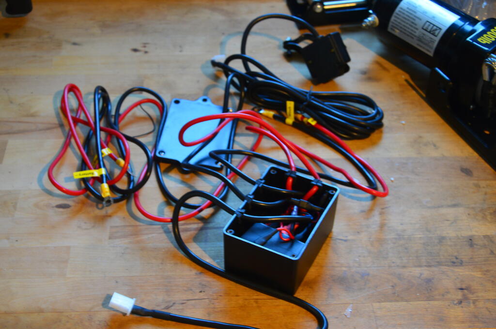

Maxwell-8 4,371 #138 Posted February 23, 2022 (edited) So the winch arrived. Nice thick cable, wiring I am not the biggest fan so will probably change out the cables with thicker ones. With insolation they are 0.19" the 4.8 grade hardware will be trown a out and replaced by 8.8 grade at least. The winch is 10cm (3.8") high so that gives me just enough room for hood hinges. I am going to paint the winch in red as well. And I went with 50A connectors, they aren't as bulky, But yet I believe they are going to be able to do most if not all of the temporarily accessories I plan on running. Like lights on a trailer, etc. Edited February 23, 2022 by Maxwell-8 6 1 Share this post Link to post Share on other sites

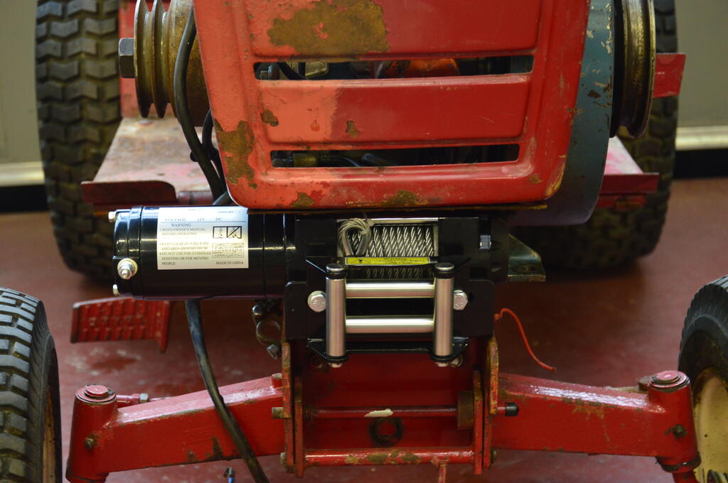

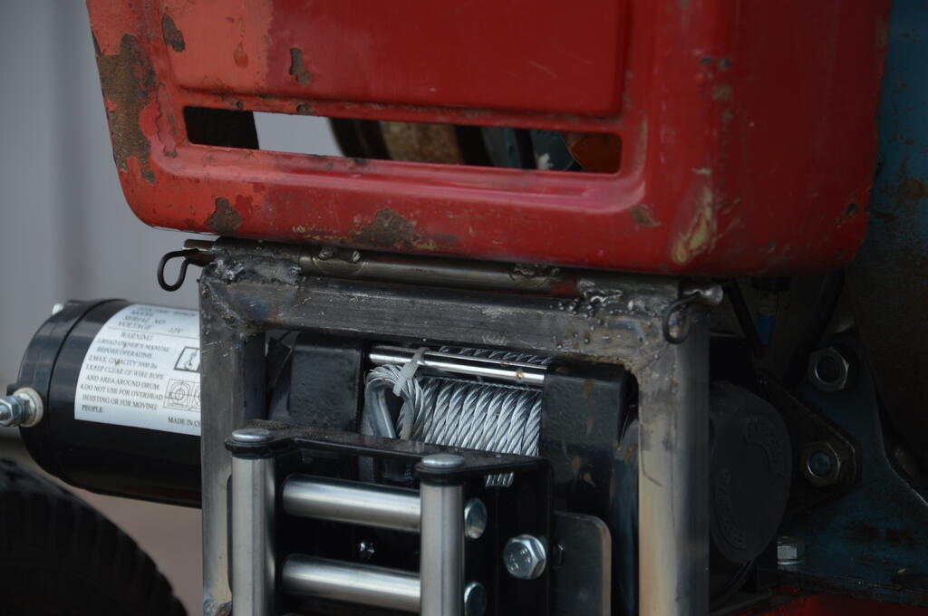

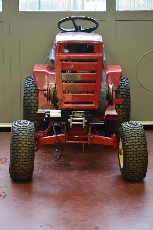

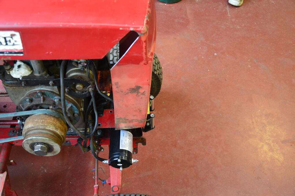

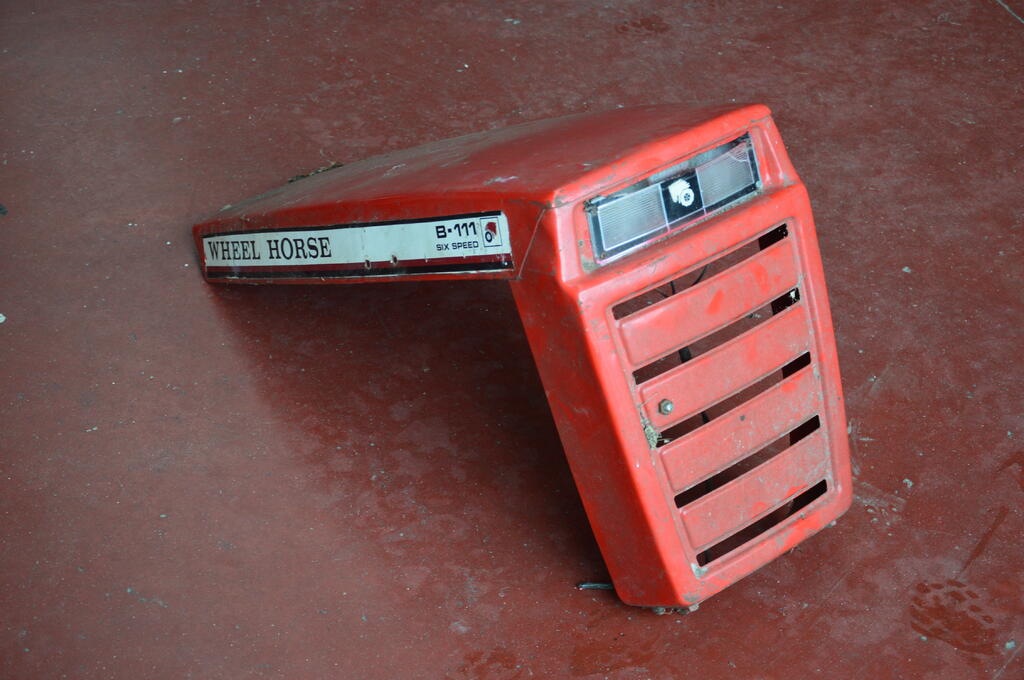

Maxwell-8 4,371 #139 Posted February 24, 2022 The previous owner of the C-175-8 gave me this hood from a B-111. I good use it to make my hood taller. But the winch looks good too., I am not sure if the tires would clear the winch sticking out. Would be close for sure! 3 1 Share this post Link to post Share on other sites
ebinmaine 81,047 #140 Posted February 24, 2022 It's your build and all so you do exactly what you want to. I would leave that winch right where it is. I think it's an excellent add-on in the position that it is and it won't interfere with anything. 2 1 Share this post Link to post Share on other sites
SylvanLakeWH 32,776 #141 Posted February 24, 2022 1 Share this post Link to post Share on other sites
Pullstart 71,482 #142 Posted February 24, 2022 I concur with the masses. It looks great where it is, but it’s your build ultimately! 1 Share this post Link to post Share on other sites
19richie66 17,937 #143 Posted February 24, 2022 I see no issue 😎 1 Share this post Link to post Share on other sites
Handy Don 17,634 #144 Posted February 24, 2022 Innovative placement. Keeping the spool centered is wise, in my opinion. If you have the ability to duplicate the hinge built into the attachamatic, so much the better (or cut up a donor?) 1 Share this post Link to post Share on other sites
Maxwell-8 4,371 #145 Posted February 24, 2022 21 minutes ago, 19richie66 said: I see no issue 😎 I am going to test tomorrow if the 20x10-8 tire will clear the winch They should but will be close Time for me to get those rims sandblasted, painted and tires mounted. Thanks everyone for your input. 1 Share this post Link to post Share on other sites
Snoopy11 5,731 #146 Posted February 25, 2022 May I give a late vote? I LIKE THE WINCH!!! Don 1 Share this post Link to post Share on other sites
