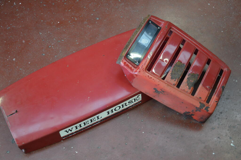

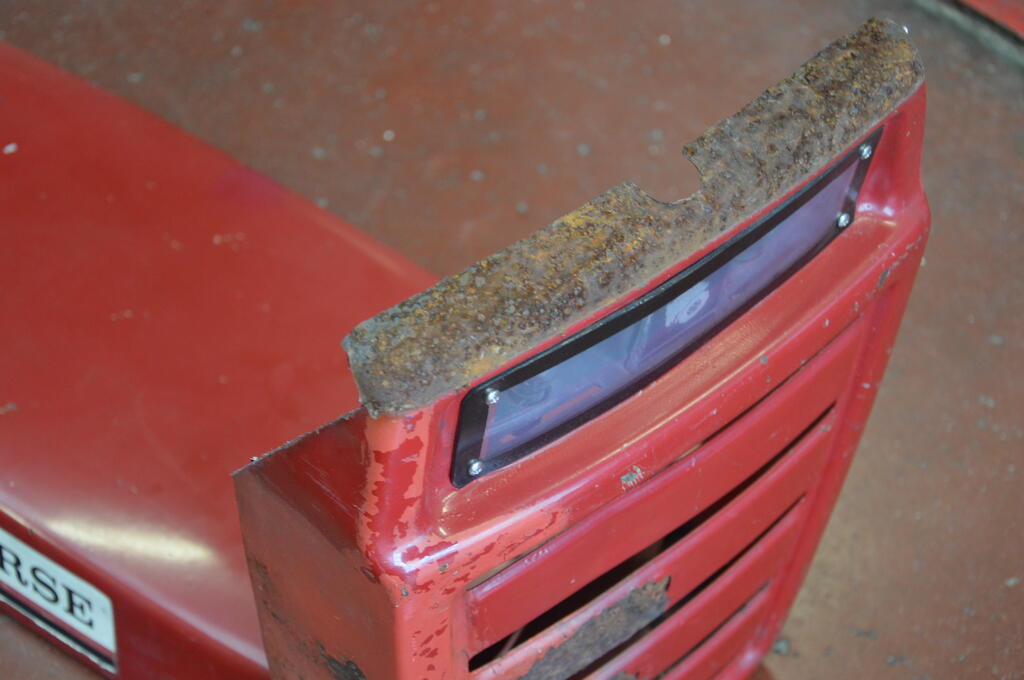

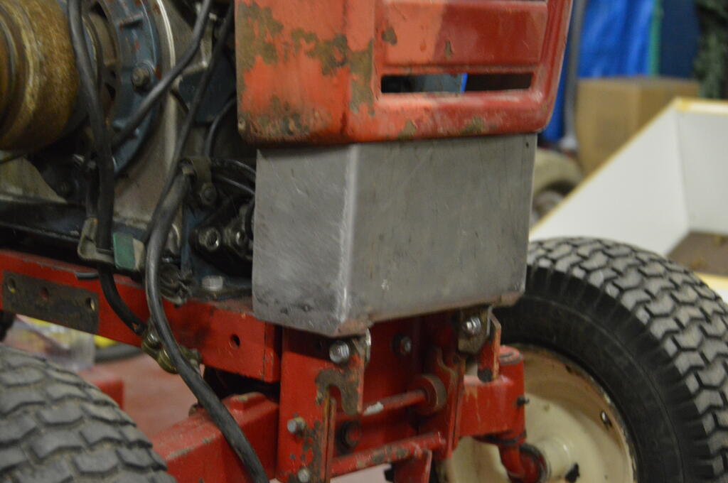

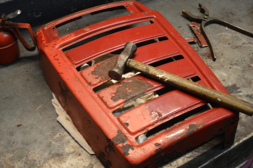

Maxwell-8 4,371 #105 Posted February 18, 2022 The hood was coming in contact with the engine so I wanted to change the angle between the front and the top part of the hood. Before I knew it, it was in two pieces. Found a pretty rusted section, something I wouldn't have noticed in a 'normal restauration' Does make it easier to get all the dents out and now it will fit in the sand-blast cabinet 3 2 Share this post Link to post Share on other sites

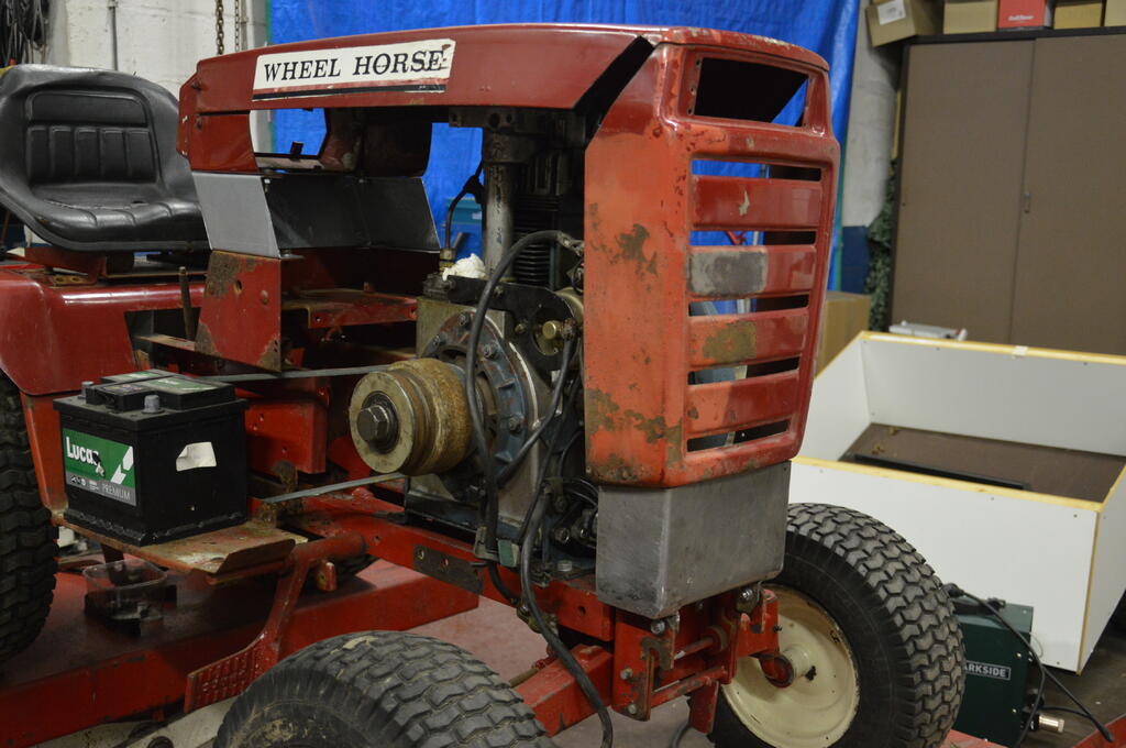

Maxwell-8 4,371 #106 Posted February 18, 2022 Went on raising the hood in the front about 5" I was afraid of the result, but I thinks it came out decent. Would you have done it different? 3 2 Share this post Link to post Share on other sites
sjoemie himself 3,178 #107 Posted February 18, 2022 Looks pretty good, could use some details to break it up a bit. 1 Share this post Link to post Share on other sites
ebinmaine 80,439 #108 Posted February 19, 2022 4 hours ago, Maxwell-8 said: done it different 4 hours ago, sjoemie himself said: Looks pretty good, could use some details to break it up a bit. Maybe cut a slot or two in it? 2 Share this post Link to post Share on other sites

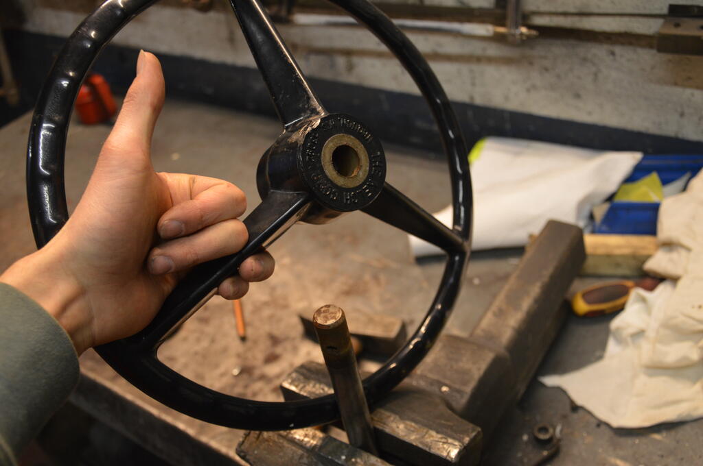

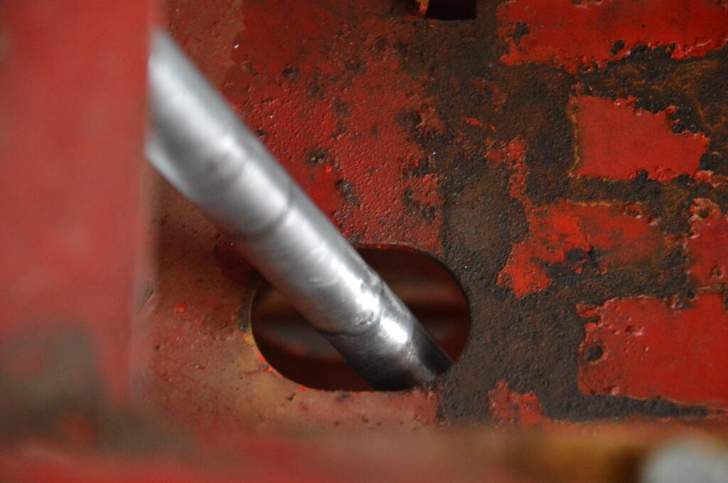

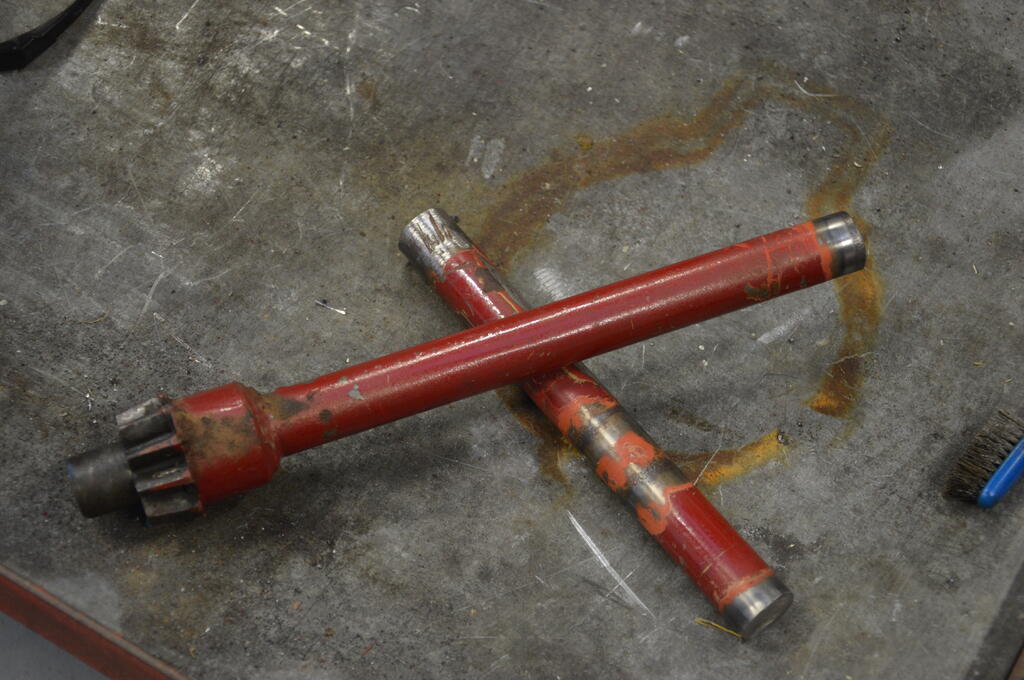

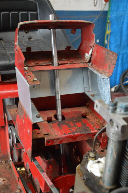

Maxwell-8 4,371 #109 Posted February 20, 2022 Still tinkering what I am going to do with the front hood bracket I went on, raising the steering wheel. I had to cut the steeringwheelshaft anyway so I did it while still in the tractor. That way I could use the vise to get the steering wheel off. It went off with a breeze! I am using all recycled materials I had 3 different pieces so I was scared about it not ending up all strait, used the vise and a yardstick. welding it in the vise so it wouldn't warp. Came out as strait as can be! I was surprised as well and the fitment came out great too! 3 Share this post Link to post Share on other sites
sjoemie himself 3,178 #110 Posted February 20, 2022 Steering shaft came out good Maybe for the front you could make somekind of front weight like Schlüter had on their tractors. https://i.ebayimg.com/00/s/MTIwMFgxNjAw/z/16cAAOSwj7hgjp9A/$_35.JPG 1 1 Share this post Link to post Share on other sites

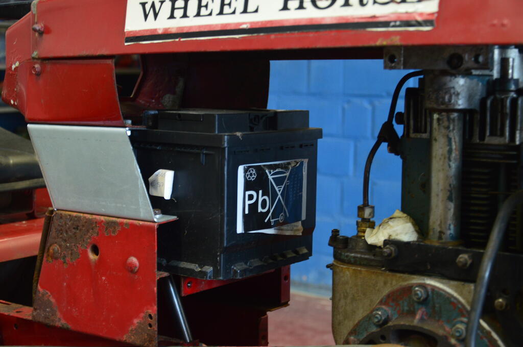

19richie66 17,932 #113 Posted February 21, 2022 What if you made a winch mount/box that would also be your hood stand? (Where your spacer box is now) The winch would be mounted directly below the front of the hood to the frame for strength and place your battery in a box that is held in the Attachamatic bracket below it. 1 1 Share this post Link to post Share on other sites

Maxwell-8 4,371 #118 Posted February 21, 2022 Just ordered the winch. 3000lbs is enough, don't think I will ever be over 1000lbs, and I can always use a ****** block for pulling out other things. And this one fitted just in between the hood and the frame. It's going to be one of the very few Chinese made parts on this build. Payed 80$ which is a steal, most stores ask at least double. Didn't want to spend $xxx for a small winch, I only going to use a few times. Went with the one that had thicker steel cable (7/32"), heck for those few dollars, and the other one was 4 months on backorder Specs: (Ratio 153:1; power: 1KW / 1.34CV (12v); cable: 5.5mm x 9.2m; Dimensions 32x13x11cm) Powerusages Load Kilo 0 454 907 1361 Speed m/min 3.2 2.3 1,3 0,7 Power Amp 10 40 90 145 Are there any things I have to know about this winches? Lookouts, maintenance, possible problems, improvements ? The wires do look thin for a 145 amp device 1 1 Share this post Link to post Share on other sites
Snoopy11 5,731 #119 Posted February 21, 2022 (edited) 9 minutes ago, Maxwell-8 said: Are there any things I have to know about this winches? Lookouts, maintenance, possible problems, improvements ? The wires do look thin for a 145 amp device Well, I think it is 145 amp MAX draw... so I don't see to many problems with wiring there. It looks like maybe 12-14 gauge wires on there... hard to tell. Anyway, I do know that if the motor ever failed, you can buy a replacement for less cost, which is a plus. And, I would keep some kind of protectant on the cable, as it will rust... (i know how you are about rust...) Don Edited February 21, 2022 by Snoopy11 spelllllling 1 1 Share this post Link to post Share on other sites
Maxwell-8 4,371 #120 Posted February 21, 2022 9 minutes ago, Snoopy11 said: And, I would keep some kind of protectant and the cable, as it will rust... (i know how you are about rust... Maybe @peter lena has some ideas on that. Share this post Link to post Share on other sites
peter lena 10,029 #121 Posted February 21, 2022 @Maxwell-8 when you get that winch , fully extend the cable and use a cable and open gear lubricant on it as you pull it back on with load , that will flex and draw the lubricant into the cable windings , insuring lubrication and stopping rust , don,t ask me how i know this , pete 2 Share this post Link to post Share on other sites

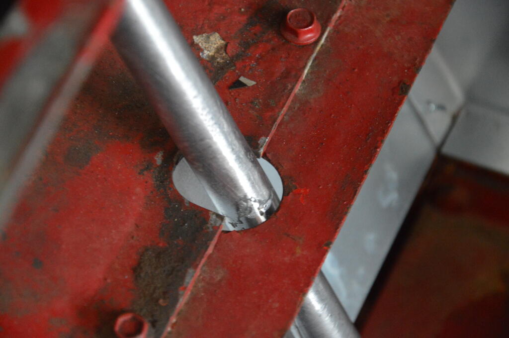

Maxwell-8 4,371 #122 Posted February 22, 2022 (edited) Since the steering wheel moved back due to the dash lift, I moved the seat back. moved the seat support under the frame back an drilled new holes in the fender. I will have to gap weld the original holes in the seat pan. It is much more comfortable with my long legs, since the pedals are now further from me. Edited February 22, 2022 by Maxwell-8 2 1 Share this post Link to post Share on other sites
