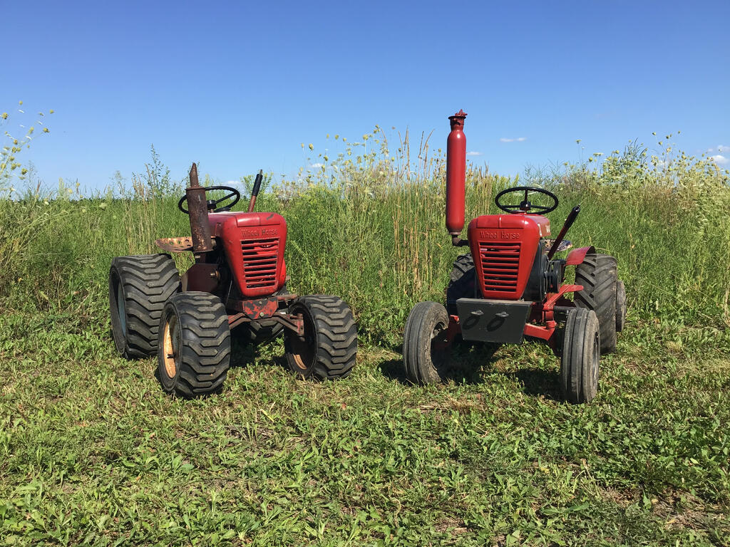

Achto 32,435 #55 Posted November 27, 2021 (edited) The hood hinge that I made for Radpferd is a full 3" taller. I also extended the dash tower 3". This basically raised the whole hood straight up to give clearance for the engine. I got my clearance measurements by setting a 3/4" thick piece of wood on top of the engine, setting the hood on that and measured to see how far to raise the hood. Edited November 27, 2021 by Achto 3 3 Share this post Link to post Share on other sites

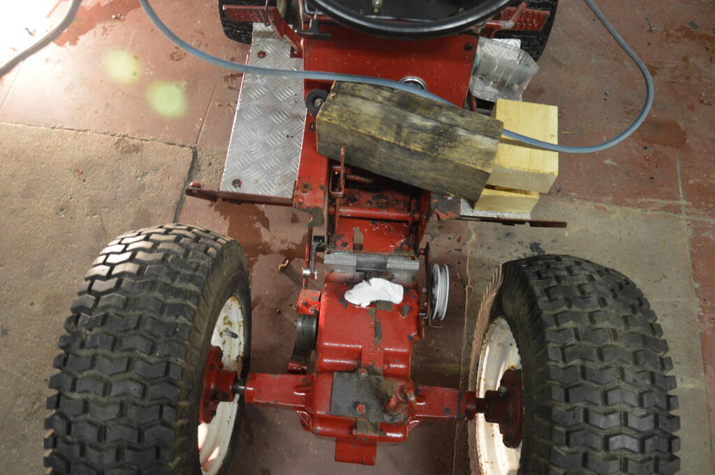

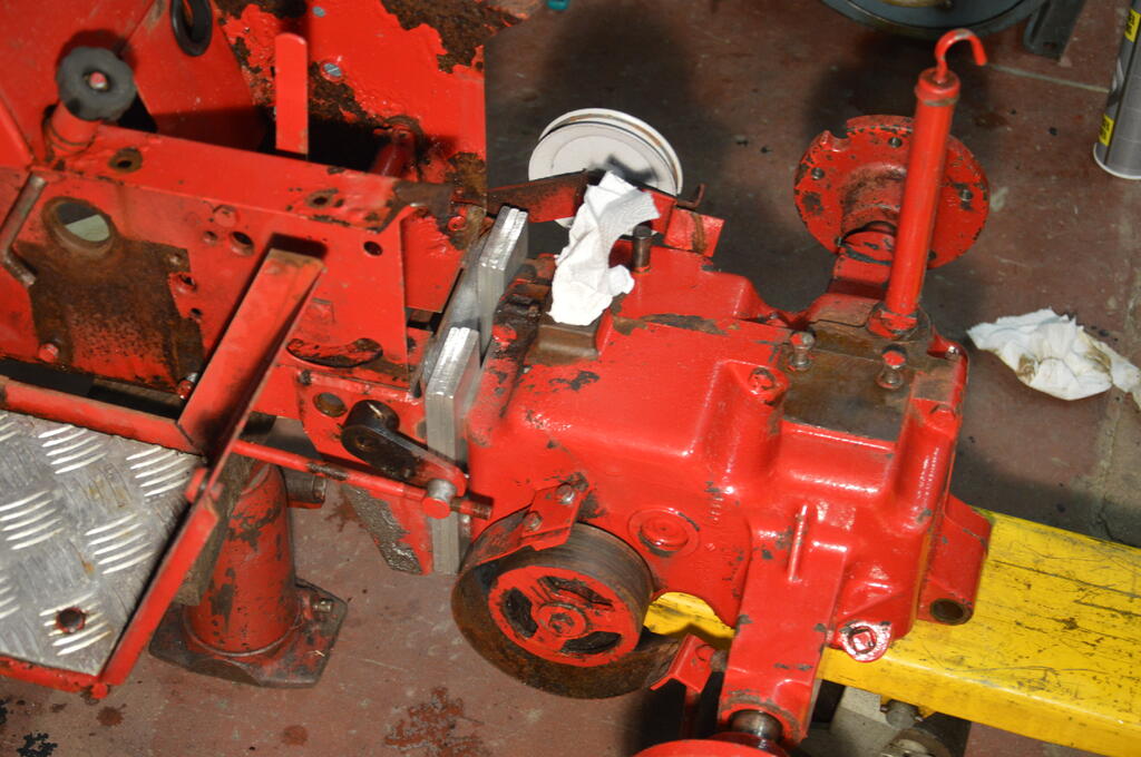

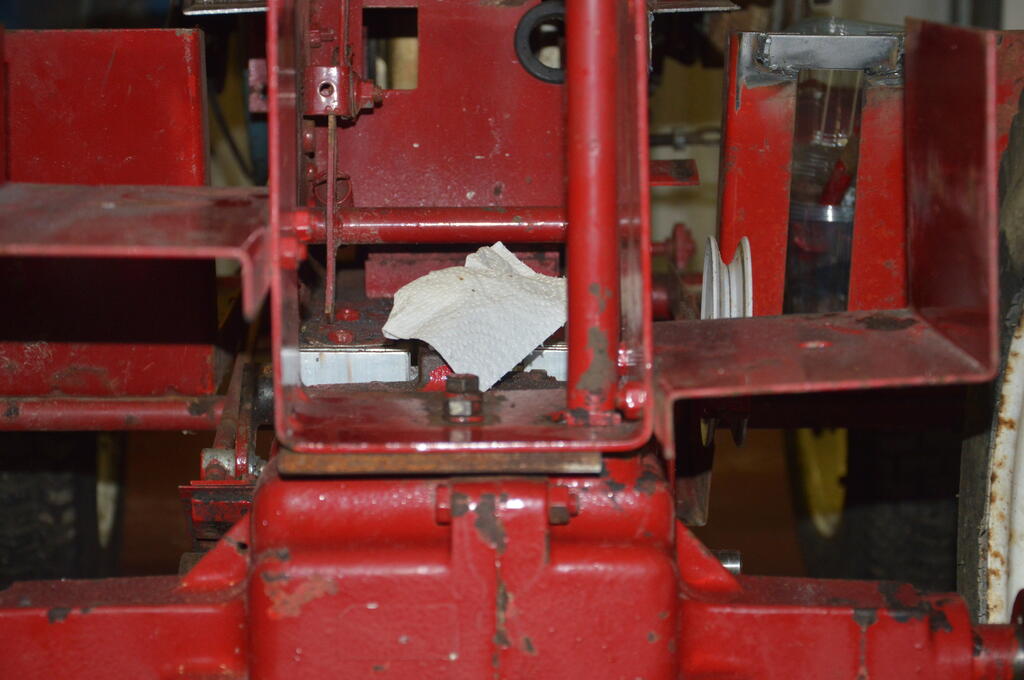

Maxwell-8 4,371 #57 Posted November 29, 2021 I move the transmission to the rear 2 cm or a bit over 3/4 inch. Also a good frame and tranny clean with oven cleaner was in much need. Sanded the places were the tranny mounts and painted it with Galvanising Spray. 2 1 Share this post Link to post Share on other sites

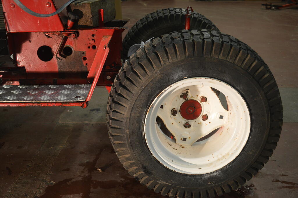

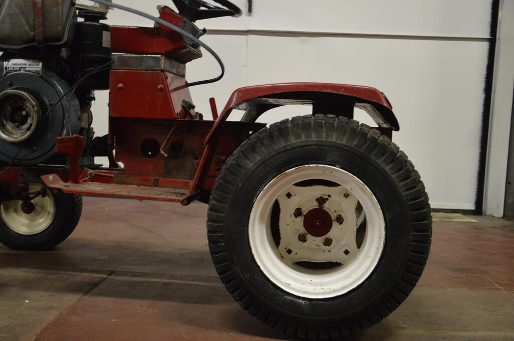

Maxwell-8 4,371 #58 Posted November 29, 2021 (edited) I planned on having room for tires up to 25 inches. Turns out I will be able to fit up to 27" real size 23" are currently on Edited November 29, 2021 by Maxwell-8 1 2 Share this post Link to post Share on other sites

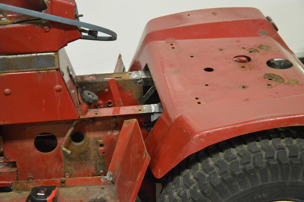

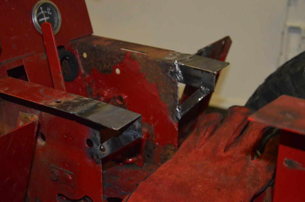

Maxwell-8 4,371 #59 Posted December 1, 2021 Yesterday I repaired and reinforced the front seat mounts: Today I started trying to get the fender to fit. 1 Share this post Link to post Share on other sites

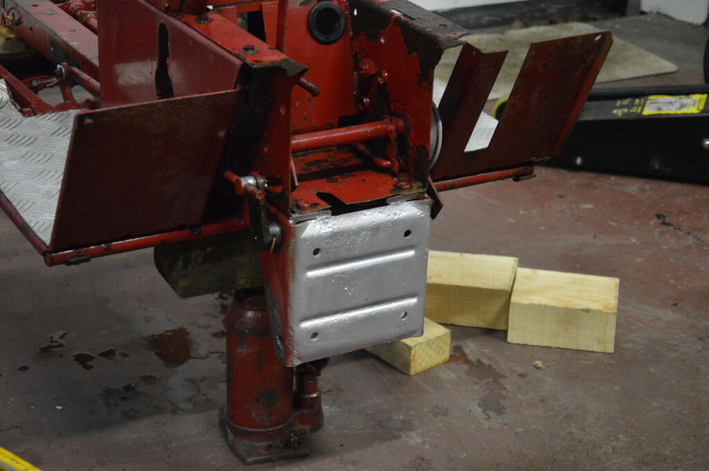

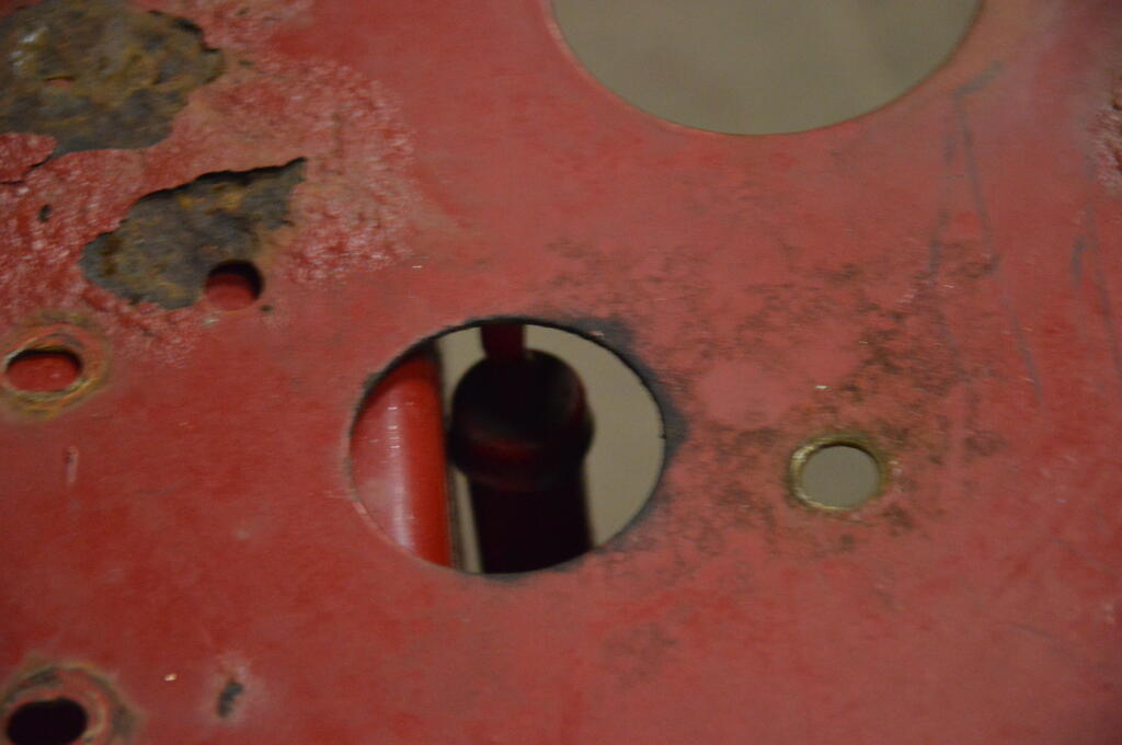

Maxwell-8 4,371 #60 Posted December 1, 2021 Installing big metal plate under the fender support, Allowed me to move the fender a bit forward somehow. I am not using the fueltank as their is one on the engine. Otherwise I wouldn't be able to move the fender to the front. I will have to move my dipstick hole in the fender... 3 Share this post Link to post Share on other sites

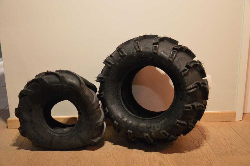

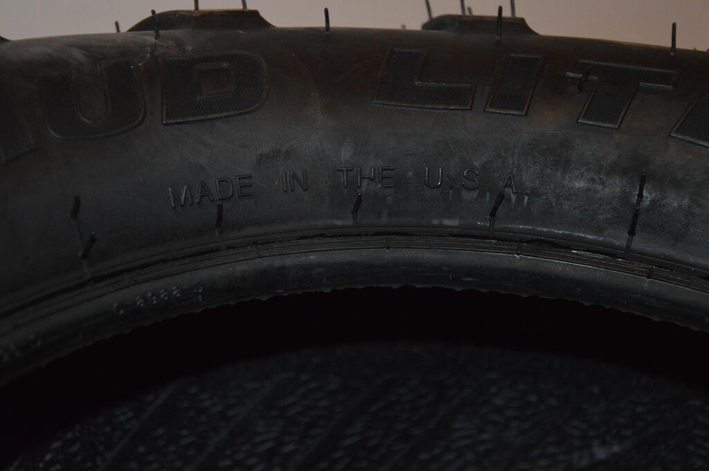

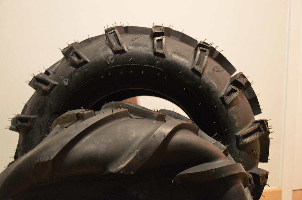

Maxwell-8 4,371 #61 Posted December 2, 2021 Some new meat arrived today! Carlisle super lug in the front. ITP Mudlite xl in the rear. I went AG in the front since I couldn't find 3 ribs. and I went with a atv trail/mud tire since a good quality AG was almost double in price! I found these to be quite similar in pattern to AG and that these will fit on a 7" rim! despite the width. ( The fact that they were made in the USA also had a rather big influence!) 5 Share this post Link to post Share on other sites
Handy Don 17,369 #62 Posted December 2, 2021 With the spacing of the lugs on that rear tire I'd plan for a bit of a bumpy ride 1 Share this post Link to post Share on other sites
ebinmaine 80,439 #63 Posted December 2, 2021 20 minutes ago, Handy Don said: With the spacing of the lugs on that rear tire I'd plan for a bit of a bumpy ride No worries. Just means you have to speed up a little bit. 4 Share this post Link to post Share on other sites
Maxwell-8 4,371 #64 Posted December 2, 2021 21 minutes ago, Handy Don said: With the spacing of the lugs on that rear tire I'd plan for a bit of a bumpy ride they said they were trail tires more then mud, and didn't look bad in the pictures. But when they got delivered I was surprised to see how big they are. I will keep you updated once I get my rims sandblasted,painted and tires mounted. My sandblast cabinet will be here, I hope tomorrow. 2 Share this post Link to post Share on other sites

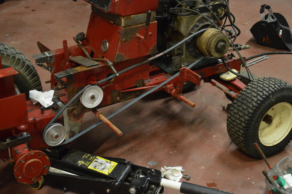

Maxwell-8 4,371 #65 Posted December 10, 2021 lot of parts are hard to find, such as pulleys. Let it now be that the only universal brand I can find, are perfect for tranny pulleys. with the screw in it. Got the pulley in the mail and so I made my drive line. I had to wait for it before installing the engine. New holes have to be drilled anyway and now I can still use the same belt size. I have a 1:1 pulley ratio, Reason being: the engine spins slower, and want a sniff more speed. 3 Share this post Link to post Share on other sites
kpinnc 18,916 #66 Posted December 11, 2021 On 12/10/2021 at 12:30 PM, Maxwell-8 said: I have a 1:1 pulley ratio, Reason being: the engine spins slower, and want a sniff more speed. It may not happen, because your drive pulley isn't extremely small. But if you still have slippage with a smaller pulley, you can add a fixed idler in the frame holes behind the step support. It's not to add tension, but to make a larger contact on the drive pulley. 3 1 Share this post Link to post Share on other sites
Maxwell-8 4,371 #67 Posted December 11, 2021 25 minutes ago, kpinnc said: It may not happen, because your drive pulley isn't extremely small. But if you still have slippage with a smaller pulley, you can add a fixed idler in the frame holes behind the step support. It's not to add tension, but to make a larger contact on the drive pulley. Thanks for that Idea! That will also help with DE tensioning the belt. I will for sure install one! Share this post Link to post Share on other sites
