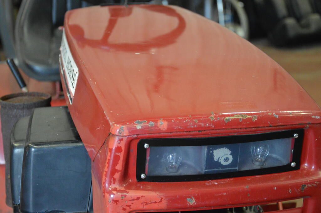

Maxwell-8 4,371 #30 Posted November 6, 2021 (edited) The rear hubs, were never tight when I got them. turned out one bolt was stuck, and someone drilled trough it. So I secured them, still waiting on new seals, but they haven't been leaking since I ordered them two weeks ago.., previous owner said they were leaking, butt haven't experienced any leaking... But I haven't driven it yet. Oil was a bit overfilled, but don't think it will hurt anything. Having quite some experience with bringing back shine from paint trough compound, polishing and claybar. First time I tried wet-sanding, works pretty good, but it is quite aggressive. Also cleaned up the headlight lens, it's not original, but like they kept the original WH logo. Edited November 6, 2021 by Maxwell-8 1 Share this post Link to post Share on other sites

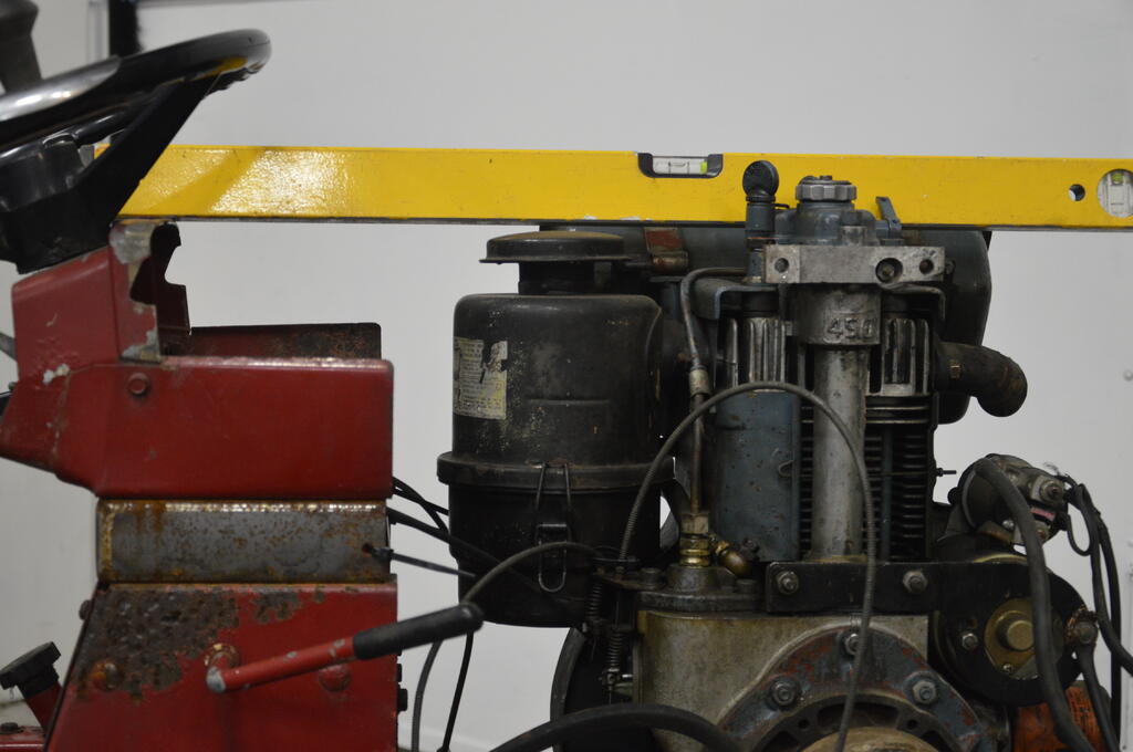

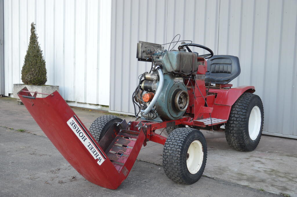

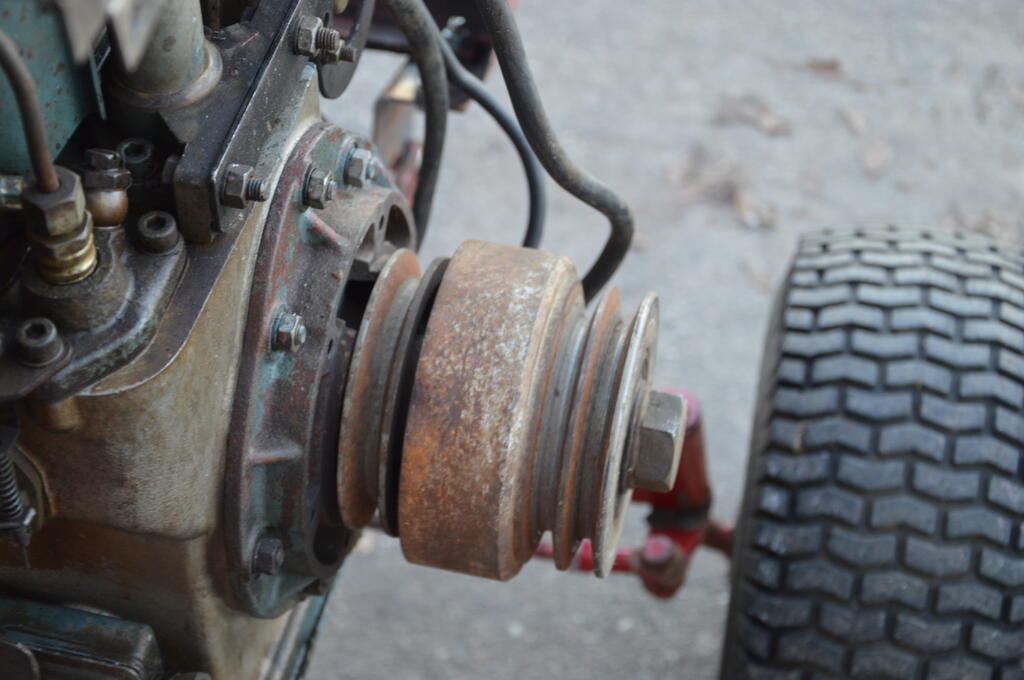

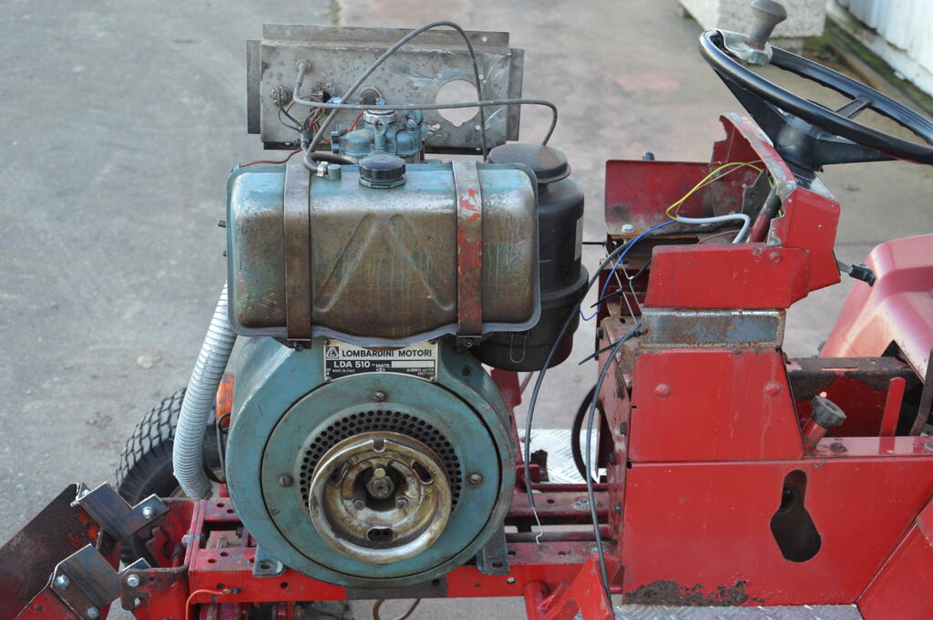

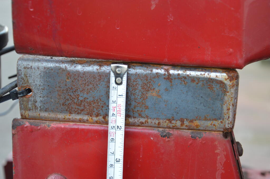

Maxwell-8 4,371 #32 Posted November 23, 2021 After checking the vin -number, that was moved from its original location. I found out my c161 is actually a c121. Yesterday I brought the 3th and final engine option home. I am scrapping the longitudinal plan due to it being not practical. I am sorry.. And I will also not be using the M16.... I am sorry, you will be mad on me.... mainly Kohler parts are getting hard to find and so they are also very expensif. So I picked up this Lombardini LDA 510 1cyl 31ci 14hp OHV aircooled engine that weighs in at 190lbs (same weight as a K582). It has a rope and an electric start. It also has a decomp because the compression ratio. The engine has a french nickname: "l'inarrestable" translation: "The Unstoppable" The 2" hood lift is not enough for the engine to fit. It also is fully pressure lubricated and has a screw-on oilfilter. and an oilfilled airfilter 3 3 Share this post Link to post Share on other sites

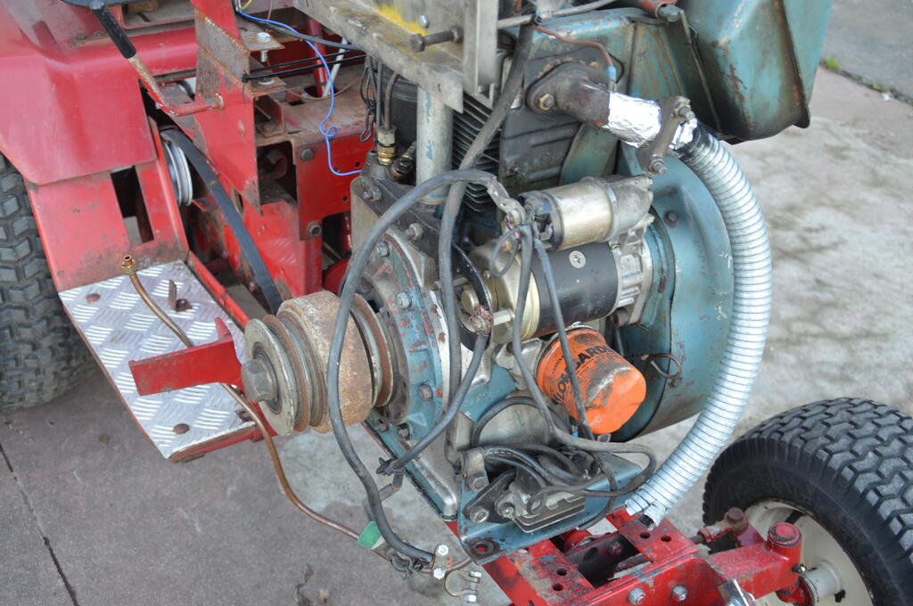

71_Bronco 1,073 #33 Posted November 23, 2021 Looks like a nice little project, but you may have to put that engine on a diet and lose a few items before it will fit lol Also, it may just be the picture / angle, but it looks like that output pulley is going to be a little tricky to line up with the transmission pulley. Might want to check that out. 2 Share this post Link to post Share on other sites
ebinmaine 81,047 #34 Posted November 23, 2021 48 minutes ago, 71_Bronco said: it may just be the picture / angle, but it looks like that output pulley is going to be a little tricky to line up with the transmission pulley. Might want to check that out The inward pulley is pretty close. Might have to make an adapter plate to slide the engine one way or the other... 1 Share this post Link to post Share on other sites
Maxwell-8 4,371 #35 Posted November 23, 2021 I will try and make it fit, I think relocating the fueltank will bring me a far way. The inner pulley is pretty close heightwise as a kohler. The motor will need to move a bit more to the leftside of the tractor. The two outer pulleys are on a internal clutch that engages when the engine is spun-up. Maybe interesting for some things and since I have two horses with manual WH pto's. I think I will keep it. Maybe a mowing deck that only spins when you have sufficient engine rpm? @ebinmaine or a compressor that brings down the rpm of the engine is when no more air is needed and the clutch disengages those pulleys.... 4 Share this post Link to post Share on other sites
Handy Don 17,634 #36 Posted November 23, 2021 A centrifugal clutch for the PTO, then. Looks pretty sturdy. 1 Share this post Link to post Share on other sites
Maxwell-8 4,371 #37 Posted November 23, 2021 5 hours ago, Handy Don said: A centrifugal clutch for the PTO, then. Looks pretty sturdy. indeed, made to handle the 14hp and the 26 foot pounds. Share this post Link to post Share on other sites

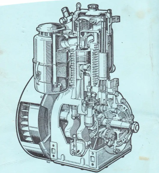

Maxwell-8 4,371 #38 Posted November 23, 2021 (edited) This may explain way these engines are so darn heavy! What is all going on in that box? Edited November 23, 2021 by Maxwell-8 1 Share this post Link to post Share on other sites

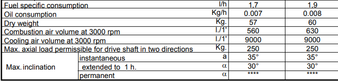

Maxwell-8 4,371 #39 Posted November 25, 2021 The Lombardini has rated max axial load of 250kg/550lbs. Is that enough for a WH PTO? Share this post Link to post Share on other sites
Snoopy11 5,731 #40 Posted November 25, 2021 On 11/23/2021 at 4:53 PM, Maxwell-8 said: What is all going on in that box? Do you want the technical answer or the common-folk answer? Technical: Common-folk: Don 2 Share this post Link to post Share on other sites
Maxwell-8 4,371 #41 Posted November 25, 2021 8 minutes ago, Snoopy11 said: Do you want the technical answer or the common-folk answer? Technical: Common-folk: Don Just did some reading on the manual. I can adjust fuel delivery timing and fuel amount. Something most diesel will not allow you to do. You can really squize some more power out if I ever want. Or support a turbo fuel wise. 1 Share this post Link to post Share on other sites
Snoopy11 5,731 #42 Posted November 25, 2021 4 minutes ago, Maxwell-8 said: Just did some reading on the manual. I can adjust fuel delivery timing and fuel amount. Something most diesel will not allow you to do. You can really squize some more power out if I ever want. Or support a turbo fuel wise. What horsepower is it? Don Share this post Link to post Share on other sites
Maxwell-8 4,371 #43 Posted November 25, 2021 17 minutes ago, Snoopy11 said: What horsepower is it? Don Stock 14hp. Which is relatief high for a diesel spinning to only 3000 rpm. They made them up to 18hp, still 1cyl air-cooled NA . those only rev to 2800rpm Share this post Link to post Share on other sites

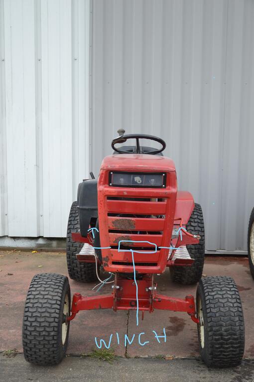

Maxwell-8 4,371 #48 Posted November 27, 2021 On 11/26/2021 at 1:38 AM, ebinmaine said: Max can increase pulley size for speed On 11/26/2021 at 1:55 AM, Snoopy11 said: Ordered a bit smaller pulley for the rear. And I probably will up a bit in tire size. We live next to the flat country (The Netherlands) So also around here everything is flat. I am hoping to be a bit faster then stock. Like +/- 10mph. 1 Share this post Link to post Share on other sites
