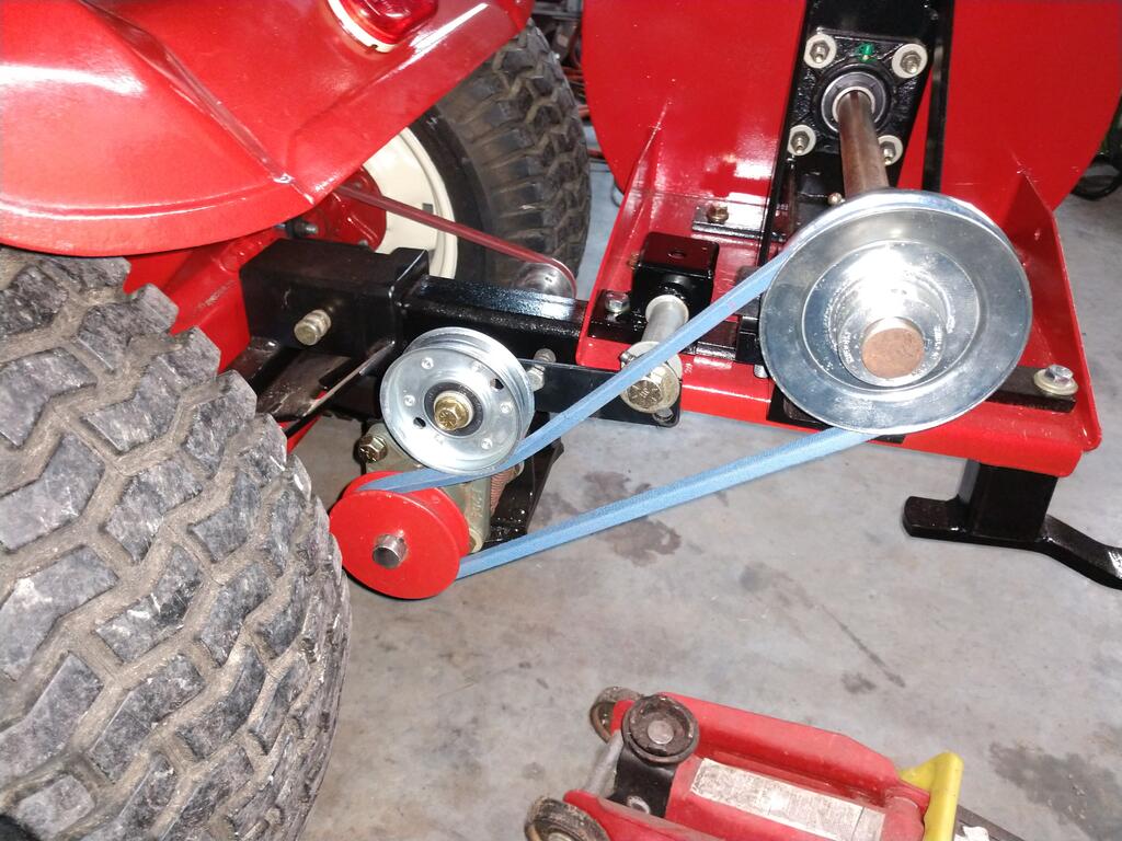

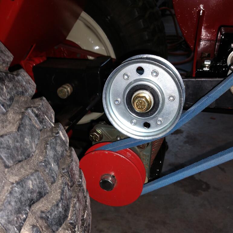

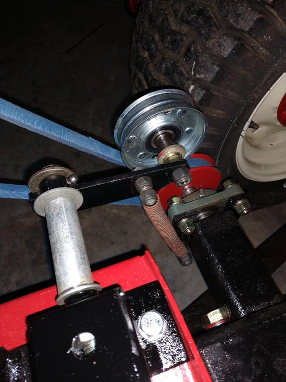

kpinnc 19,036 #85 Posted November 25, 2021 (edited) Light tinkering today. Made an idler for the final drive belt. Really don't need it, but I'm sure that belt will stretch like any other. Edited November 25, 2021 by kpinnc 5 Share this post Link to post Share on other sites
ebinmaine 81,047 #86 Posted November 25, 2021 VERY nice work there! I was always taught that belts don't "stretch" literally. They wear on the sides making them appear to be longer because they set in the pulley deeper. Either way that idler will do the trick!! 3 1 Share this post Link to post Share on other sites

Maxwell-8 4,371 #95 Posted November 27, 2021 On 11/25/2021 at 9:24 AM, kpinnc said: Light tinkering today. Made an idler for the final drive belt. Really don't need it, but I'm sure that belt will stretch like any other. A proper and clean build and install! I like it. 1 Share this post Link to post Share on other sites
Maxwell-8 4,371 #96 Posted November 27, 2021 On 11/25/2021 at 12:01 PM, ebinmaine said: VERY nice work there! I was always taught that belts don't "stretch" literally. They wear on the sides making them appear to be longer because they set in the pulley deeper. Either way that idler will do the trick!! rubber stretches, don't no if Kevlar does 2 Share this post Link to post Share on other sites

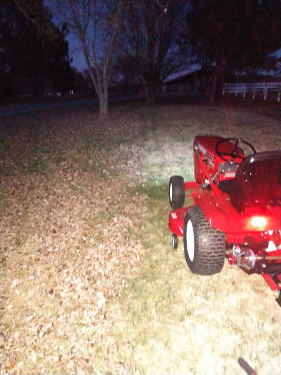

kpinnc 19,036 #100 Posted November 30, 2021 So the vac got a solid field test tonight. Governor is still not right, but better. Almost there! 4 Share this post Link to post Share on other sites
