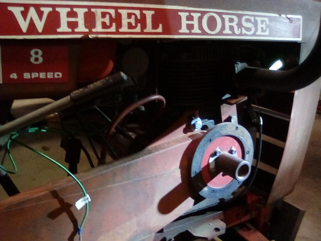

Michael Ward 0 #1 Posted October 11, 2021 Last weekend I bought a 1973 Wheel Horse 8 hp 4-speed (model 1-0120) for a restore project for my 15 year old son and I, just something to work on together in the garage. My project doesn't have a PTO, and I wish it did. Does anybody know if a 1976 B-60 PTO would fit? (Found most of one on eBay.) Share this post Link to post Share on other sites

kpinnc 18,744 #5 Posted October 11, 2021 1 hour ago, Michael Ward said: Does anybody know if a 1976 B-60 PTO would fit? It should fit. And you need to polish us that sleeve at the center of the clutch plate. The bearing in the PTO rides there. Share this post Link to post Share on other sites
