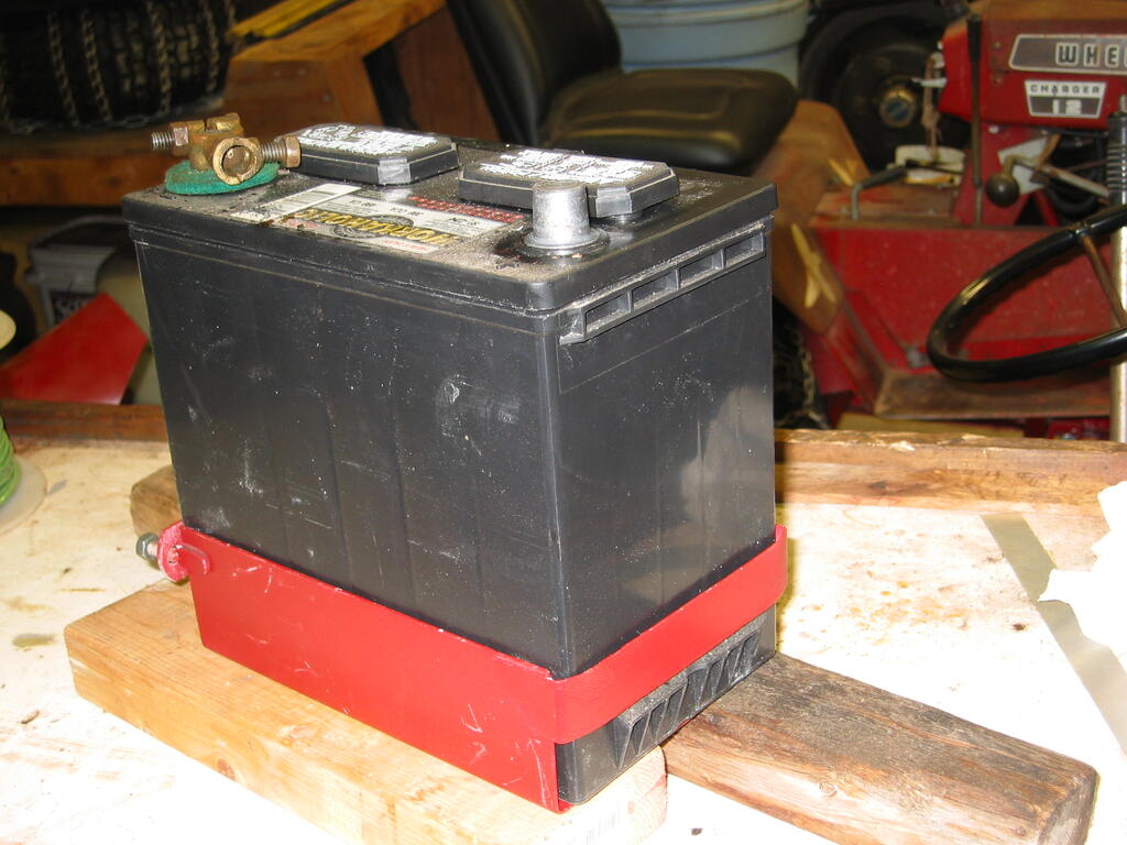

Sodaking27 1,358 #1 Posted October 10, 2021 Have a Bronco14 that I want to put the correct size battery in that fits the battery box. Currently has a regular LM battery with a piece of wood for a spacer. Can someone tell me what I need to ask for when I got to the battery store? Thanks. 1 Share this post Link to post Share on other sites
ebinmaine 80,766 #2 Posted October 10, 2021 In my Cinnamon Horse '74 C160 I have a group 51 or 51R. I built the cables long enough to use either. 1 1 Share this post Link to post Share on other sites
pfrederi 21,181 #3 Posted October 11, 2021 22NF will also work 2 Share this post Link to post Share on other sites
