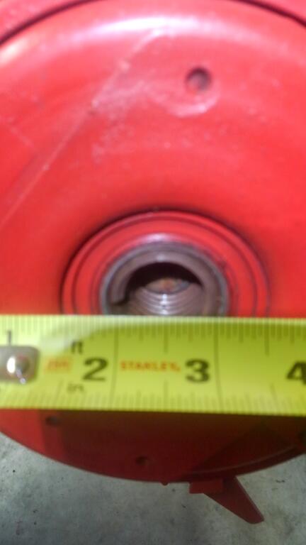

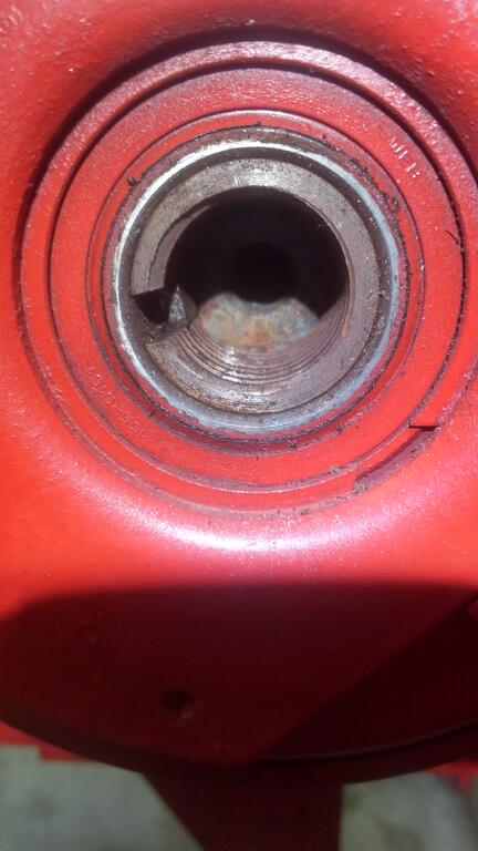

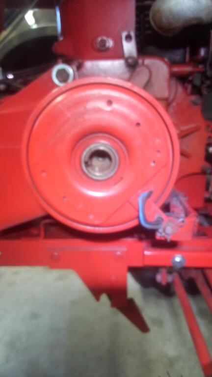

Rusty Tinsnips 477 #1 Posted October 10, 2021 Hi everyone, I am trying to remove this PTO from my '71 Raider 10. I read a few posts about getting the 5/8" bolt and screwing it in to pull the clutch and pulleys. BUT, the hole is way bigger than 5/8". Looks like maybe 7/8" or 1" ? Also looks like the key is sticking up high enough to interfere with a bolt going down to the shaft. The double pully on the engine side started making noise and has slight movement side to side. Hoping I can grease the bearing for some extended life. Do I need a 7/8" or 1" bolt? Or is something missing inside? Thank you. Share this post Link to post Share on other sites
953 nut 69,148 #2 Posted October 10, 2021 The electric PTO on my GT-14 required a 1" bolt. Go to your hardware store and buy a 7/8" and a 1" and return the one you don't use. 1 1 Share this post Link to post Share on other sites
Rusty Tinsnips 477 #3 Posted October 11, 2021 Well, I had already got a 7/8" before I saw 953 nut's post and it's too small. So back to the store for a 1". sigh Share this post Link to post Share on other sites
