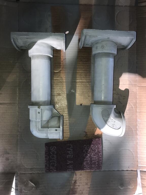

oliver2-44 11,632 #5 Posted October 9, 2021 Ok, I have a large box of red and green Scotchbrite pads in the shop. Currently using a red one to buff 2 traffic light mounting brackets 2 Share this post Link to post Share on other sites
