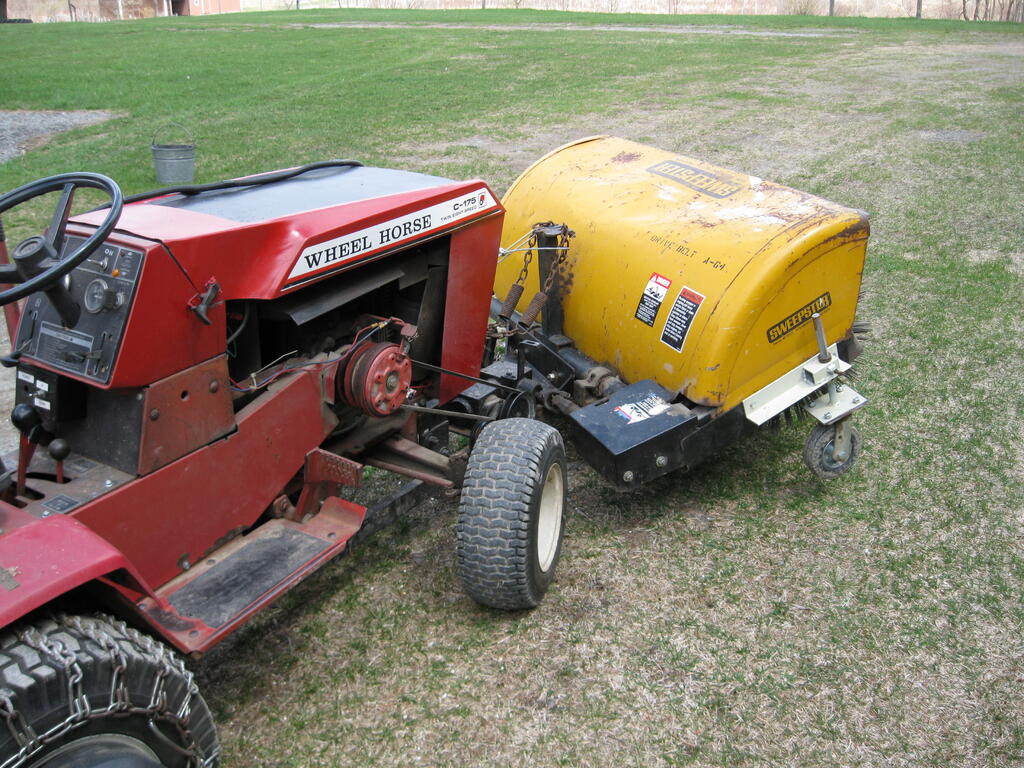

pfrederi 19,894 #2 Posted October 7, 2021 The KT17 (Series 1) on my sweepster came from a JD317 that my brother bought used then ran it for many years. Hour meter had died a 2200 hours. Crank seal leaked badly so he was constantly overfilling it with oil. Finally pulled it put in a new engine and this one sat in his barn for a few years then I got it changed out some tins and intake manifold put a new seal on the crank and she runs well ...smokes some on startup but it clears after a couple minutes. Since it was JD spec I had to use an electric PTO engagement is a bit rough...wish i could use a manual one... Overfill and keep it that way.... 3 Share this post Link to post Share on other sites
