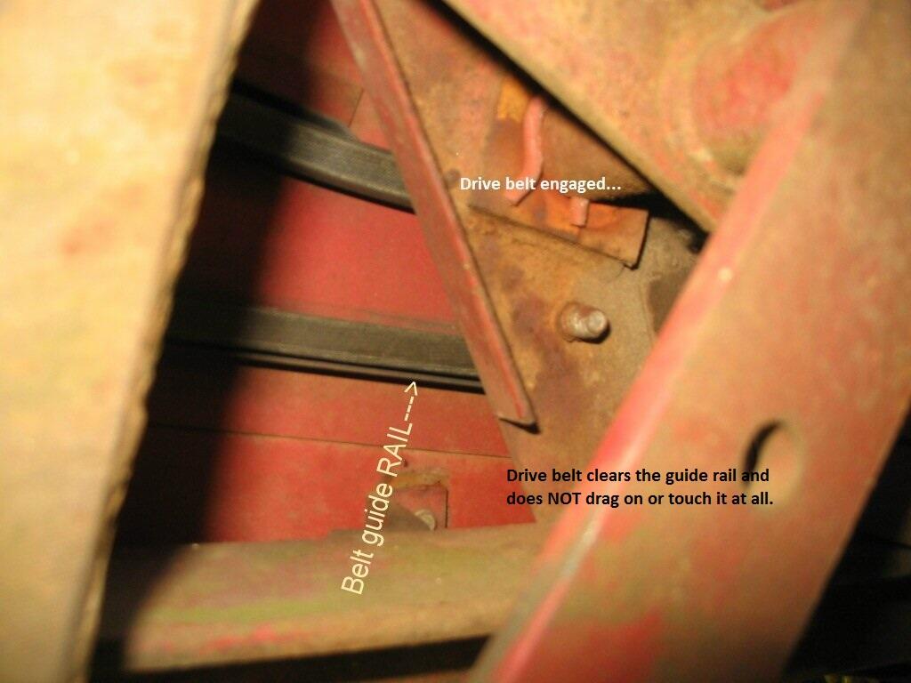

fjdc100 8 #1 Posted October 7, 2021 Have a C-100 1-0390 Drive belt went and I put a new belt on 82" by 5/8" Drive belt would not disengage, grinds trying to get it into gear. Then put the belt cover back and it worked for a while--now have same problem. Question--Does the belt ride above the tab on the cover or below? idler pully looks goods--tab on idler pulley too far forward but it worked before so i left it alone. Is it correct that the idler pully tab contacts the belt when clutch is pushed in? Share this post Link to post Share on other sites
daveoman1966 3,884 #2 Posted October 7, 2021 OEM belt is # 7473. If you bought an aftermarket belt, the geometry is not the same and THAT may be part..or all...of the problem. The belt should ride above the step on the back side of the belt cover to 'catch' the slack when clutch is depressed. Share this post Link to post Share on other sites
