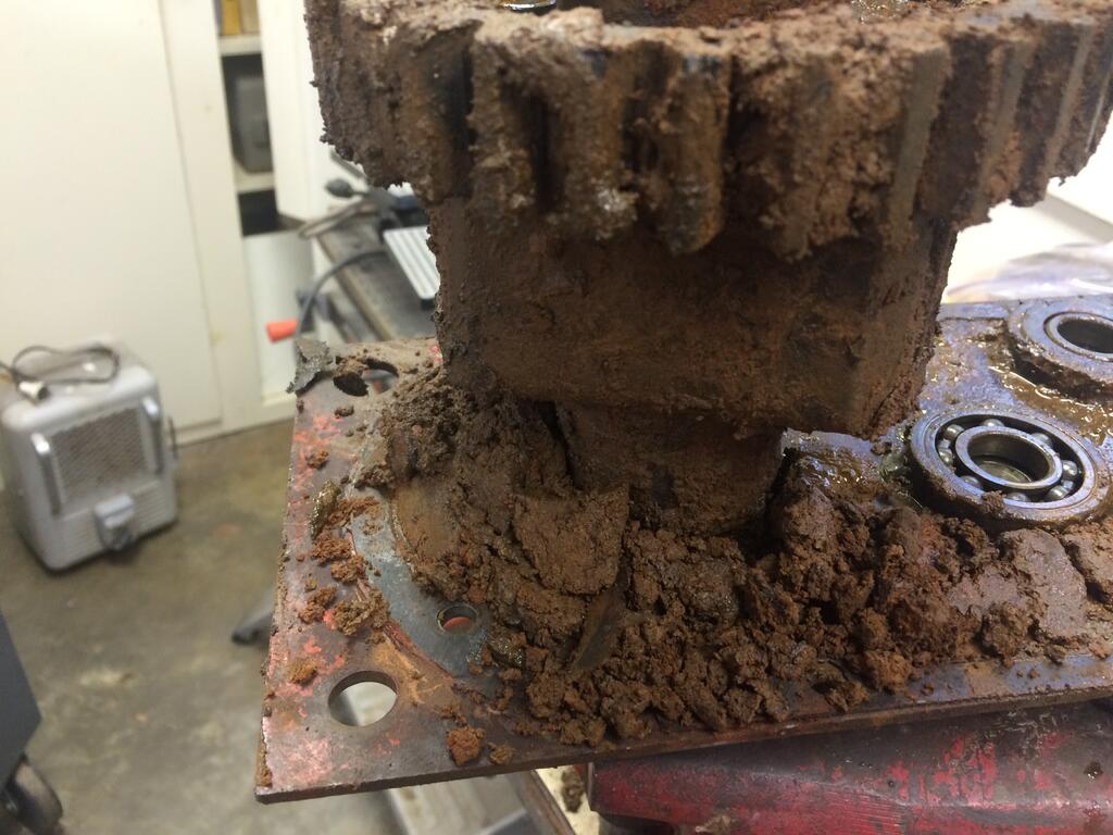

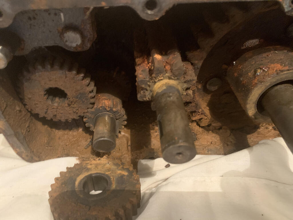

oliver2-44 11,611 #3 Posted October 7, 2021 A wire wheel on a bench grinder or a blast cabinet with glass bead is your friend. You could also clean the case in an E-Tank. That one should cleanup nicely. The gears on this one were pitted badly. Wheelhorse Parts and More has bearings and seals, or you can use this thread to order most of them from a local bearing supply. Note the axle seals are only available from WH Parts and More Here's a thread on the transmission rebuild by our Guru Please continue a thread with your rebuild. 1 Share this post Link to post Share on other sites

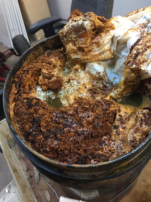

roadapples 6,987 #4 Posted October 7, 2021 That first picture looks like a pan of lasagna 😋.... 1 1 Share this post Link to post Share on other sites
Pullstart 70,507 #5 Posted October 7, 2021 Awwww. That one looks easy! Like Jim said, there have been many much worse than that. Another vote for an e-tank, those work wonders with rust. 1 Share this post Link to post Share on other sites
squonk 47,310 #6 Posted October 7, 2021 What do you with the left over "Lasagna sauce" when you are finished? 1 Share this post Link to post Share on other sites
Pullstart 70,507 #7 Posted October 7, 2021 5 hours ago, squonk said: What do you with the left over "Lasagna sauce" when you are finished? It is simply dirty washing soda. No different than an extreme car wash or degreasing. Share this post Link to post Share on other sites
Pullstart 70,507 #8 Posted October 7, 2021 You can also use it over and over, no matter how dirty. It’s just water and washing soda. NOTE that is DIFFERENT than baking soda. Share this post Link to post Share on other sites
squonk 47,310 #9 Posted October 7, 2021 Seem to me with all the action of derusting the water would be acidic? Share this post Link to post Share on other sites
stevasaurus 23,739 #10 Posted October 7, 2021 If you just use water and washing soda, nothing is toxic. I feed it around my shrubbery, and it works wonders, but it is important to only use ferrous metals...copper & aluminum make it a toxic solution. Share this post Link to post Share on other sites
EB-80/8inPA 2,028 #11 Posted October 7, 2021 2 hours ago, pullstart said: You can also use it over and over, no matter how dirty. It’s just water and washing soda. NOTE that is DIFFERENT than baking soda. Doesn’t the soda need replenishing after a while? Share this post Link to post Share on other sites
Pullstart 70,507 #12 Posted October 7, 2021 17 minutes ago, EB-80/8inPA said: Doesn’t the soda need replenishing after a while? I imagine so, but it lasts longer than you’d think Share this post Link to post Share on other sites
stevasaurus 23,739 #13 Posted October 7, 2021 No, it does not need replenishing because it is only making a solution that allows the electrons to move from negative to positive. All you have to do is scoop off the junk on the top and keep your electrodes 1/2" off the bottom. 1 Share this post Link to post Share on other sites

stevasaurus 23,739 #15 Posted October 7, 2021 The soda is a base...if the rust is acidic, it should come out neutral at best. Obviously, some plants like basic and some like more acidic. I am not really sure how basic or acidic the solution is. I know it is not toxic, that is what is important. You can dump it outside with out harming the environment. Don't potatoes like acidic...Blue Agave ??? My grape vines seem to like it a lot. 1 Share this post Link to post Share on other sites
squonk 47,310 #16 Posted October 7, 2021 You would think will all the gases produced it would get nasty. I read online it's safe to dump Share this post Link to post Share on other sites
stevasaurus 23,739 #17 Posted October 7, 2021 Produces Hydrogen...that's all I know. You want to do this in a ventilated area for sure. BTW, so does charging a battery. I wonder how acidic the poop from your metal chickens is Mike. Brown spots in the yard??? 1 Share this post Link to post Share on other sites
stevasaurus 23,739 #18 Posted October 7, 2021 You know, if you are that worried about PH...test it and add lime to neutralize the acid...it is still not toxic. Share this post Link to post Share on other sites

formariz 12,379 #23 Posted October 16, 2021 On 10/7/2021 at 12:41 PM, squonk said: What do you with the left over "Lasagna sauce" when you are finished? I have dumped it on the lawn and that area always turns into a much darker area from all the iron. When dumped around an Hydrangea if the flowers are reddish they will turn to the natural blue in a short time due to the acidity. I have never had an adverse reaction from dumping it anywhere. Share this post Link to post Share on other sites
