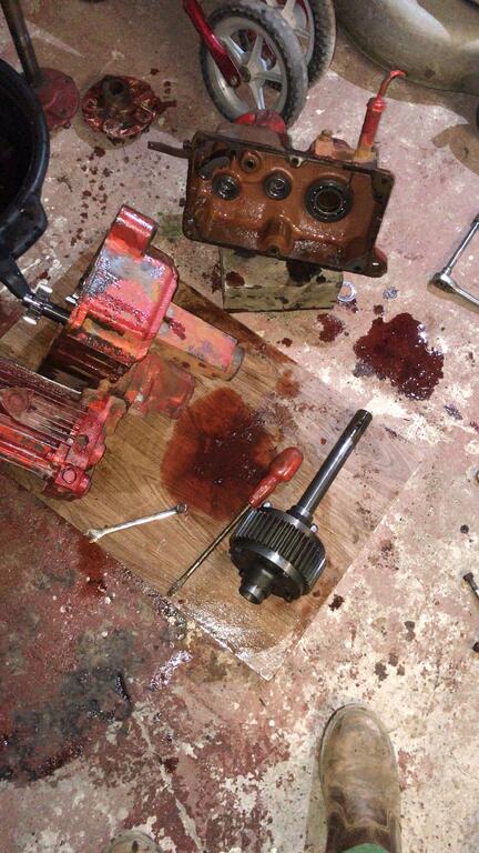

Felix 145 #1 Posted October 6, 2021 I’ve just had a automatic sundstrad transmission in half to replace a circlip on the end of a drive shaft. When I’ve put it back together I’ve noticed there is quite a bit of resistance when I turn the hubs. Is this normal or does it need splitting again? move only turned the hubs with no wheels on. The diff is working as the hubs turn in opposite directions. Share this post Link to post Share on other sites

stevasaurus 23,857 #7 Posted October 6, 2021 The differential would spin "freely", no mater if a tow valve was open (if you have one) or not....but you still may not be able to push it. Give us a model number. Do you have the Owners Manual?? Lift up the seat and give us a picture of the top of the trans. Do not push it if the wheels will not turn. Put the rear end on trucks to move around. Most tow valves are on the left side, and could be 1/2" open end wrench, allen wrench. Really need model number and some pictures. Turning the wheels just turns the pinions inside the differential...not the differential itself. When the rear end is on the ground and you try to push it, you are trying to turn the whole differential (with axles)...and some gears that work with the pump. This is where the damage happens. You need to know what you have and what the manual for yours says on how to move it without running. If you have a tow valve and you can open it 1/2 turn, you should be able to push your horse. Share this post Link to post Share on other sites

Felix 145 #9 Posted October 7, 2021 9 hours ago, stevasaurus said: The differential would spin "freely", no mater if a tow valve was open (if you have one) or not....but you still may not be able to push it. Give us a model number. Do you have the Owners Manual?? Lift up the seat and give us a picture of the top of the trans. Do not push it if the wheels will not turn. Put the rear end on trucks to move around. Most tow valves are on the left side, and could be 1/2" open end wrench, allen wrench. Really need model number and some pictures. Turning the wheels just turns the pinions inside the differential...not the differential itself. When the rear end is on the ground and you try to push it, you are trying to turn the whole differential (with axles)...and some gears that work with the pump. This is where the damage happens. You need to know what you have and what the manual for yours says on how to move it without running. If you have a tow valve and you can open it 1/2 turn, you should be able to push your horse. This is the only picture I have until I get home. The diff turned freely on the bench. Then when I put it back in the case I noticed when it was bolted back together it was fairly tight. You can turn the hubs by hand with no wheels on. Share this post Link to post Share on other sites
