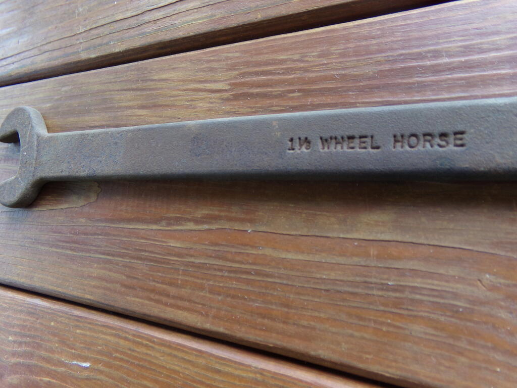

953 nut 69,812 #10 Posted October 4, 2021 7 hours ago, Jeff-C175 said: 1-1/16" open end that fits the nut below the blade. It has to be thin enough to fit in between. You will need a thin 1 1/8 open end wrench, the special wrench you see being sold from time to time on for a small fortune is the correct wrench. If you are cheap like me you can find an old 1 1/8" wrench and saw off about 1/8" of the thickness. 1 Share this post Link to post Share on other sites

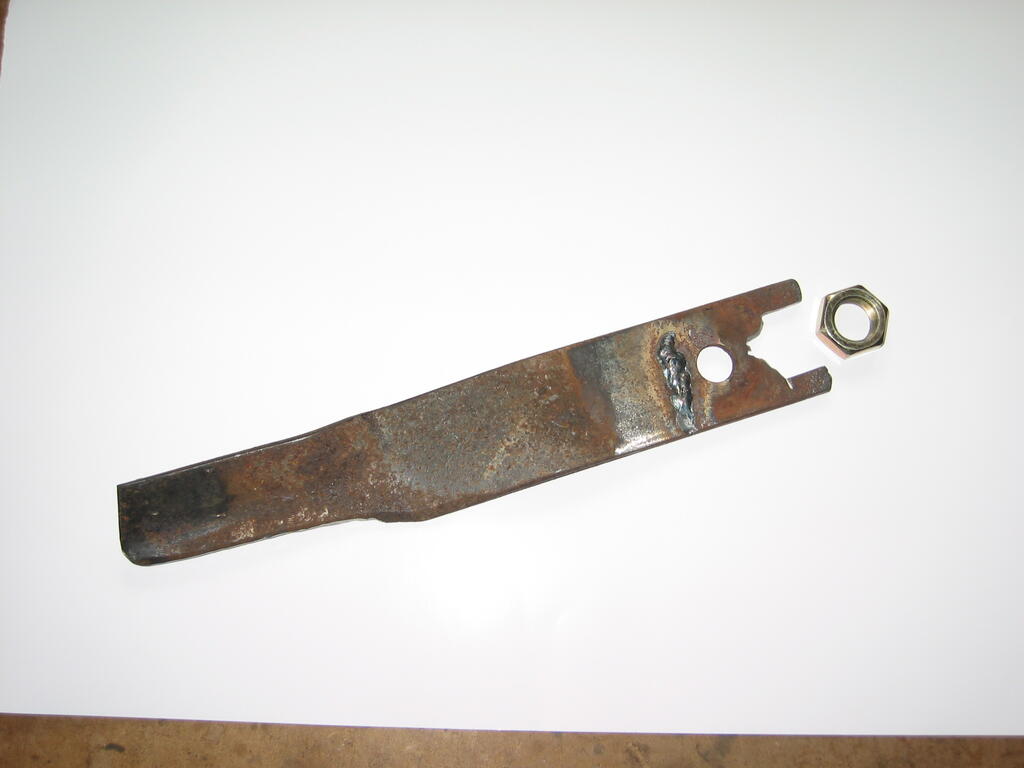

Jeff-C175 7,211 #12 Posted October 4, 2021 1 hour ago, 953 nut said: special wrench Thanks for the memory check! I thought the 'under' nut was a step smaller. I've heard tell that the WH wrench isn't very durable. True or no? That wrench can also be made from an old mower blade. Cut the end square, use a grinder to cut a notch to fit the bolt. If ya wanna get fancy, Plasti-Dip the handle end. Share this post Link to post Share on other sites

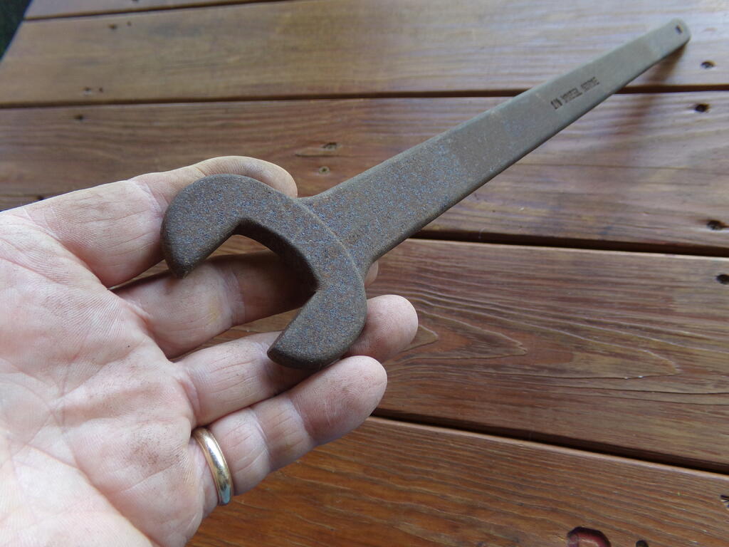

pfrederi 21,222 #13 Posted October 4, 2021 No Plasti-Dip on mine 2 3 Share this post Link to post Share on other sites
Ed Kennell 47,597 #14 Posted October 4, 2021 8 hours ago, 953 nut said: the special wrench you see being sold from time to time on for a small fortune "A small fortune" How small Richard? Might have to sell mine. 1 Share this post Link to post Share on other sites
Jeff-C175 7,211 #15 Posted October 4, 2021 (edited) 33 minutes ago, Ed Kennell said: "A small fortune" Might be worth gold plating it! Perhaps powder coating it RED with BLACK filled lettering. Edited October 4, 2021 by Jeff-C175 1 Share this post Link to post Share on other sites
