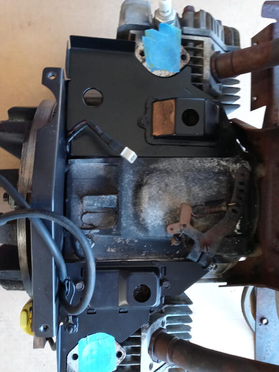

Horse Newbie 7,405 #126 Posted October 23, 2021 My carb kit came in...got it. It will be a spare as I have put the carb back together with a kit the PO have me with the Work Horse. But, my intake to engine manifold gaskets did not come with the carb kit(the man said they did or I would have ordered them 2 weeks ago). But at least I was able to get the valve covers back on... 3 Share this post Link to post Share on other sites

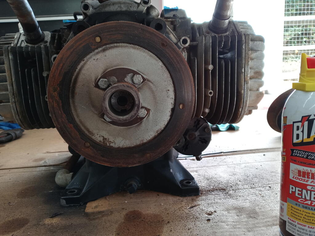

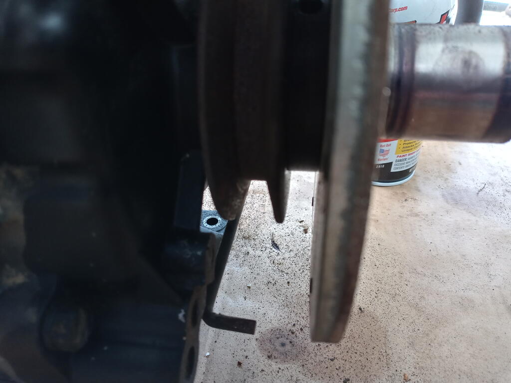

Horse Newbie 7,405 #127 Posted October 24, 2021 I WAS NOT planning on doing all this... How do you get the clutch friction disc off ? Is it just these 4 bolts ? It is awfully thin...worn down almost to the rivet heads... Looks like it's about 1/16th inch thick. There are 2 set screws behind there that holds the deck belt pulley to the shaft. I hope I don't have to take those out ! 1 Share this post Link to post Share on other sites

Horse Newbie 7,405 #129 Posted October 24, 2021 I got the clutch disc off... I found one on the jungle site for about 59 clams...have any of you guys ordered the clutch discs off of the jungle site and the product been decent ? Share this post Link to post Share on other sites

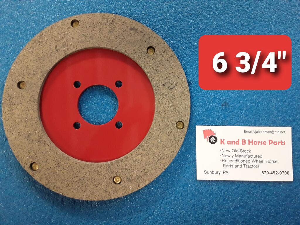

ebinmaine 81,283 #131 Posted October 24, 2021 1 hour ago, Horse Newbie said: Does anybody know if A-Z Tractors(Lincoln) talks business on Sunday ? Not that I know of. 1 hour ago, Horse Newbie said: I got the clutch disc off... I found one on the jungle site for about 59 clams...have any of you guys ordered the clutch discs off of the jungle site and the product been decent ? I don't buy anything Wheelhorse off the fleabay unless no-one on Redsquare has it. I don't believe in paying eBay as a company unless necessary. Contact the originator of this thread: @76c12091520h He may very well have what you need and keep the business here in the site with no third party. 1 1 Share this post Link to post Share on other sites
76c12091520h 4,301 #132 Posted October 24, 2021 $65.00 / Shipped / more details available in our spot in the vendors section. 2 Share this post Link to post Share on other sites

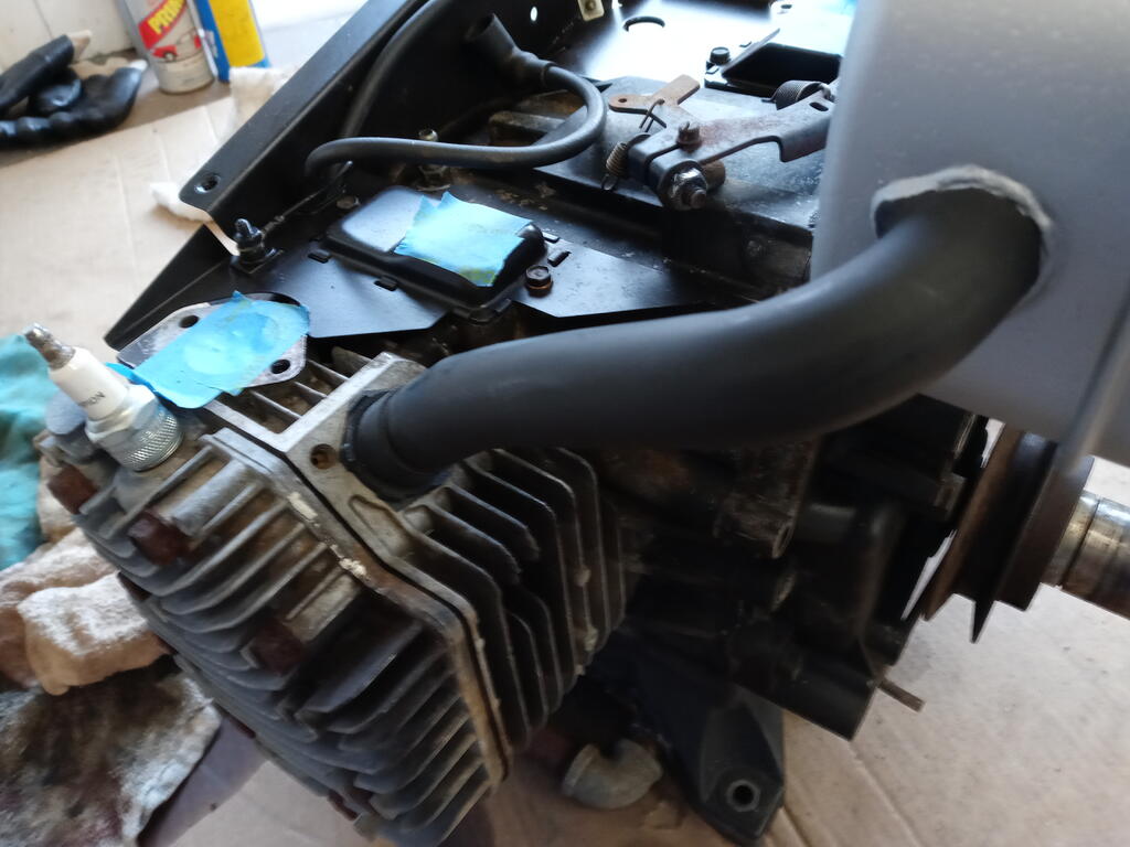

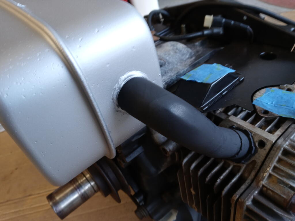

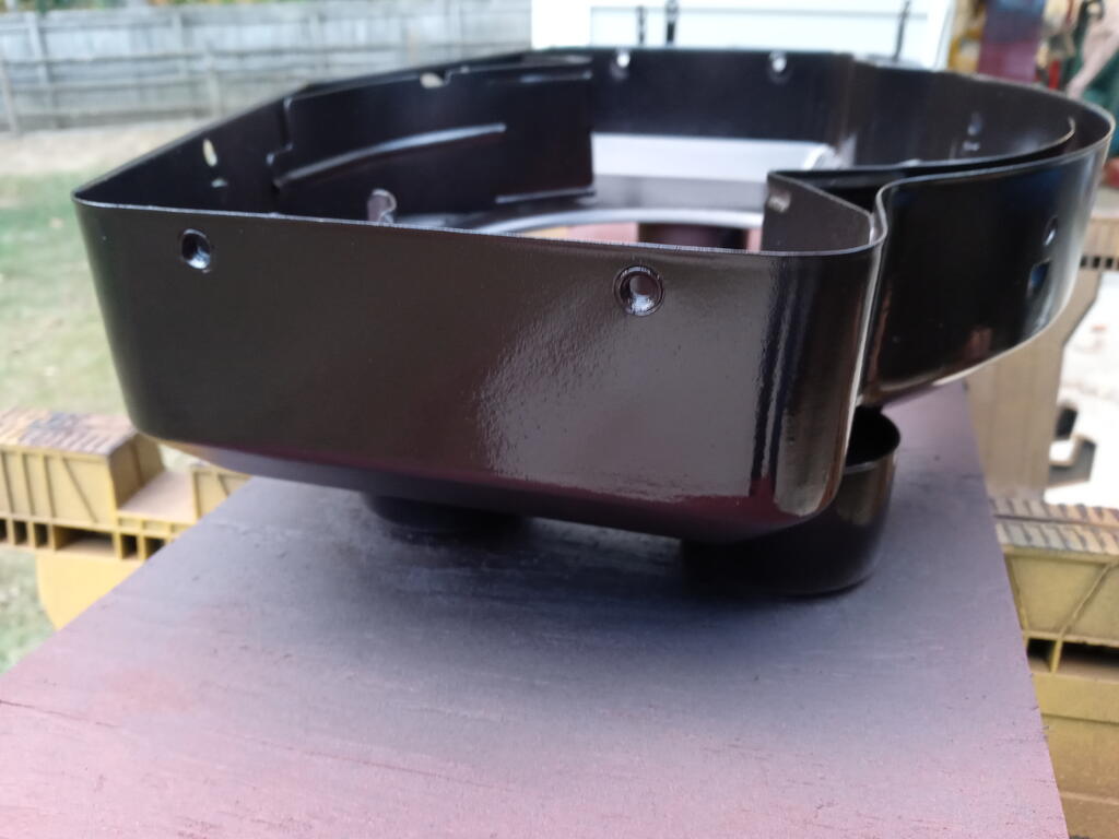

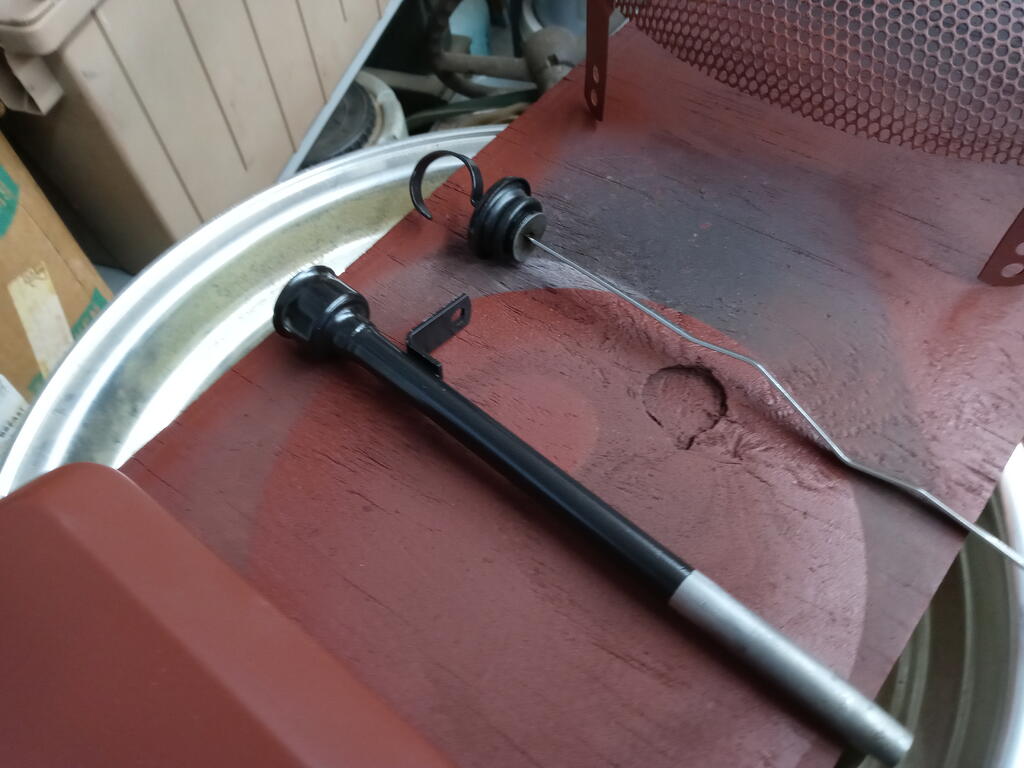

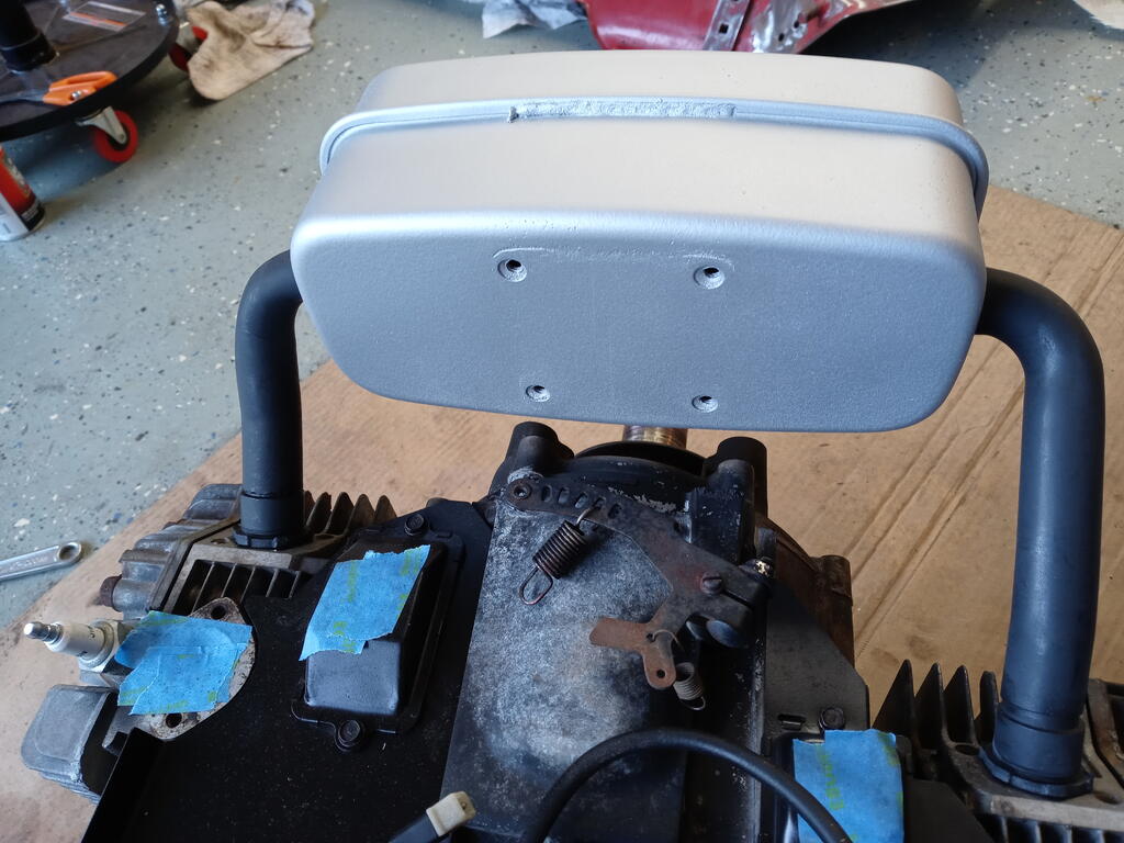

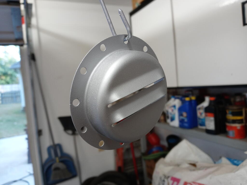

Horse Newbie 7,405 #138 Posted October 24, 2021 (edited) I am going to order a clutch disc from @76c12091520h ...and I am waiting on intake manifold gaskets, and paint. But that's no reason for me to drag my feet... So today I painted the exhaust pipes, muffler, muffler brackets, muffler bracket bolts, exhaust deflector, and the little screws for it... Painted the oil dipstick sleeve, and the top of the oil dipstick too. Edited October 24, 2021 by Horse Newbie 1 Share this post Link to post Share on other sites
Horse Newbie 7,405 #139 Posted October 24, 2021 Got a question... When I unbolted the clutch disc I noted that the 4 bolts had a flat "crescent" shaped piece of flat metal behind 2, and another "crescent" shaped piece of flat metal behind the other 2... Are the corners of those flat pieces of metal supposed to be bent up against the bolt heads to keep the bolts from backing out ? (mine weren't bent up) Share this post Link to post Share on other sites

76c12091520h 4,301 #143 Posted October 25, 2021 29 minutes ago, Horse Newbie said: Got a question... When I unbolted the clutch disc I noted that the 4 bolts had a flat "crescent" shaped piece of flat metal behind 2, and another "crescent" shaped piece of flat metal behind the other 2... Are the corners of those flat pieces of metal supposed to be bent up against the bolt heads to keep the bolts from backing out ? (mine weren't bent up) They should stay flat, the retaining bolts originally had just a dab of Loctite on them. 1 Share this post Link to post Share on other sites

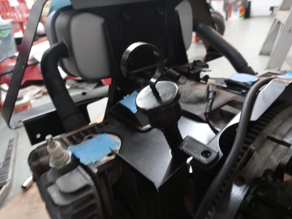

Horse Newbie 7,405 #145 Posted October 25, 2021 (edited) Bolted some exhaust brackets back on, and slipped my oil dipstick back in... My new decals for the 1984 Work Horse GT-1600 arrived from @Vinylguy ! Edited October 26, 2021 by Horse Newbie 2 1 Share this post Link to post Share on other sites

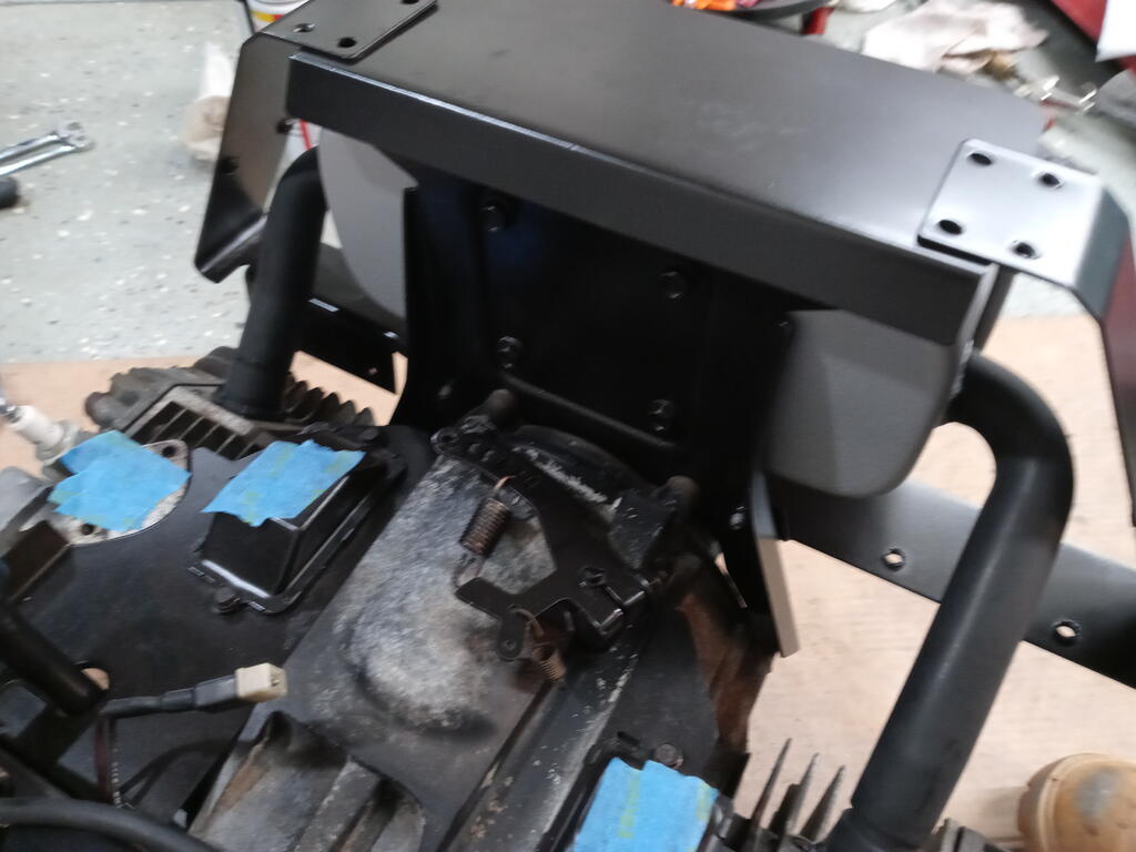

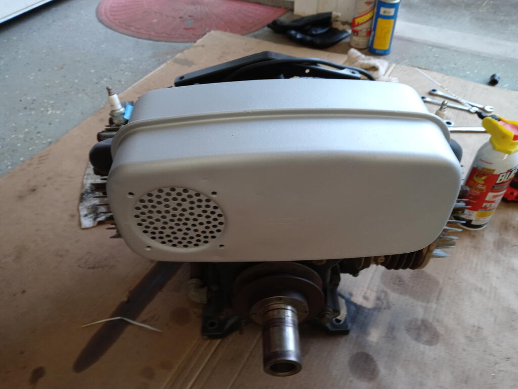

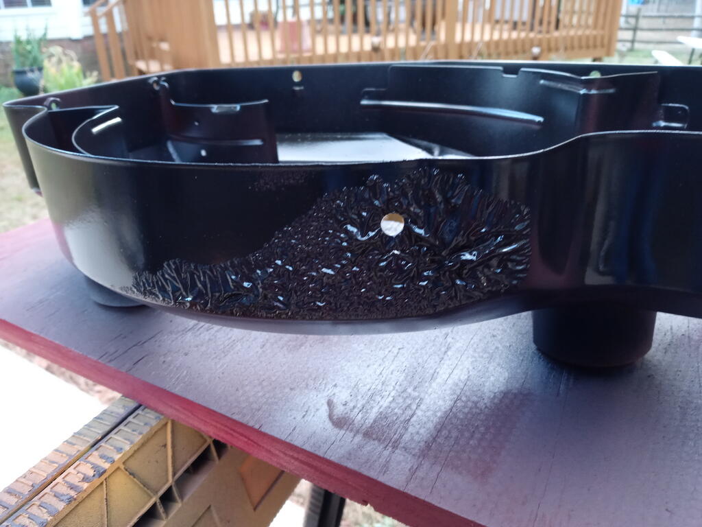

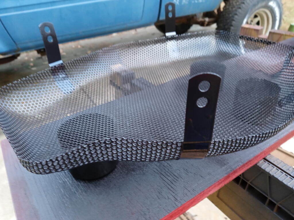

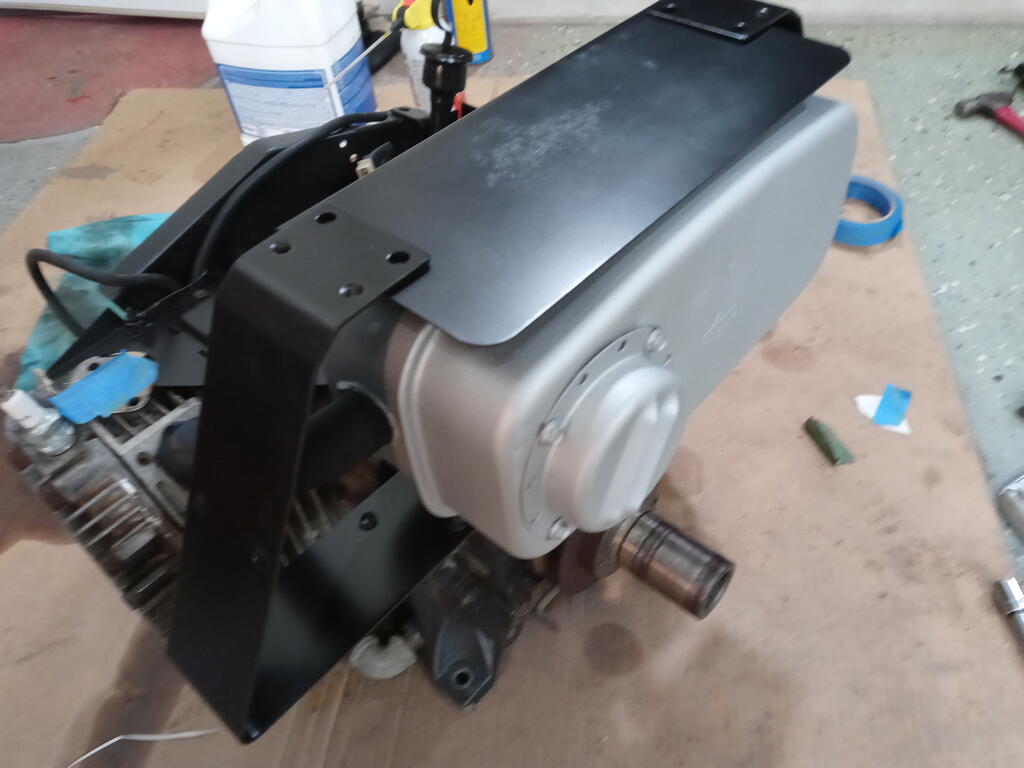

Horse Newbie 7,405 #146 Posted October 27, 2021 The Rustoleum Satin Black I had ordered came today...which I guess motivated me to put some Rustoleum High Heat Black on the Briggs Twin blower shroud and chaff screen. Dang it man !... I got some paint wrinkle on the blower housing. I will be glad when the intake gaskets get here so I can get the engine back on the tractor. I have to touch up some of the frame with the Satin Black before I can set the engine back on though. .. 4 Share this post Link to post Share on other sites
ebinmaine 81,283 #147 Posted October 27, 2021 4 minutes ago, Horse Newbie said: . .. A little oil left on it? Share this post Link to post Share on other sites
Horse Newbie 7,405 #148 Posted October 27, 2021 3 minutes ago, ebinmaine said: A little oil left on it? Should not have been...after cleaning it up, and sanding it, I blew off the sanding dust, washed my hands, wiped it liberally with a clean, lent free cloth soaked in paint thinner, blow dried the part, then primed. Sat in my shop maybe 2 days with primer...tried to paint it black today...and walla ! You don't reckon the 2 days sitting caused it do ya ? Share this post Link to post Share on other sites
ebinmaine 81,283 #149 Posted October 27, 2021 4 minutes ago, Horse Newbie said: Should not have been...after cleaning it up, and sanding it, I blew off the sanding dust, washed my hands, wiped it liberally with a clean, lent free cloth soaked in paint thinner, blow dried the part, then primed. Sat in my shop maybe 2 days with primer...tried to paint it black today...and walla ! You don't reckon the 2 days sitting caused it do ya ? I see two possibilities. Could be more. 1. blow dried the part. That should be done BEFORE the cloth wiping with solvent. Could be residue in the air hose, nozzle etc. 2. Sat in my shop maybe 2 days with primer. I don't have a can handy but I think the Rust-Oleum 2X states something like top coat within ((??)) Hours or wait minimum one week. I'm wondering if maybe the primer hadn't cured enough. Share this post Link to post Share on other sites
rjg854 13,454 #150 Posted October 27, 2021 If I remember correctly, within an hour, or after 48 hours. I just got done painting engine parts myself. 1 Share this post Link to post Share on other sites
