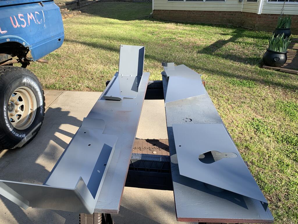

kpinnc 19,107 #951 Posted March 13, 2022 6 hours ago, Horse Newbie said: Rustoleum Smoke Gray Did you decide to go with that overall for the sheetmetal? Looks great! 1 Share this post Link to post Share on other sites
Horse Newbie 7,405 #952 Posted March 13, 2022 8 minutes ago, kpinnc said: Did you decide to go with that overall for the sheetmetal? Looks great! Yes, I did. I wanted something a little lighter as I believe the Work Horses were lighter than the Rustoleum Smoke Gray, but with the short supply of spray paints, I decided to use what I could get before it’s all gone. Thanks for the compliment… not perfect, but good enough for me. 1 Share this post Link to post Share on other sites

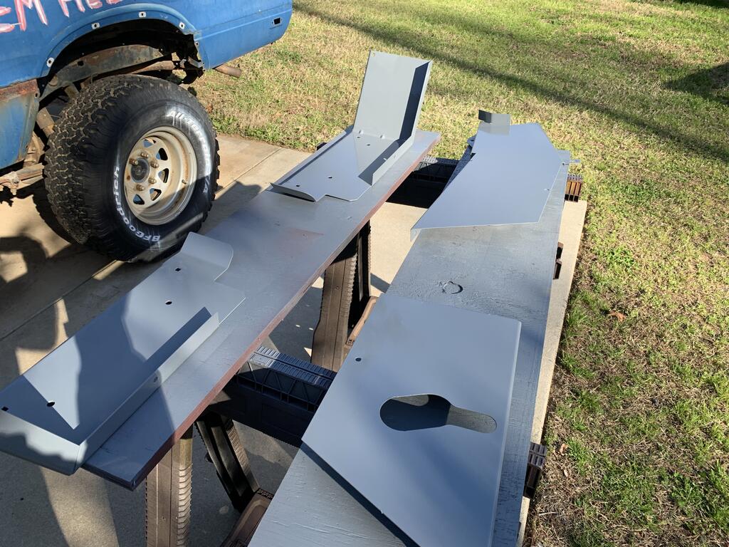

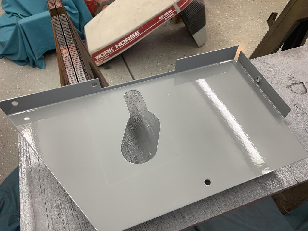

Horse Newbie 7,405 #954 Posted March 15, 2022 (edited) Laid down some more Rustoleum… Edited March 15, 2022 by Horse Newbie 7 Share this post Link to post Share on other sites

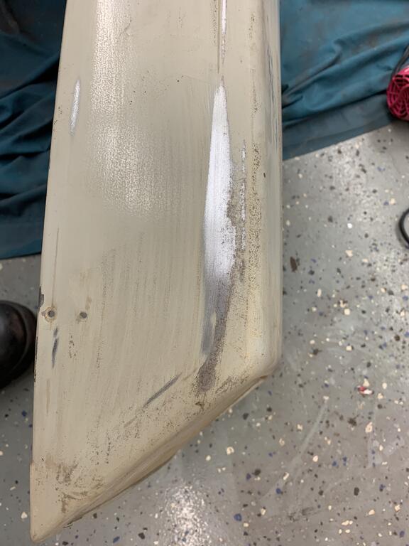

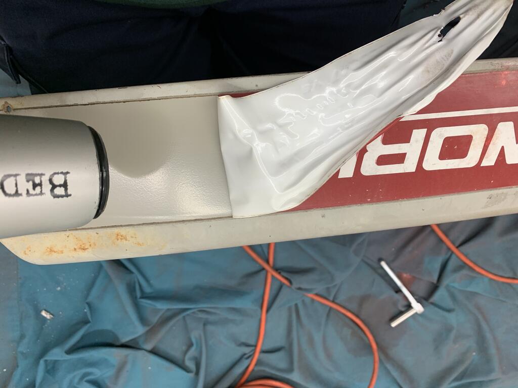

Horse Newbie 7,405 #961 Posted March 19, 2022 Started taking off decals so I can sand the hood… Then I started sanding the hood… According to the color of the paint underneath the decals, Rustoleum Smoke Gray is going to be pretty close. 6 Share this post Link to post Share on other sites
kpinnc 19,107 #962 Posted March 19, 2022 I can't wait to see this one finished! 2 Share this post Link to post Share on other sites
Moparfanforever 940 #963 Posted March 19, 2022 40 minutes ago, kpinnc said: I can't wait to see this one finished! 1 Share this post Link to post Share on other sites
Horse Newbie 7,405 #964 Posted March 19, 2022 1 hour ago, kpinnc said: I can't wait to see this one finished! Meeee Toooo ! Don’t expect too much… I just can’t seem to go all the way… and I’m about tired of sanding… had a run in the seat pan. Rustoleum spray bomb does not sand too well ! 1 Share this post Link to post Share on other sites
Lee1977 7,813 #965 Posted March 20, 2022 (edited) 13 hours ago, Horse Newbie said: Meeee Toooo ! Don’t expect too much… I just can’t seem to go all the way… and I’m about tired of sanding… had a run in the seat pan. Rustoleum spray bomb does not sand too well ! You need to buy sand able primer. Regular Rustoleum takes along time to dry completely and gums up when sanding. Wet sanding with good wet dry sand paper helps but it needs to be completely dry. Edited March 20, 2022 by Lee1977 1 Share this post Link to post Share on other sites
Horse Newbie 7,405 #966 Posted March 20, 2022 35 minutes ago, Lee1977 said: You need to buy sand able primer. Regular Rustoleum takes along time to dry completely and gums up when sanding. Wet sanding with good wet dry sand paper helps but it needs to be completely dry. Actually the primer did okay… it was the top coat/ Rustoleum Smoke Gray that gummed up. And since I was sanding a run, the paint was thicker. Share this post Link to post Share on other sites

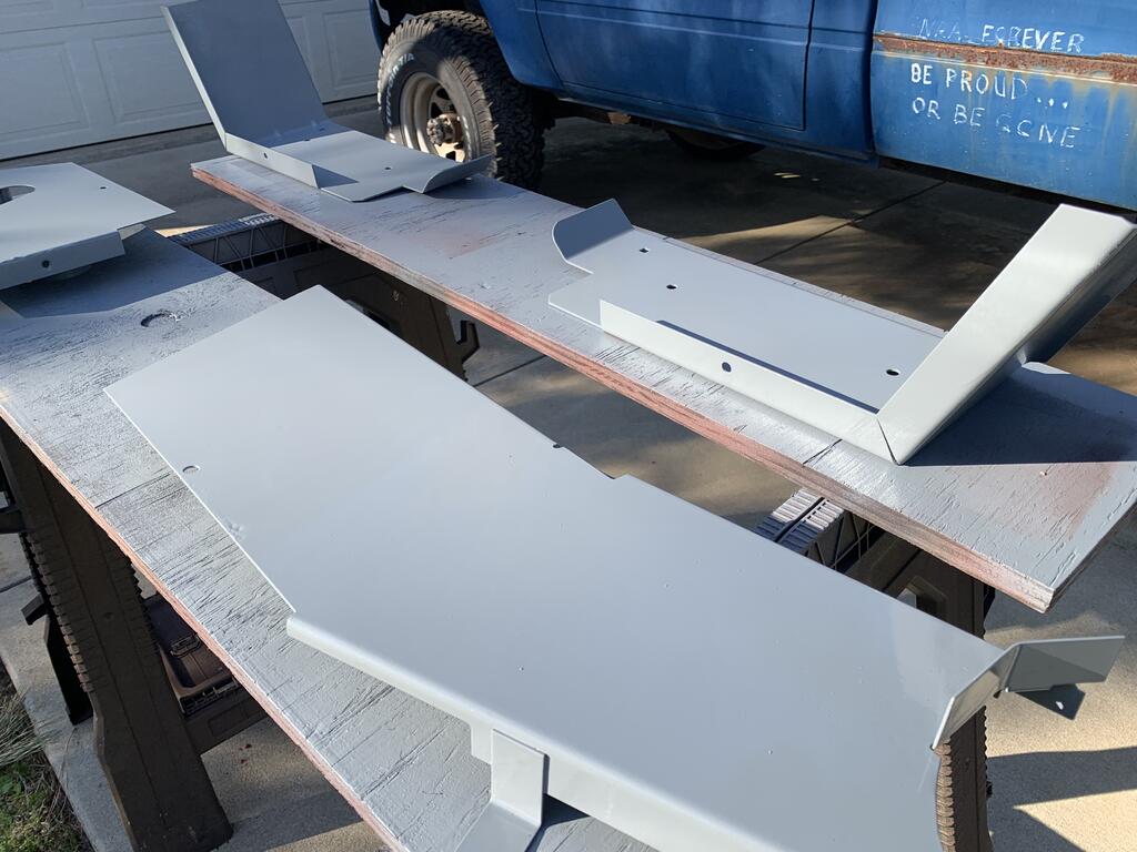

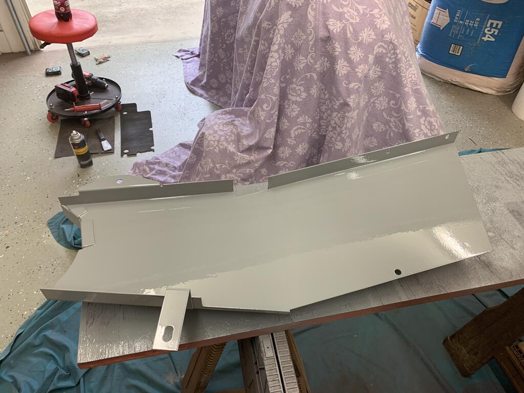

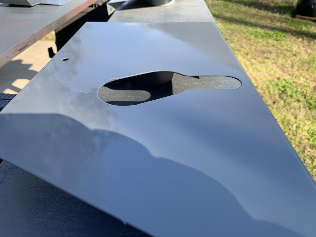

Horse Newbie 7,405 #967 Posted March 22, 2022 (edited) Laid some more paint down on the running boards, belt guard, and left side panel. All I have left to paint is the hood ( more sanding to be done ), and the air cleaner box… I think… Now that I painted the parts, next pull weeds in the flower beds… Edited March 22, 2022 by Horse Newbie 1 5 Share this post Link to post Share on other sites
ebinmaine 81,283 #968 Posted March 22, 2022 6 minutes ago, Horse Newbie said: left to paint is the hood Any special extra care being taken for a smoother top surface? Nice glassy hood paint ? 1 Share this post Link to post Share on other sites
Horse Newbie 7,405 #969 Posted March 22, 2022 15 minutes ago, ebinmaine said: Any special extra care being taken for a smoother top surface? Nice glassy hood paint ? Never heard of “hood paint “… I will do my best to sand carefully and try not to get the runs, but like all the previously painted pieces, the hood will probably have at least a bug and some dust specs… I can’t help it… I have to know my limitations… 2 1 2 Share this post Link to post Share on other sites
Horse Newbie 7,405 #970 Posted March 22, 2022 (edited) @ebinmaine, do the side panels and footboards not look smooth enough ? I’m just gonna kick ‘‘em with my big feet anyhows… Edited March 22, 2022 by Horse Newbie 2 Share this post Link to post Share on other sites
ebinmaine 81,283 #971 Posted March 22, 2022 2 minutes ago, Horse Newbie said: @ebinmaine, do the side panels and footboards not look smooth enough ? I’m just gonna kick ‘‘em with my big feet anyhows… Oh no no no. They're perfectly fine. I was just wondering if you were going to go for some kind of awesomeness on the upper Sunshine glinting area. 2 Share this post Link to post Share on other sites
Horse Newbie 7,405 #972 Posted March 22, 2022 15 minutes ago, ebinmaine said: Oh no no no. They're perfectly fine. I was just wondering if you were going to go for some kind of awesomeness on the upper Sunshine glinting area. Awesomeness is VERY HARD for me… if I can achieve mediocre, I’ll be happy ! 1 3 Share this post Link to post Share on other sites
