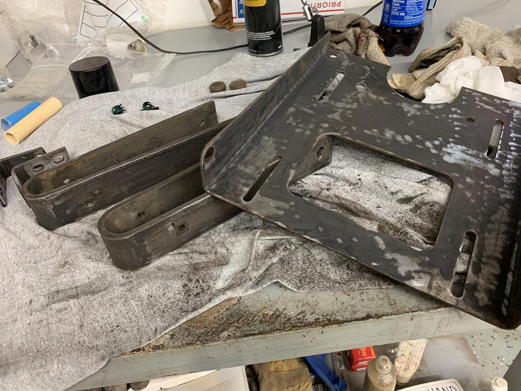

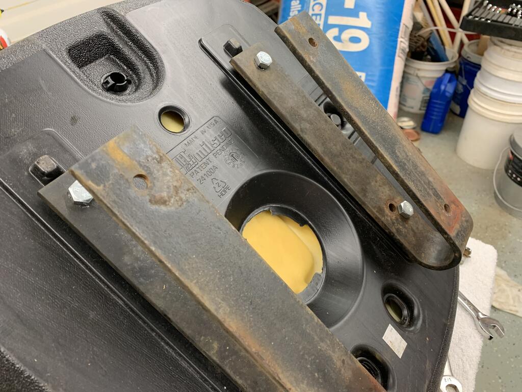

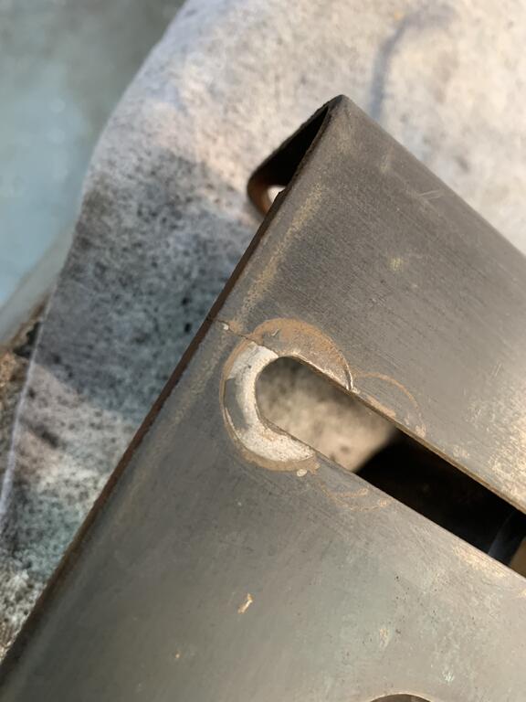

Horse Newbie 7,405 #903 Posted February 20, 2022 (edited) On 2/18/2022 at 5:59 PM, ebinmaine said: Got the new holes drilled, ground, hacked into the seat springs and did a test fit… then I went to sanding the seat hardware. Found a crack in the seat bracket that will have to be welded… Edited February 20, 2022 by Horse Newbie 4 Share this post Link to post Share on other sites

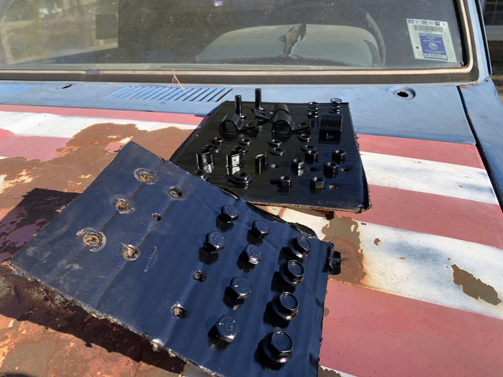

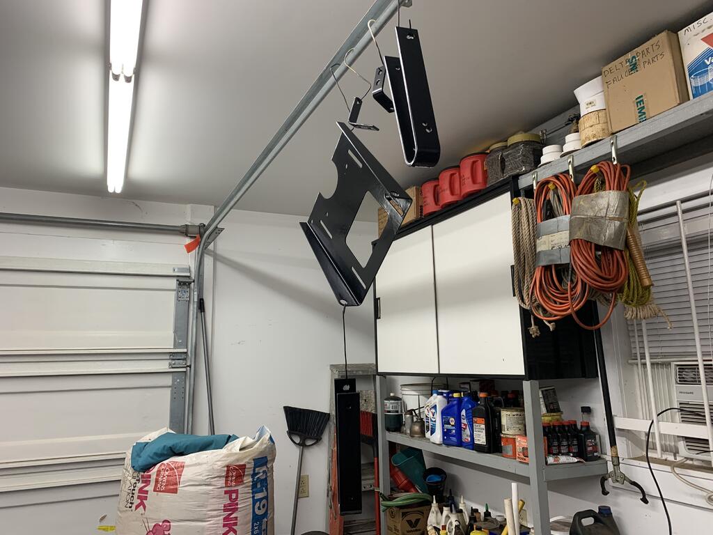

Horse Newbie 7,405 #904 Posted February 20, 2022 Got some hardware and do-dads painted… 4 4 Share this post Link to post Share on other sites

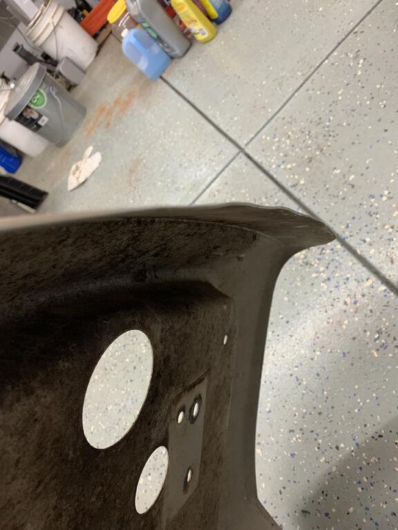

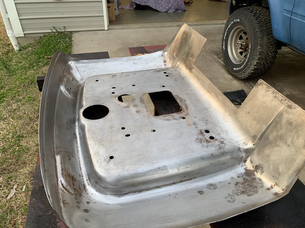

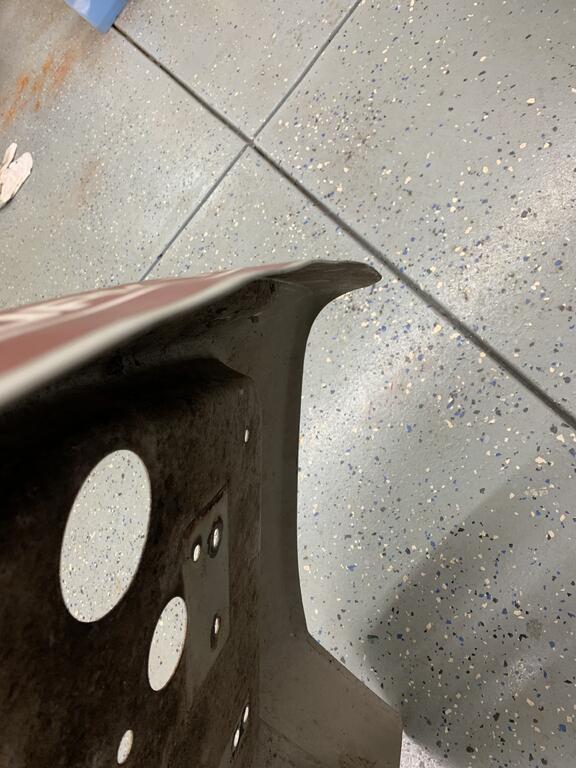

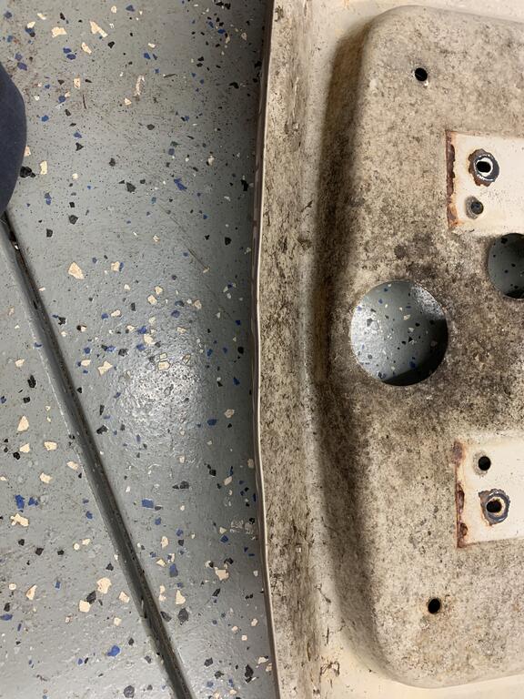

Horse Newbie 7,405 #905 Posted February 20, 2022 Starting to mull over painting the seat pan, hood, side panels, and running boards. I’m thinking I will do the seat pan first… that way I can still take it for a spin before the tractors done… Anyways, look at the back edge of the seat pan. It has been bent a little. Would you guys fix this ? ( I know some of you will say yes ! ) The only way I know how is maybe lay it on a thick folded towel and wack it will a rubber mallet… but I am concerned with making another dent. 2 1 Share this post Link to post Share on other sites
TJ5208 1,841 #906 Posted February 20, 2022 (edited) 1 minute ago, Horse Newbie said: Starting to mull over painting the seat pan, hood, side panels, and running boards. I’m thinking I will do the seat pan first… that way I can still take it for a spin before the tractors done… Anyways, look at the back edge of the seat pan. It has been bent a little. Would you guys fix this ? ( I know some of you will say yes ! ) The only way I know how is maybe lay it on a thick folded towel and wack it will a rubber mallet… but I am concerned with making another dent. The dent is tiny might do more damage than good. Edited February 20, 2022 by TJ Salyers 1 Share this post Link to post Share on other sites
ebinmaine 81,283 #907 Posted February 20, 2022 2 minutes ago, Horse Newbie said: Would you guys fix this ? ( I know some of you will say yes ! ) The only way I know how is maybe lay it on a thick folded towel and wack it will a rubber mallet… but I am concerned with making another dent I'd at least flatten it out a little. Massage carefully and slowly. Don't just smack the @#$&#@ it of it. 1 Share this post Link to post Share on other sites
SylvanLakeWH 32,921 #908 Posted February 20, 2022 I’d use a solid backer - small 2x4 perhaps - and gently tap her back into shape… 4 Share this post Link to post Share on other sites
Horse Newbie 7,405 #909 Posted February 20, 2022 1 hour ago, ebinmaine said: Don't just smack the @#$&#@ it of it. You’re getting to know me… 2 Share this post Link to post Share on other sites
Lee1977 7,813 #910 Posted February 20, 2022 You only learn when you try. We need a better picture looking from the out side. Is it bent into the offset up about 3/4" or just the edge, 2 Share this post Link to post Share on other sites

Lee1977 7,813 #912 Posted February 21, 2022 1 minute ago, Horse Newbie said: You talking about the Work Horse seat pan ? All the others have a 1/16" off set up 3/4" don't know about a Work Horse. My guess is they didn't change as it would have cost them more to change it. 1 Share this post Link to post Share on other sites
Jeff-C175 7,212 #913 Posted February 21, 2022 The only thing that might concern me about trying to get that dent out is that when metal bends, it also STRETCHES. You might find that when you try to take out the bend that you end up moving the dent to another area. But I would try myself. Tap a few times and evaluate. Continue if successful, or stop and live with it if not. 2 Share this post Link to post Share on other sites
Horse Newbie 7,405 #914 Posted February 21, 2022 (edited) Yeah… I GOTTA mess with it a little… but most likely will move the dent like you say. Not gonna get crazy with it… It is actually dented up where the “Work Horse” label is… not too bad but it is there. Edited February 21, 2022 by Horse Newbie Share this post Link to post Share on other sites
Lee1977 7,813 #915 Posted February 21, 2022 (edited) If you need help with it bring it up I have most of a old set of body tools, hammers and dolly's. Those areas need support on the other side when hammering them and they are not completely flat. Kelvin's suppose to come over tomorrow afternoon some time around 5:00 we could have a mini get together. If you would like to come up let me know I'll PM you my address. . Edited February 21, 2022 by Lee1977 3 Share this post Link to post Share on other sites

Horse Newbie 7,405 #917 Posted February 21, 2022 Probably should take that decal off first, huh ? Share this post Link to post Share on other sites
Lee1977 7,813 #918 Posted February 21, 2022 Just now, Horse Newbie said: I don’t have Monday off… Saturdays would be a much easier day for me… You work after 5:00 PM. 1 Share this post Link to post Share on other sites
SylvanLakeWH 32,921 #919 Posted February 21, 2022 1 minute ago, Horse Newbie said: Probably should take that decal off first, huh ? Yes. 1 Share this post Link to post Share on other sites

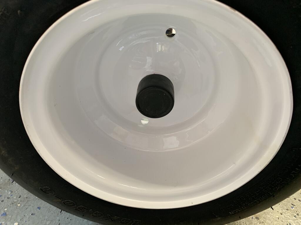

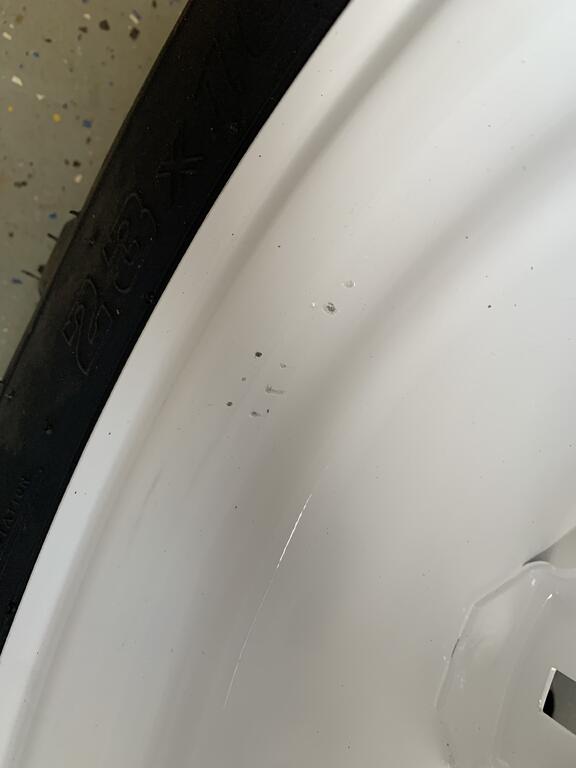

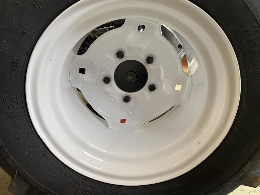

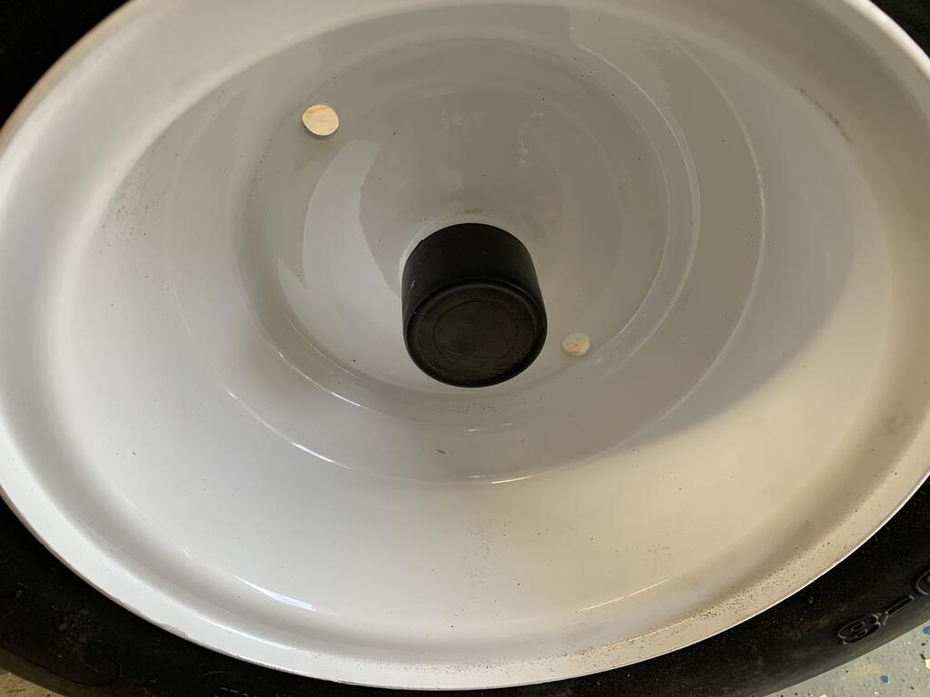

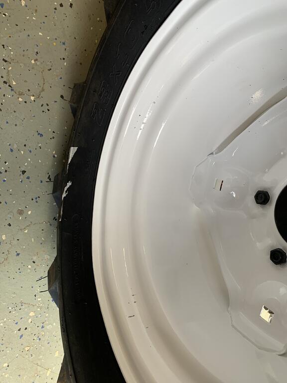

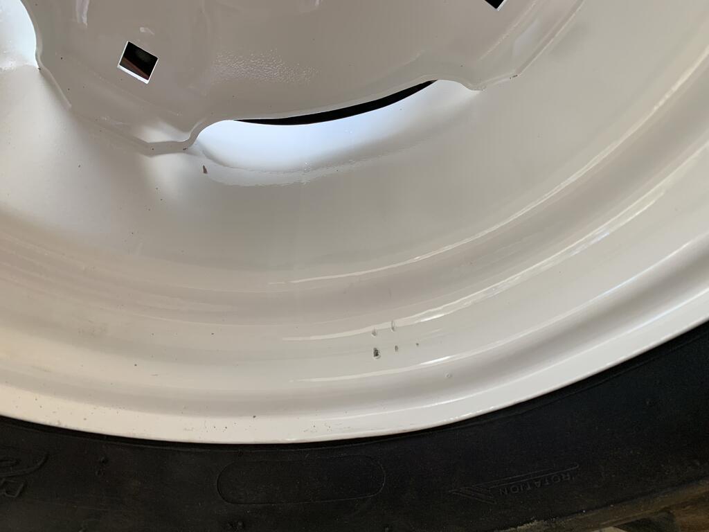

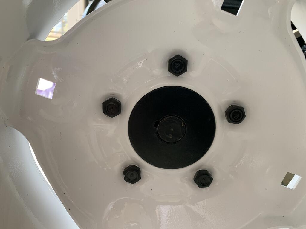

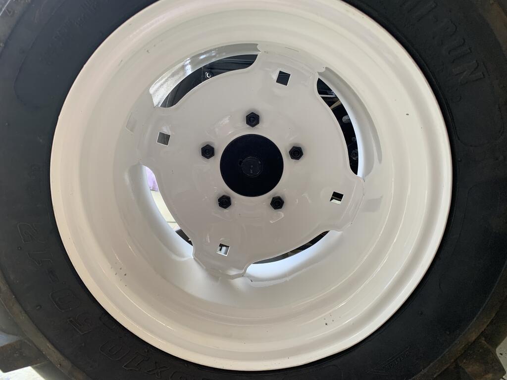

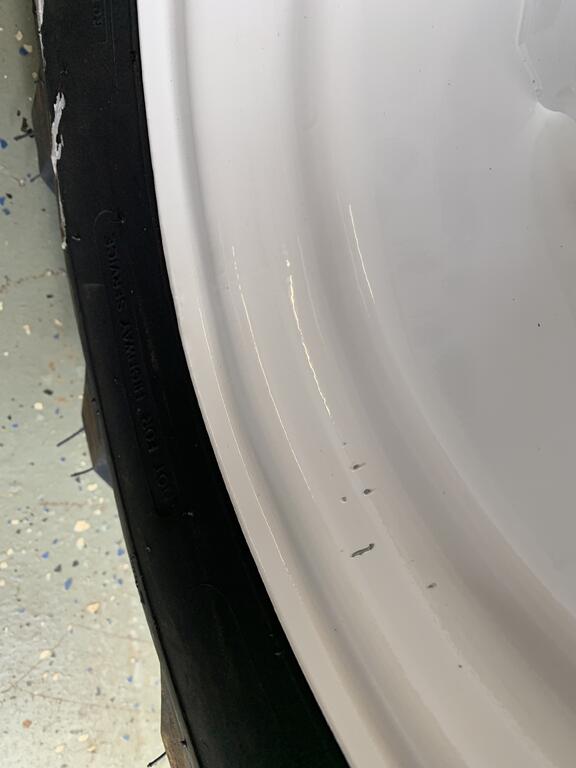

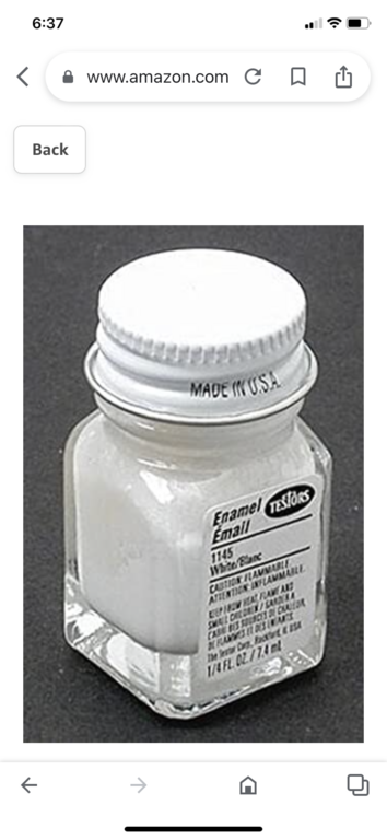

Horse Newbie 7,405 #920 Posted February 22, 2022 (edited) On 2/12/2022 at 3:57 PM, Horse Newbie said: Had my tires put on my rims… a little disturbed that they scratched my wheels a little… the man warned me that they may get scratched. Oh well it’s a tractor, not a trailer queen… Not gonna try to touch them up… that would probably look worse… On the fronts… are those black plastic spindle caps supposed to just snap on the large washer, or slide down on the wheel hub a little ? @kpinnc… I believe you suggested touching up the scratches ON MY FRESHLY POWDER COATED ! wheels and I looked online for for Testers model car paint. I seen some enamel paint on there in the little bottles. Would enamel be okay to touch up powder coated wheels ? Also have you seen it at Walmart ? Edited February 23, 2022 by Horse Newbie 1 Share this post Link to post Share on other sites

Jeff-C175 7,212 #922 Posted February 23, 2022 2 hours ago, Horse Newbie said: POWDER COATED I been wondering about this myownself. Powder coating is basically melted to form the coating. Can it be re-activated? What if one were to sprinkle some powder into a scratch and somehow apply heat to fuse it to the existing? Would this work? 2 Share this post Link to post Share on other sites
ebinmaine 81,283 #923 Posted February 23, 2022 51 minutes ago, Jeff-C175 said: I been wondering about this myownself. Powder coating is basically melted to form the coating. Can it be re-activated? What if one were to sprinkle some powder into a scratch and somehow apply heat to fuse it to the existing? Would this work? I'd be prone to asking the powdercoaterizerer. I like the idea. 2 Share this post Link to post Share on other sites

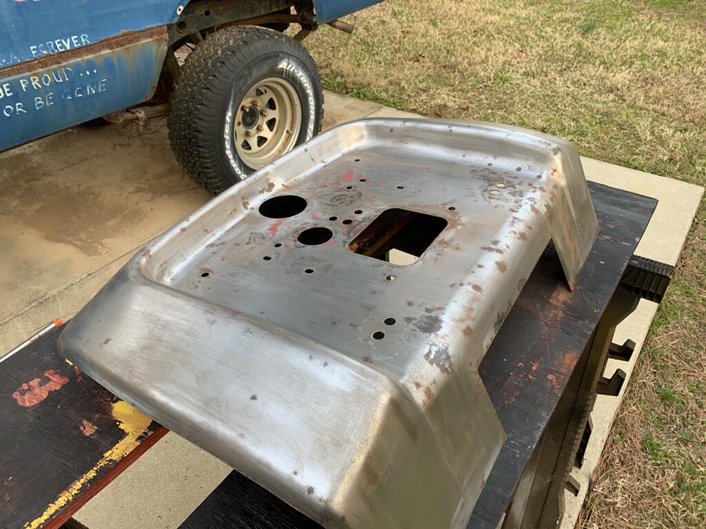

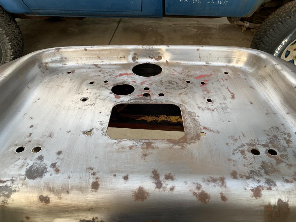

Horse Newbie 7,405 #924 Posted March 5, 2022 Sanded, sanded, sanded, the donated seat pan for the Work Horse… Almost ready for primer… 4 3 Share this post Link to post Share on other sites

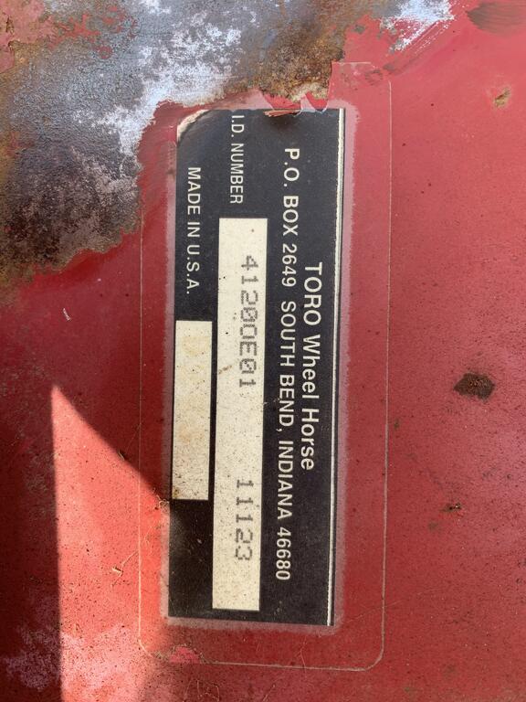

Horse Newbie 7,405 #925 Posted March 5, 2022 @kpinnc… with model number 4120OE01, the seat pan you gave me appears to be off of a 520. 2 Share this post Link to post Share on other sites
