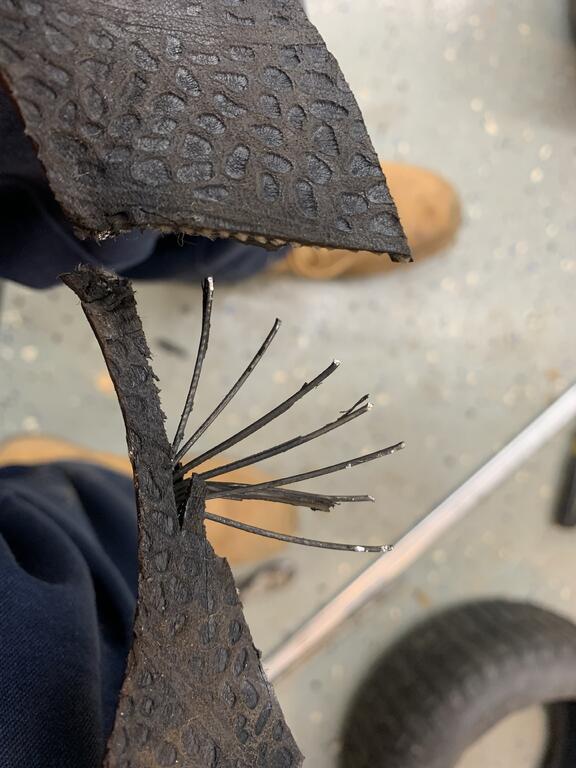

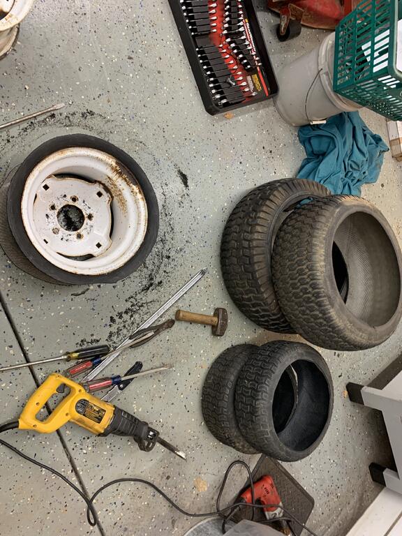

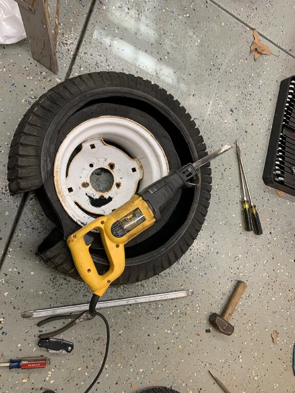

Horse Newbie 7,405 #729 Posted January 29, 2022 Okay… thought I’d get off the couch and take the tires off of the rims for the Work Horse… never again ! I was wanting to get the rims ready for the sandblasting and powder coat shop. From now on they will go to the lawn equipment shop ! I have a Harbor Freight mini tire changer, but I’ve practically wrecked that thing in the past trying to change tires… and if I mount it on my bench… too high, on the floor on a piece of plywood, not stable, wants to tip me over. So I wound up cutting the old tires off… not easy either… those sons of guns had 9, did I say 9 hardened wires around the bead. It ain’t worth the fuss ! 1 1 Share this post Link to post Share on other sites
SylvanLakeWH 32,584 #730 Posted January 29, 2022 I take them in and get them changed. For $10 it’s not worth the hassle to me… 2 Share this post Link to post Share on other sites
Horse Newbie 7,405 #731 Posted January 29, 2022 3 minutes ago, SylvanLakeWH said: I take them in and get them changed. For $10 it’s not worth the hassle to me… I think the place I go to charges $25 to dismount and mount… 2 Share this post Link to post Share on other sites
Lee1977 7,782 #732 Posted January 29, 2022 It's not all that hard I use a serrated Buck pocket knife and the cut the beads with a cutting disk and side grinder. Just have to careful not to cut the rim. i cut at a long angle to stay off the side of the rim. I've cut off 8 ply 12 x 24 tractor tires that way. 2 Share this post Link to post Share on other sites
Horse Newbie 7,405 #733 Posted January 29, 2022 My solution… more power ! 2 Share this post Link to post Share on other sites
Lee1977 7,782 #734 Posted January 29, 2022 4 minutes ago, Horse Newbie said: My solution… more power ! That works too. 1 1 Share this post Link to post Share on other sites
Horse Newbie 7,405 #735 Posted January 29, 2022 Yep ! 2 Share this post Link to post Share on other sites

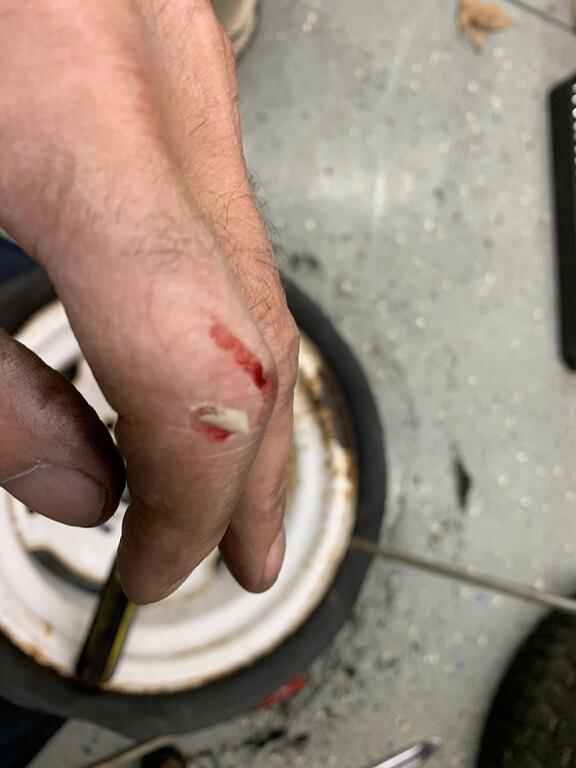

Horse Newbie 7,405 #736 Posted January 29, 2022 Not without it’s cost though… 1 1 1 Share this post Link to post Share on other sites
Lee1977 7,782 #737 Posted January 29, 2022 (edited) 5 minutes ago, Horse Newbie said: Not without it’s cost though… You taking lessons from Pullstart? Edited January 29, 2022 by Lee1977 2 Share this post Link to post Share on other sites
SylvanLakeWH 32,584 #738 Posted January 29, 2022 19 minutes ago, Lee1977 said: You taking lessons from Pullstart? Nah… finger would be in a baggy with ice on it… on way to … 3 Share this post Link to post Share on other sites
Horse Newbie 7,405 #739 Posted January 29, 2022 48 minutes ago, SylvanLakeWH said: said: You taking lessons from Pullstart? Maybe with enough of these someday I will be as experienced as him with the Horses. 1 Share this post Link to post Share on other sites

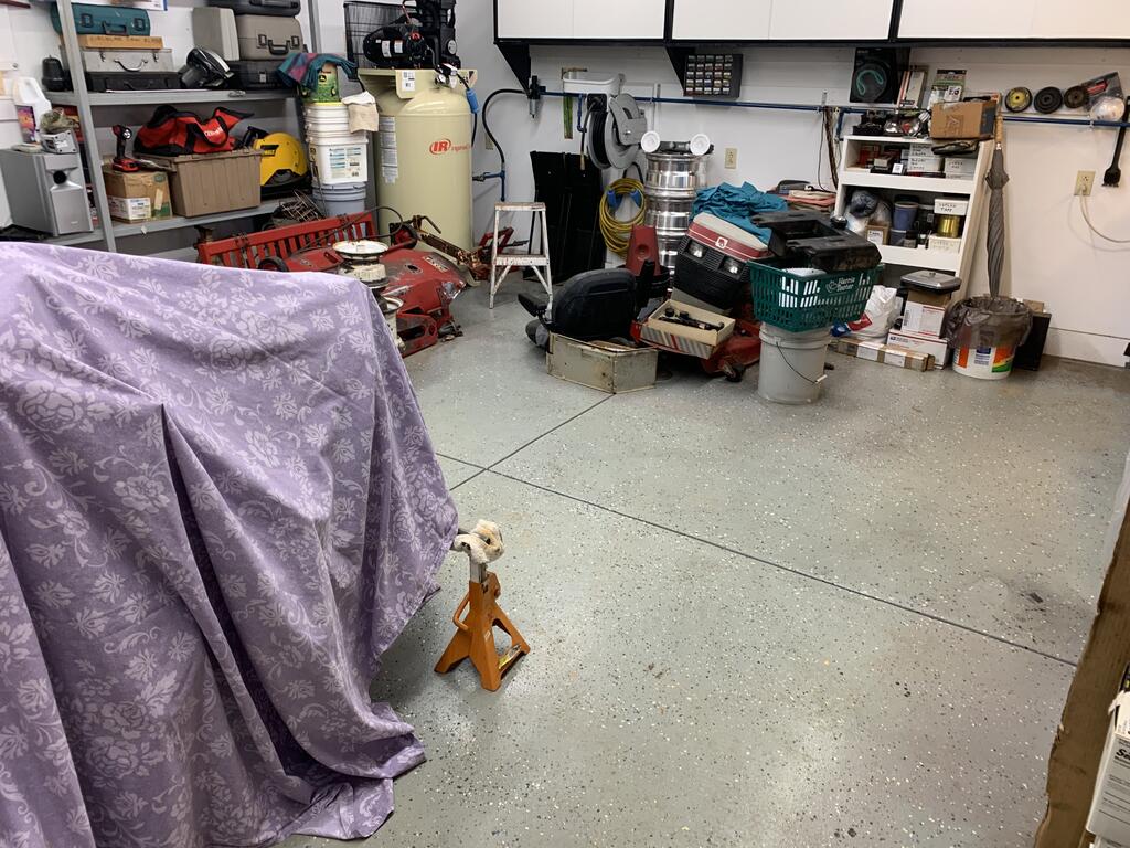

Horse Newbie 7,405 #740 Posted January 29, 2022 Had to straighten up a little to get more done ! 1 1 Share this post Link to post Share on other sites

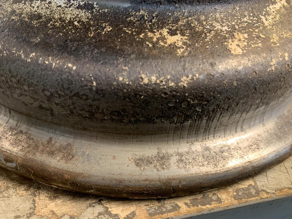

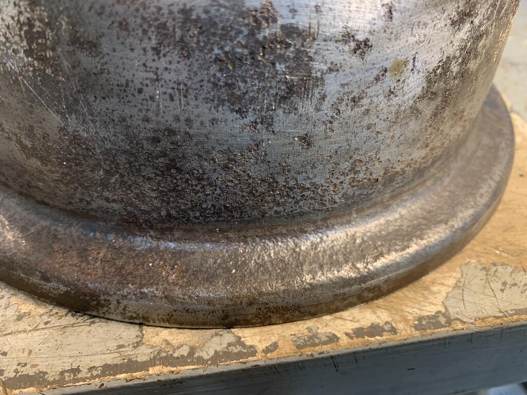

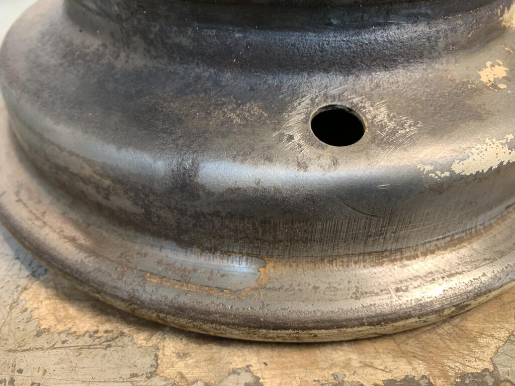

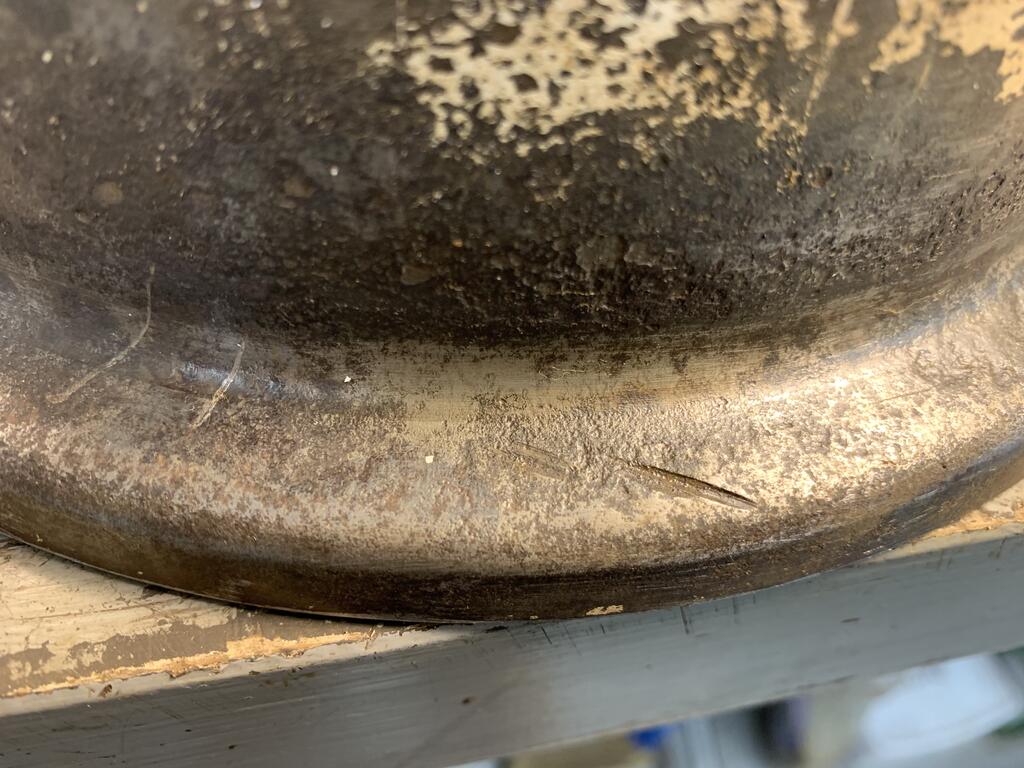

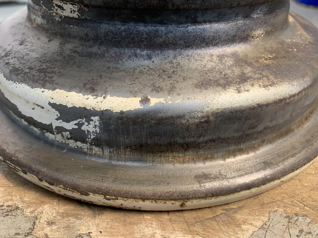

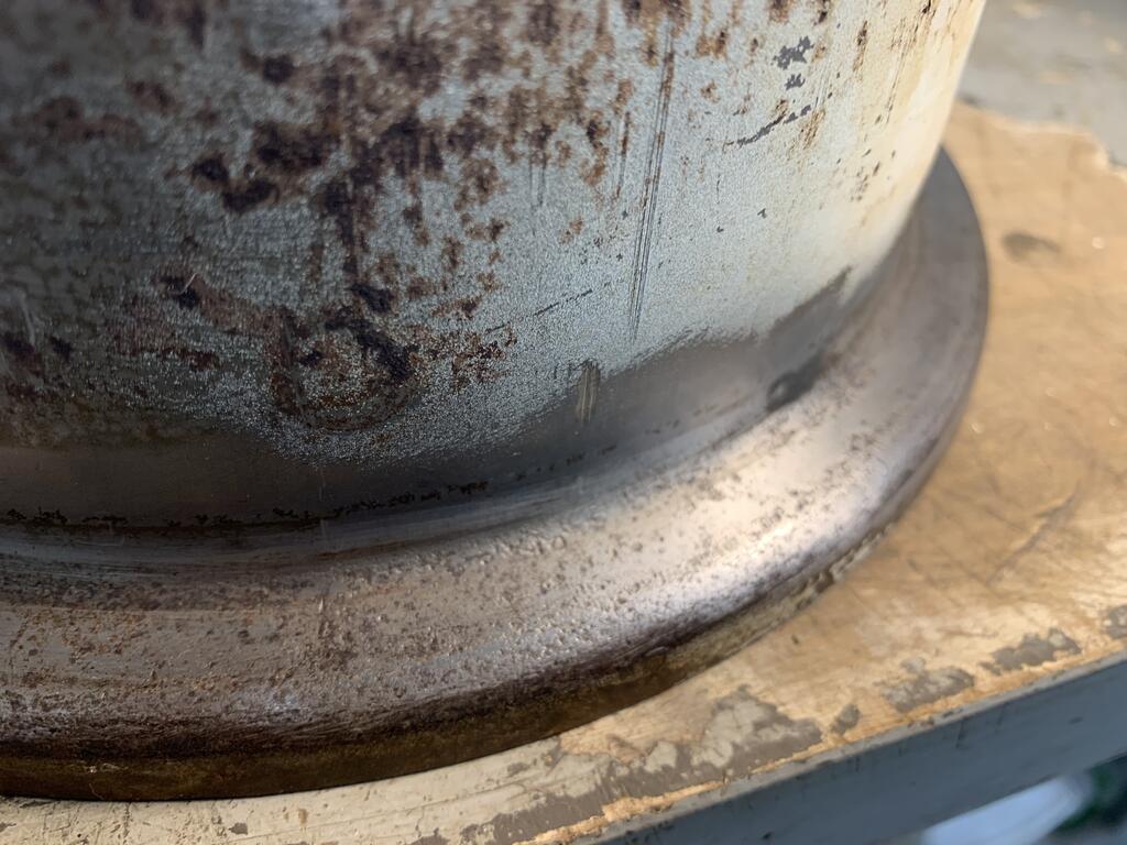

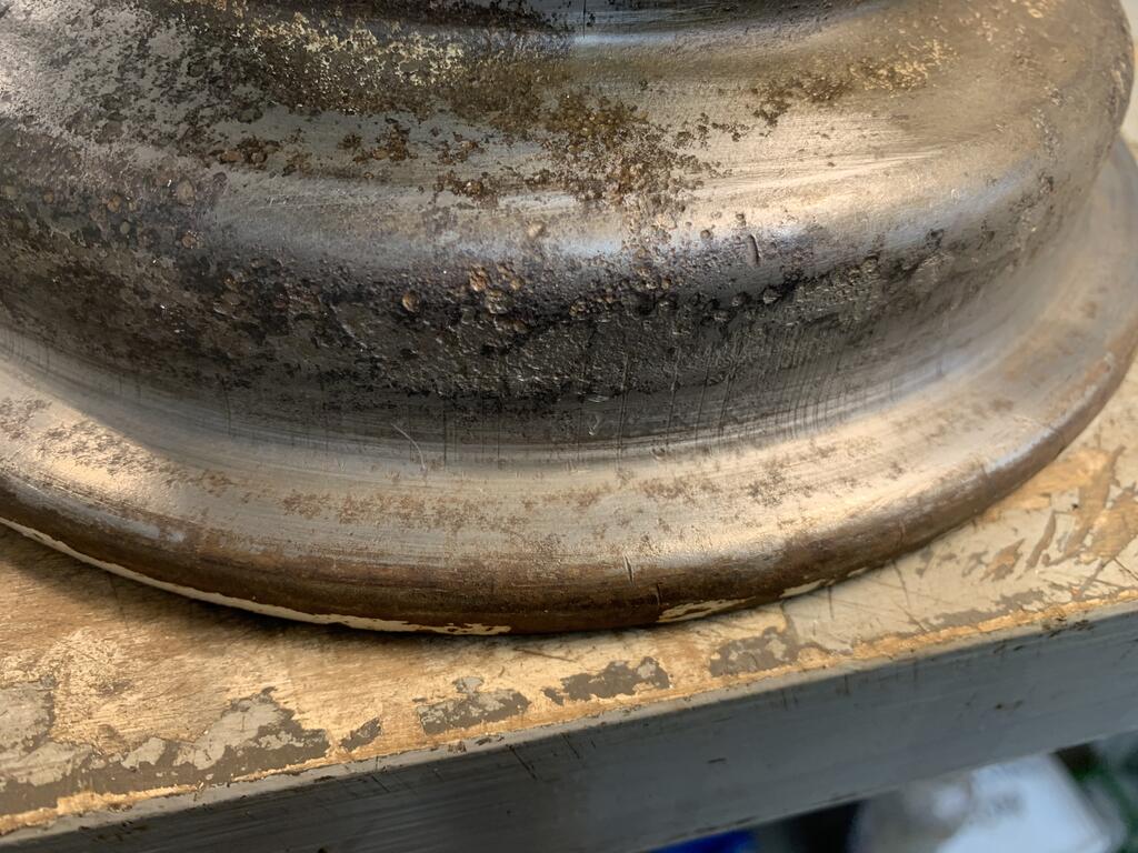

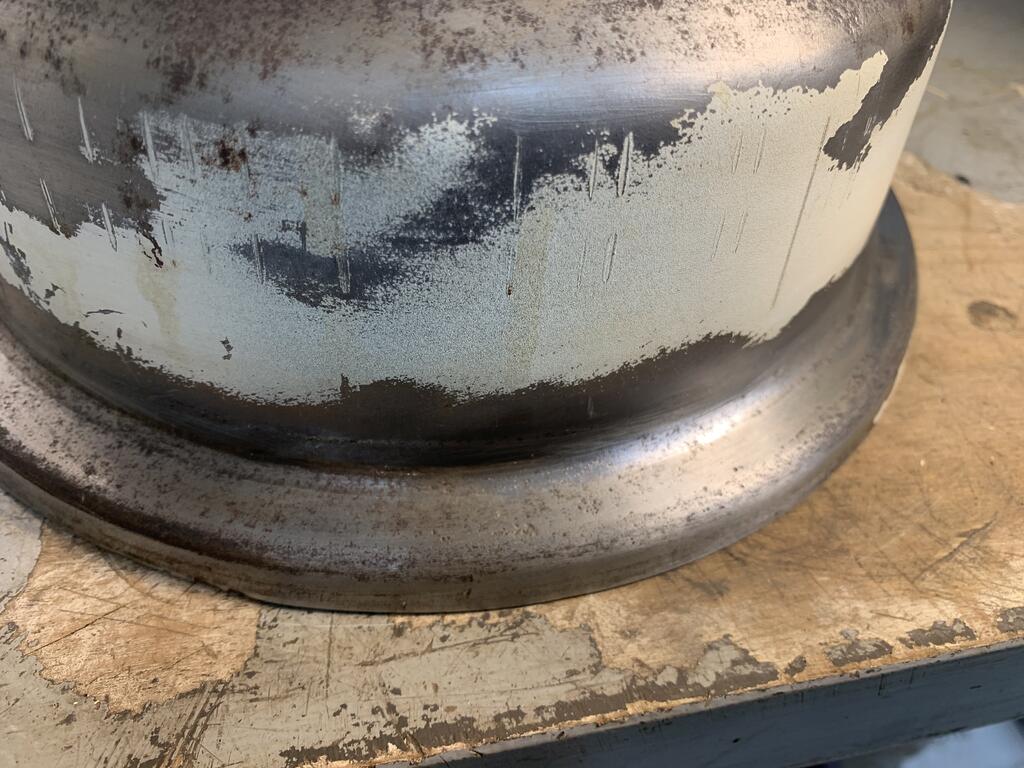

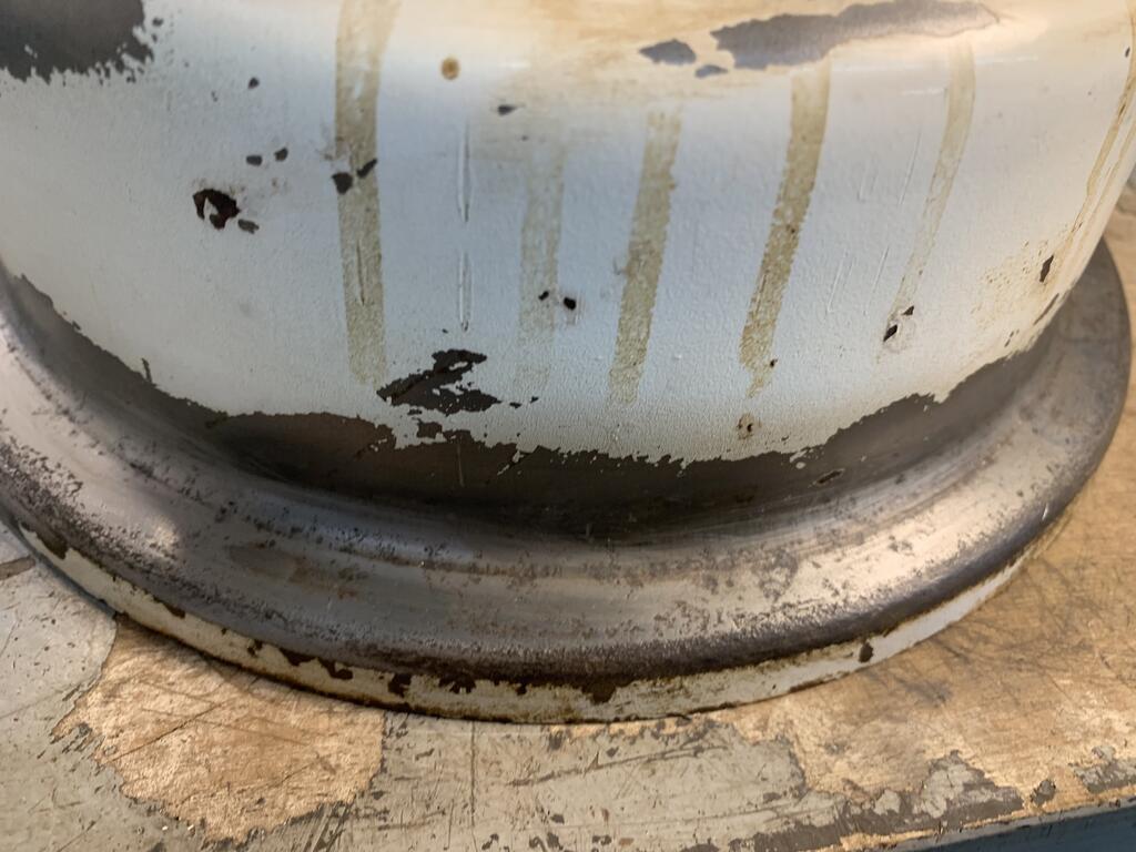

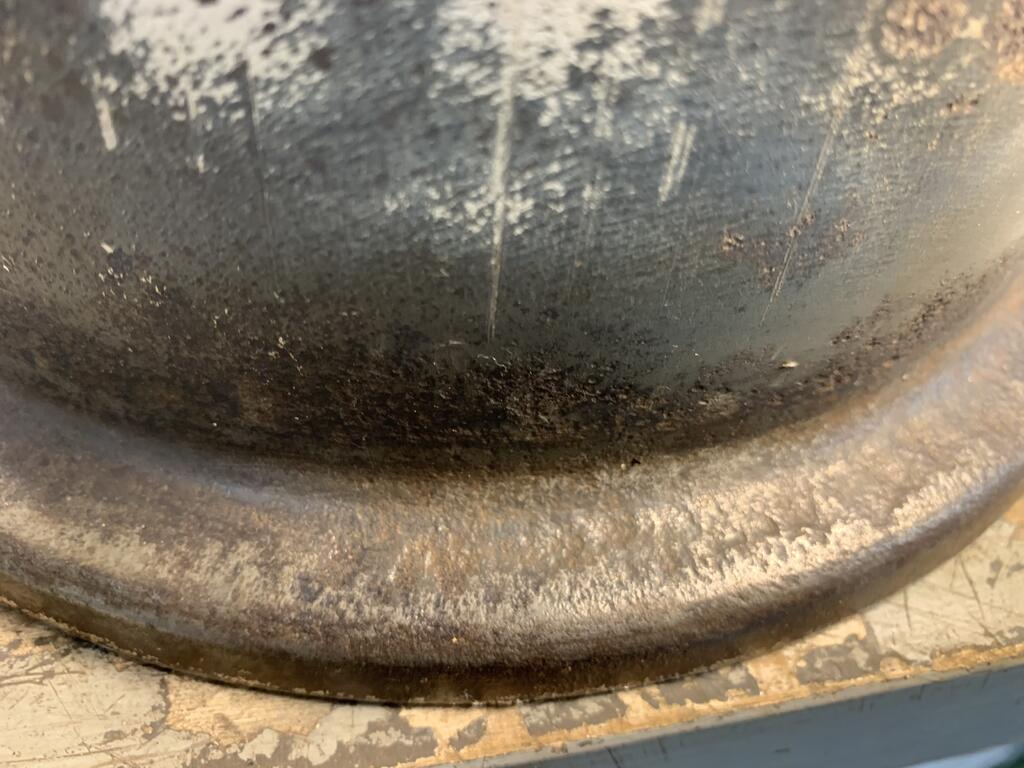

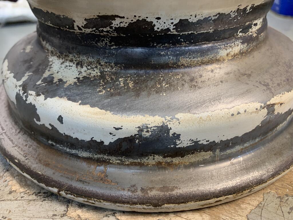

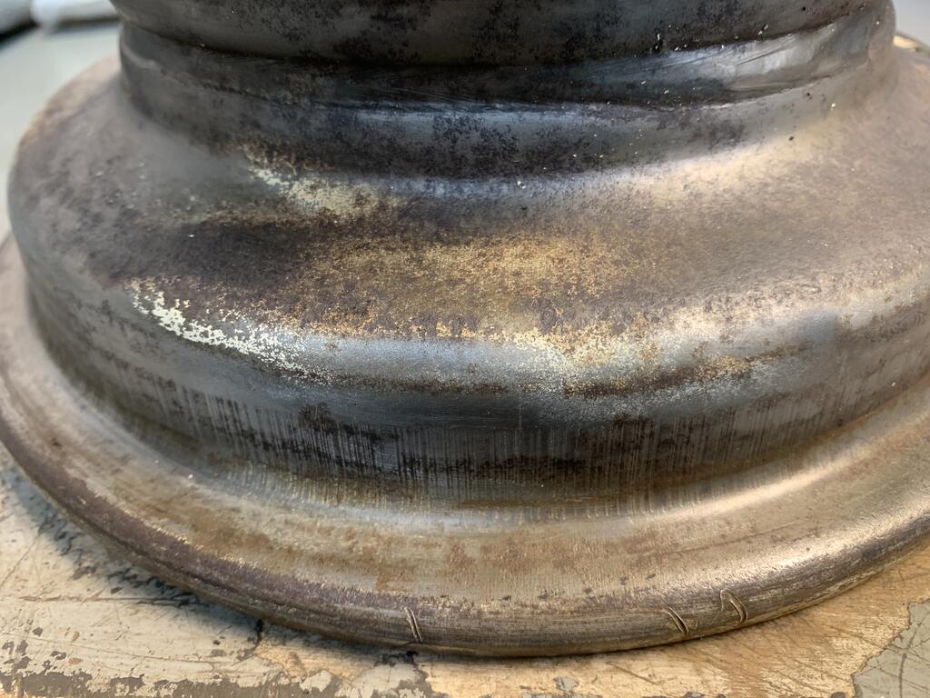

Horse Newbie 7,405 #741 Posted January 30, 2022 (edited) These front rims really give me pause… pitted where the bead seals… I if I fill the pits with PC-7 it would hold up to sandblasting and powder coating ? These may be getting inner tubes. How’s this for an idea… when I get the rims back from powder coating, tape up the rims exempt for the bead area, then apply the PC-7 ? But would the PC-7 hold up to the tire tools on the tire machine when the tires are mounted? Come on fellows… need you input and experience here . Th first 8 pics is the right and the last 8 pics the left… As you can see the right is worse… PO put Fix-a-Flat in the right side I believe, and that was a pain in the butt ! Edited January 30, 2022 by Horse Newbie Share this post Link to post Share on other sites
kpinnc 18,970 #742 Posted January 30, 2022 (edited) 21 minutes ago, Horse Newbie said: These front rims really give me pause… pitted where the bead seals… I if I fill the pits with PC-7 it would hold up to sandblasting and powder coating ? I've got wheels uglier than that that still hold air fine. Especially if you powdercoat them, they should be fine. You can also take them to a tire shop and have them swab the lip of the tires with that sealing goo they use on car tires. I've never found the stuff anywhere but at a tire shop. Basically diluted contact cement. Edited January 30, 2022 by kpinnc 1 1 Share this post Link to post Share on other sites
Jeff-C175 7,211 #743 Posted January 30, 2022 7 minutes ago, kpinnc said: diluted contact cement Not really a cement per se, more like thin gasket sealant. Smells like it anyway. I've got a can in the shop that I bought about ten years ago and used twice. It still looks the same as when I got it. It cleans up readily with denatured alcohol. 1 Share this post Link to post Share on other sites
kpinnc 18,970 #744 Posted January 30, 2022 (edited) 2 minutes ago, Jeff-C175 said: Not really a cement per se, more like thin gasket sealant. Smells like it anyway. I've got a can in the shop that I bought about ten years ago and used twice. It still looks the same as when I got it. It cleans up readily with denatured alcohol. Whatever it is, I'd love to have a quart or three... Lets the tire slip on the bead easily, and dries sticky. I've not had a tire leak down yet when it was used during mounting. Edited January 30, 2022 by kpinnc 2 Share this post Link to post Share on other sites
Jeff-C175 7,211 #745 Posted January 30, 2022 28 minutes ago, kpinnc said: quart or three... A quart will last a lifetime! I wish they sold it in small quantities. But how much call is there for it? Nearly none! 1 Share this post Link to post Share on other sites
Horse Newbie 7,405 #746 Posted January 30, 2022 Thanks @Jeff-C175, and @kpinnc ! That’s why I ask questions that I could seemingly answer myself… 1. I was wondering if anybody had had success with using wheels that were comparative to mine as far as pitting . 2. The mower shop where I have tractor tires mounted probably has some of that bead seal. I have also tried to find it but it seems nobody can get it unless you’re a tire dealer. 2 Share this post Link to post Share on other sites
ebinmaine 80,756 #747 Posted January 30, 2022 1 hour ago, Horse Newbie said: inner tubes I mount our tires here because the tire shops want too much moolah. I install all our tires with tubes because I don't have to be concerned about beads sealing. 3 Share this post Link to post Share on other sites
kpinnc 18,970 #748 Posted January 30, 2022 17 minutes ago, ebinmaine said: I mount our tires here because the tire shops want too much moolah. I install all our tires with tubes because I don't have to be concerned about beads sealing. Tubes up front are fine, but I don't like using them in the back unless I have to. Seems they tend to slip inside rear wheels, and then the valves get all crooked or even broken. I'm guessing because of the lower pressure. Again the "lip seal" goo helps here as well. 2 Share this post Link to post Share on other sites
WHX?? 58,178 #749 Posted January 30, 2022 (edited) 54 minutes ago, Horse Newbie said: I have also tried to find it but it seems nobody can get it unless you’re a tire dealer. Should be able to find it anywhere Newbie.... auto parts places or TSC .... jungle place you'll find it all day. Search tire bead sealer. I'm usually with EB on the tubes tho. I couldn't get these to seat and not leak for love ner money. 6 ply skid steers with sidewalls stiffer than a wedding p. I don't think the tire to rim geometry was right so I just run them flat! Them wounds are definitely honorable. .. pullstart would be proud! Edited January 30, 2022 by WHX?? 2 2 Share this post Link to post Share on other sites
kpinnc 18,970 #750 Posted January 30, 2022 He's right. Dunno why I couldn't find it before... https://shop.advanceautoparts.com/p/xtra-seal-vulcan-cement-14-008/16910029-P 1 Share this post Link to post Share on other sites
