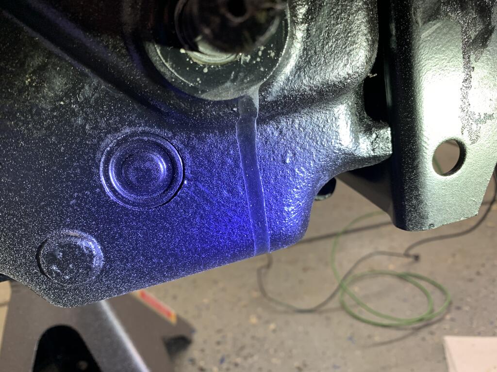

Horse Newbie 7,405 #651 Posted January 23, 2022 Got a little setback… input shaft seal on transmission is leaking ! Dag-nab it! This is the one I muffed up on the first try and had to order another one. Ya’ll know any secrets to this one other than filing the shaft smooth and putting tape over the key way slot ? Is this one a common problem causer ? Share this post Link to post Share on other sites
WHX?? 58,388 #652 Posted January 23, 2022 My Briggs twin had the 12's in it. You can run it for abit with the 19s & will not hurt anything but I would still get a pair of 12's for her. pulls the plugs after some hrs and get the color. Welcome to the wreck the input shaft seal club. Got a feeling it's a big club. I get them by the half dozen and just mash a few right off to be done with it. I wrecked so many on one tranny I finally tried putting in in backward with the lip out with success. So far no leaks. 1 1 Share this post Link to post Share on other sites

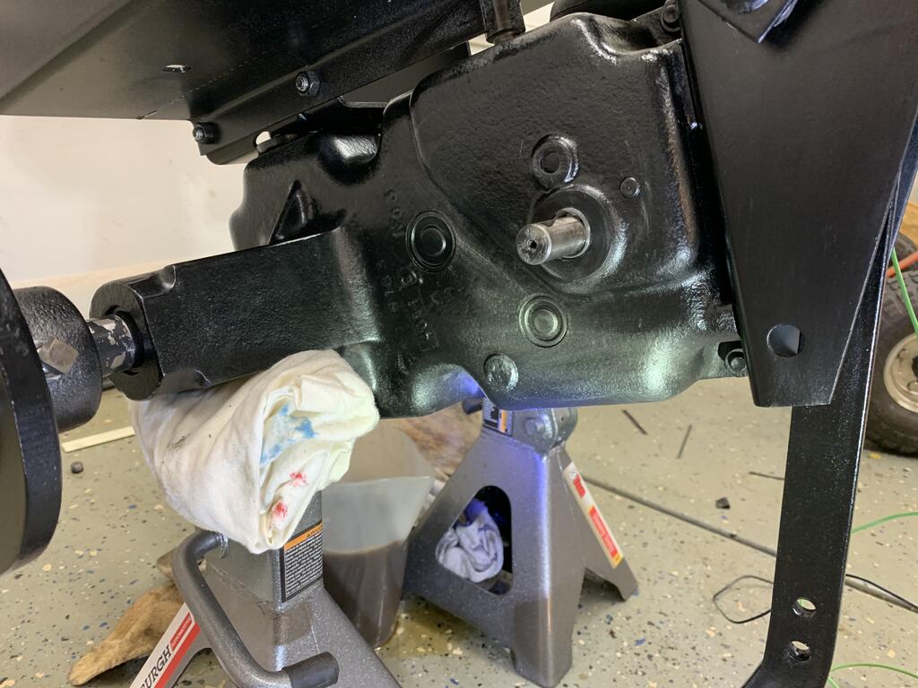

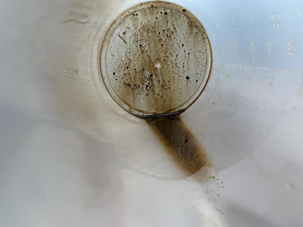

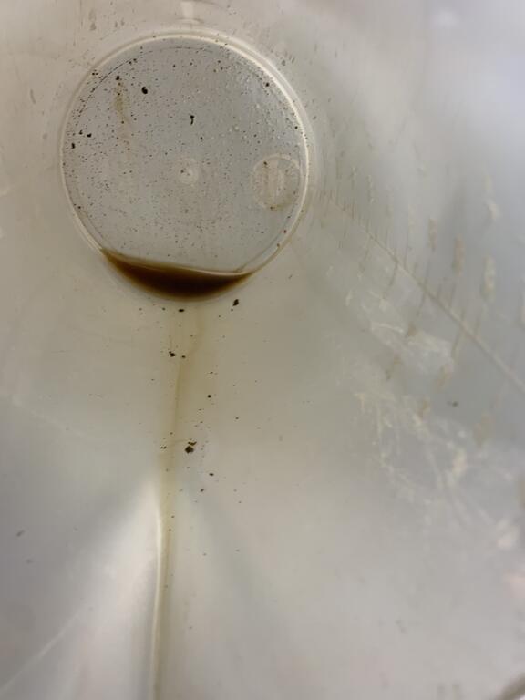

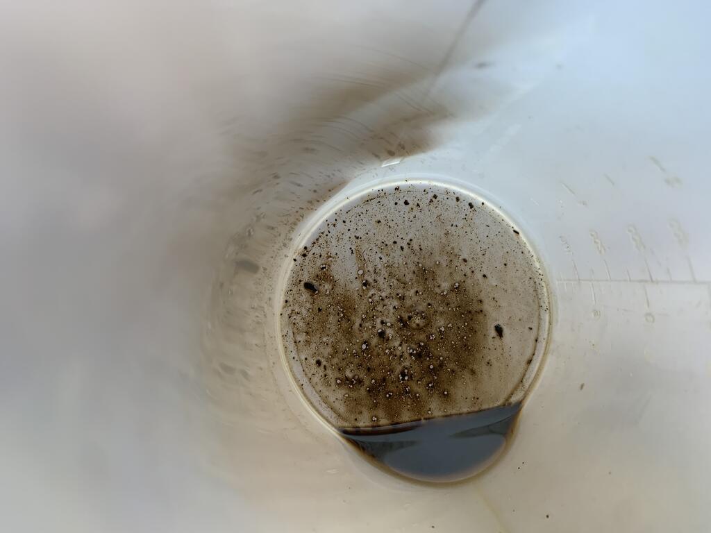

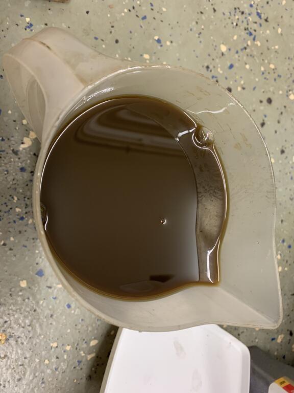

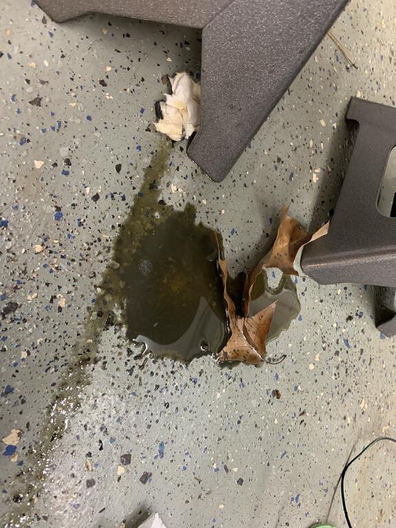

Horse Newbie 7,405 #656 Posted January 23, 2022 (edited) So I decided to go ahead and drain the diesel out of the transmission. I let her run awhile on jack stands through all gears, and the Hi/Lo. I would have preferred to run her around the yard to get it warmer , but that was not in the cards. I will pour the stuff in a clear container, let it settle , and see what comes to the bottom… How far up do you guys jack up the front to drain ? As you can see I am on dangerous ground here… And if a little diesel is left in the transmission in front of the hump, won’t it go to the top when I fill it with heavy gear oil ?… and after that get her warm, and change the transmission oil another time or two… reckon that would be okay ? Edited January 23, 2022 by Horse Newbie 1 Share this post Link to post Share on other sites

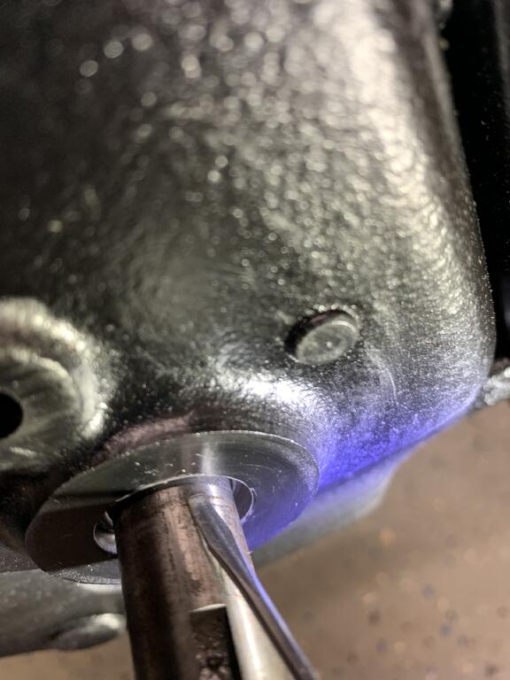

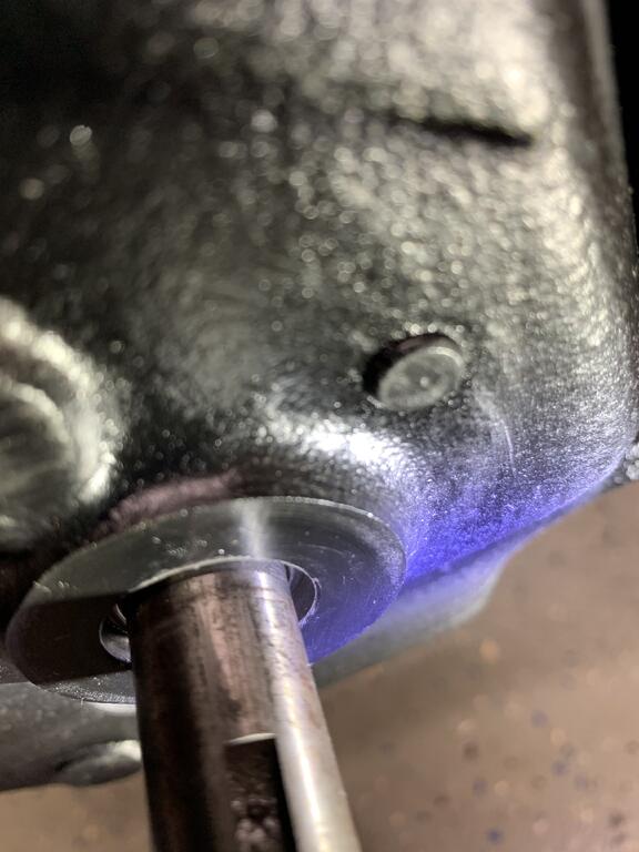

Horse Newbie 7,405 #657 Posted January 23, 2022 (edited) Upon close examination of the input shaft, feeling it with a very small screwdriver, it feels like the shaft is worn a little where the seal rides. Have any of you guys seen this ? I can also feel where the shaft gets a little larger as I slide the screwdriver towards the transmission. I may try to put a new seal in backwards like @WHX?? stated he did above. Or how about putting some RTV or something similar ahead of the seal when I put the new seal in ? What’s you guys thoughts ? At the screwdriver tip is where it feels like the shaft gets larger. Edited January 23, 2022 by Horse Newbie Share this post Link to post Share on other sites
SylvanLakeWH 32,924 #658 Posted January 23, 2022 You’re plenty high in the transmission draining…! yes just fill with oil and run it… little residual won’t hurt anything… 1 1 Share this post Link to post Share on other sites
ebinmaine 81,289 #659 Posted January 23, 2022 8 minutes ago, SylvanLakeWH said: You’re plenty high in the transmission draining…! yes just fill with oil and run it… little residual won’t hurt anything… Agreed. I'm with @WHX?? On the flip the seal method. Can't hurt. Engine sounds good!! 1 1 Share this post Link to post Share on other sites
WHX?? 58,388 #660 Posted January 23, 2022 It went on so much easier and gave the lip a new surface to seal on. A small deep well socket to seat it but start by hand. Use some grease to aid and prevent seal burn till the tranny lube can get to it. Take a little fine emery cloth and shine the shaft up as good as possible where the screwdriver is. . Yah you got diesel in it expect a little leak. 2 1 Share this post Link to post Share on other sites
oliver2-44 11,850 #661 Posted January 23, 2022 (edited) If there’s enough depth you might put 2 seals on the input shaft and flip the outer one. Edit, If that leak was with diesel in in you might not really have a problem. Most of the seals leaked with diesel on my C81. I put 80w-40 gear oil and no transmission leak. Engines another story. Edited January 23, 2022 by oliver2-44 2 1 Share this post Link to post Share on other sites
WHX?? 58,388 #662 Posted January 23, 2022 5 minutes ago, oliver2-44 said: If there’s enough depth you might put 2 seals on the input shaft and flip the outer one. Edit, If that leak was with diesel in in you might not really have a problem. Most of the seals leaked with diesel on my C81. Come to think of it one I peeled apart might have had two of them. I think it was Lowell told me once he uses two....CRS. 1 Share this post Link to post Share on other sites
kpinnc 19,107 #663 Posted January 24, 2022 90 weight gear oil won't seep nearly as much as diesel mix. I would flip the seal and see how it goes. On level ground, the input shaft seal is just below where the "full line" is on that transmission. Any leakage should be minimal. I have one transmission that the pulley got pushed into the seal, and it wallowed out the case so that I can't even install a seal. 1 Share this post Link to post Share on other sites
