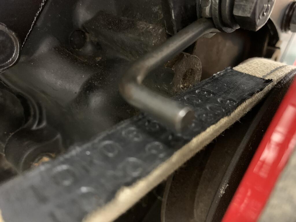

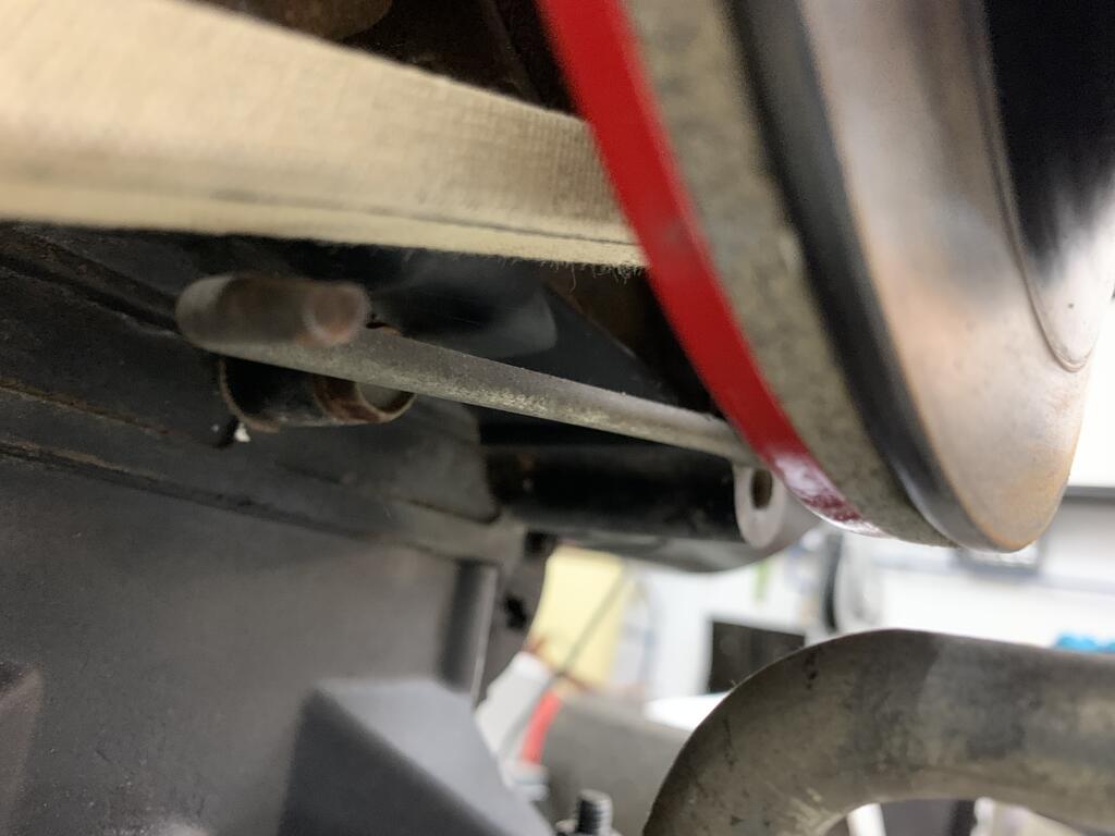

Horse Newbie 7,405 #622 Posted January 22, 2022 Out here working on the Work Horse… Concerning these belt keepers at the engine… Note the belt is on and the clutch is released as it would be under normal operation… Is this when you position the keepers ? If you look at the bottom side keeper it looks about right, how about the top side keeper ? 1 Share this post Link to post Share on other sites
Handy Don 17,739 #623 Posted January 22, 2022 Those look ok to me. I aim for about ½" clearance and always check to make sure that no sharp edges will hit the belt when it "bounces" and hits a keeper. 1 Share this post Link to post Share on other sites
wallfish 20,744 #624 Posted January 22, 2022 Looks good. They should be positioned about 1/8" away from the belt edge with the belt tight and the clutch engaged like you have it. Test with the engine running and the belt should release from the engine pulley when the clutch pedal is pushed. Some fine adjust may be necessary if it doesn't completely release. 1 1 Share this post Link to post Share on other sites
Horse Newbie 7,405 #625 Posted January 22, 2022 58 minutes ago, Handy Don said: Those look ok to me. I aim for about ½" clearance and always check to make sure that no sharp edges will hit the belt when it "bounces" and hits a keeper. They have a little wear on the keepers… not much, just somewhat of a flat spot . 2 Share this post Link to post Share on other sites
